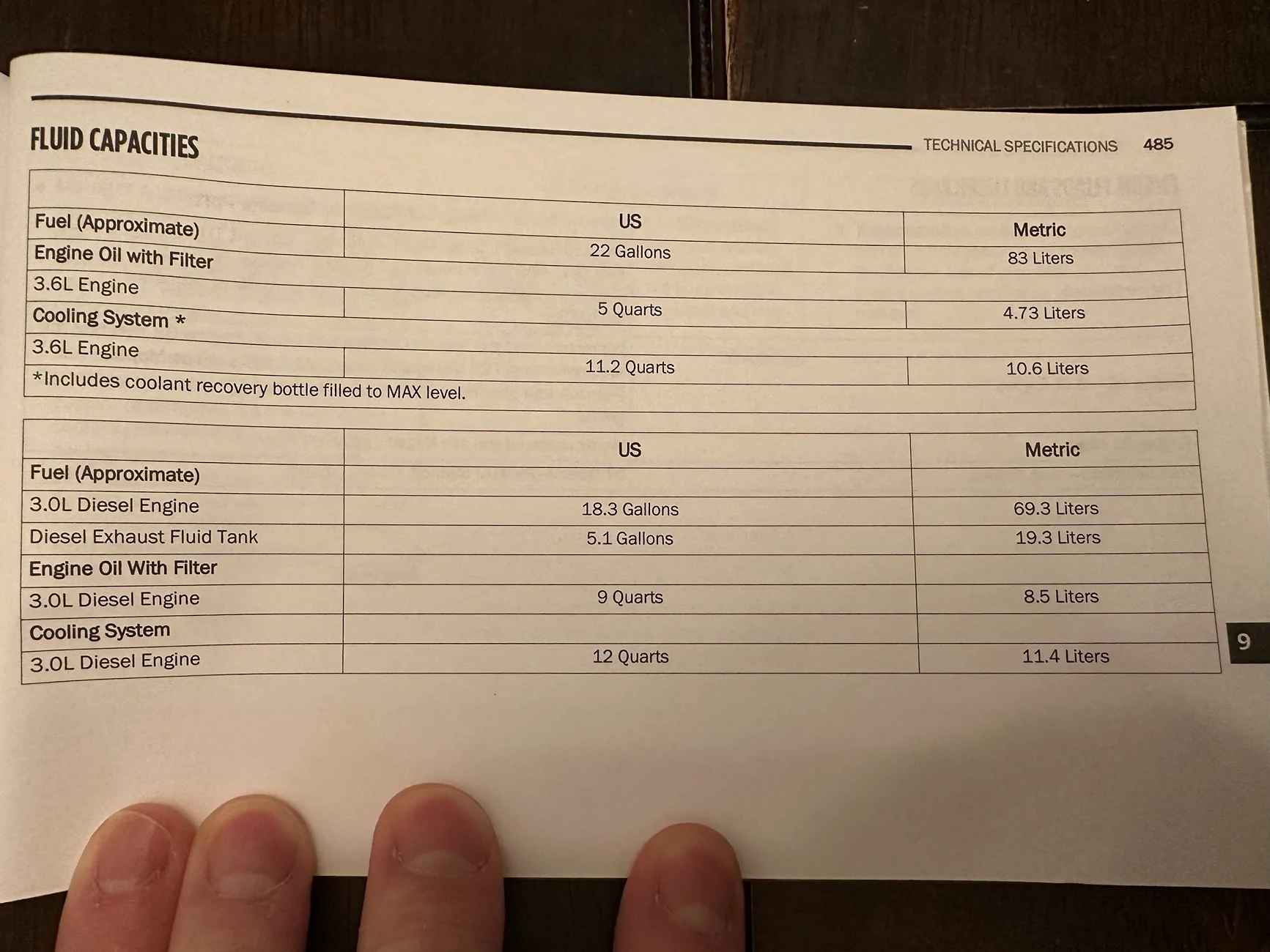

Found your problem -
(it’s from the owner’s manual)
Mine says differently. You made me have to go double check what I had seen. I guess when it says “approximate” they meant it. 😂
Mine says 19 gallon too.

My build sheet says 19 gallon fuel tank and I usually have to fill arround 16,5.
This is shortly before the fuel warning lights up.
I must have filled it right before the low fuel warning came on. Good to know.

Its a 19gal tank. Right at 30 miles of range left, or 1/8th os a tank. I fill up 16-ish gallons. The most of squeezed in was just a smidge over 18 gal.
