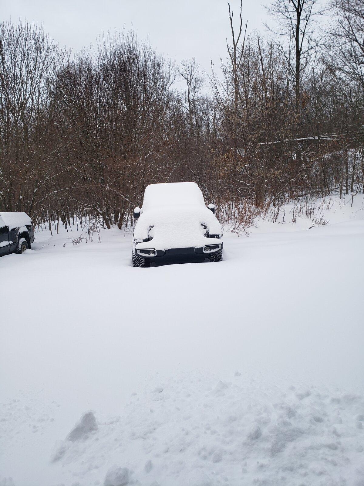

Just had my gladiator sport s out in 14 inches of snow it handled very well. having a lot of fun driving around my town till a cop pulled beside and told me to go home!
