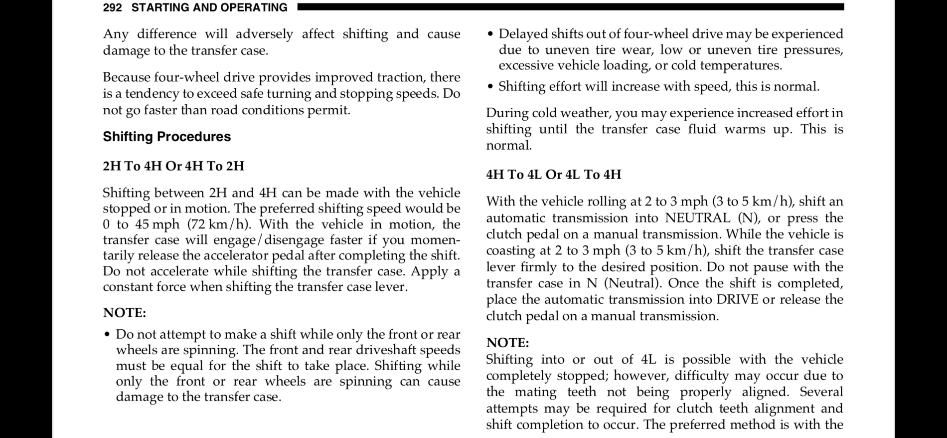

Does that mean in 4H you can go faster than the 45mph? I have had my my Gladiator for over a year and have gone to 4H 3 times and all of the times I was under 40mph, because I really didn't need to be in 4H.
I drive a certain gravel n dirt road just to engage the 4WD (4Hi) for a few miles. I might get up to 45 MPH on it just to wear it in and to cycle T-case and front axle disconnect. I've driven a few of my Jeeps in 4Hi at 55 mph or more not long distance... Well maybe a hundred miles or so say from Bloomington IL. south to Mt. Vernon IL. in winter storms ;) one of them was "more fun" locker in front axle and Trac-Loc in rear. Interesting on ice. :giggle:

And I've shifted into/out of 2H-4H at over 45mph, and didn't have any trouble or bad noises.
If it's a matter of shifting at 45, or losing control when hitting an unexpected slick spot on the freeway, I'm shifting the darn thing!
