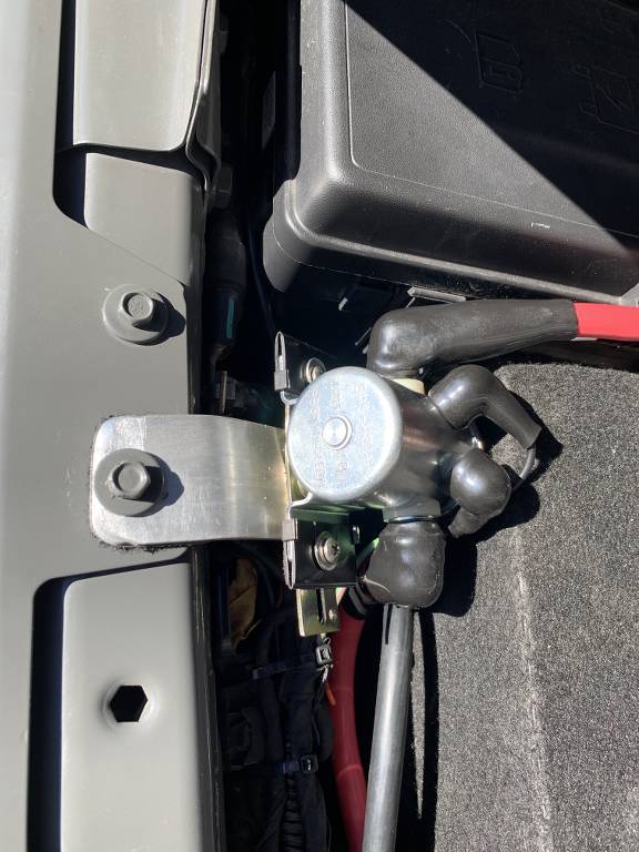

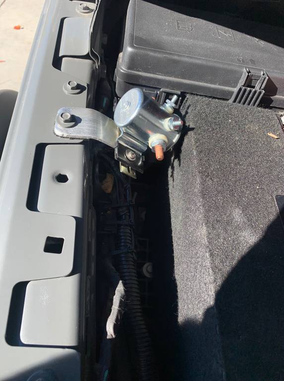

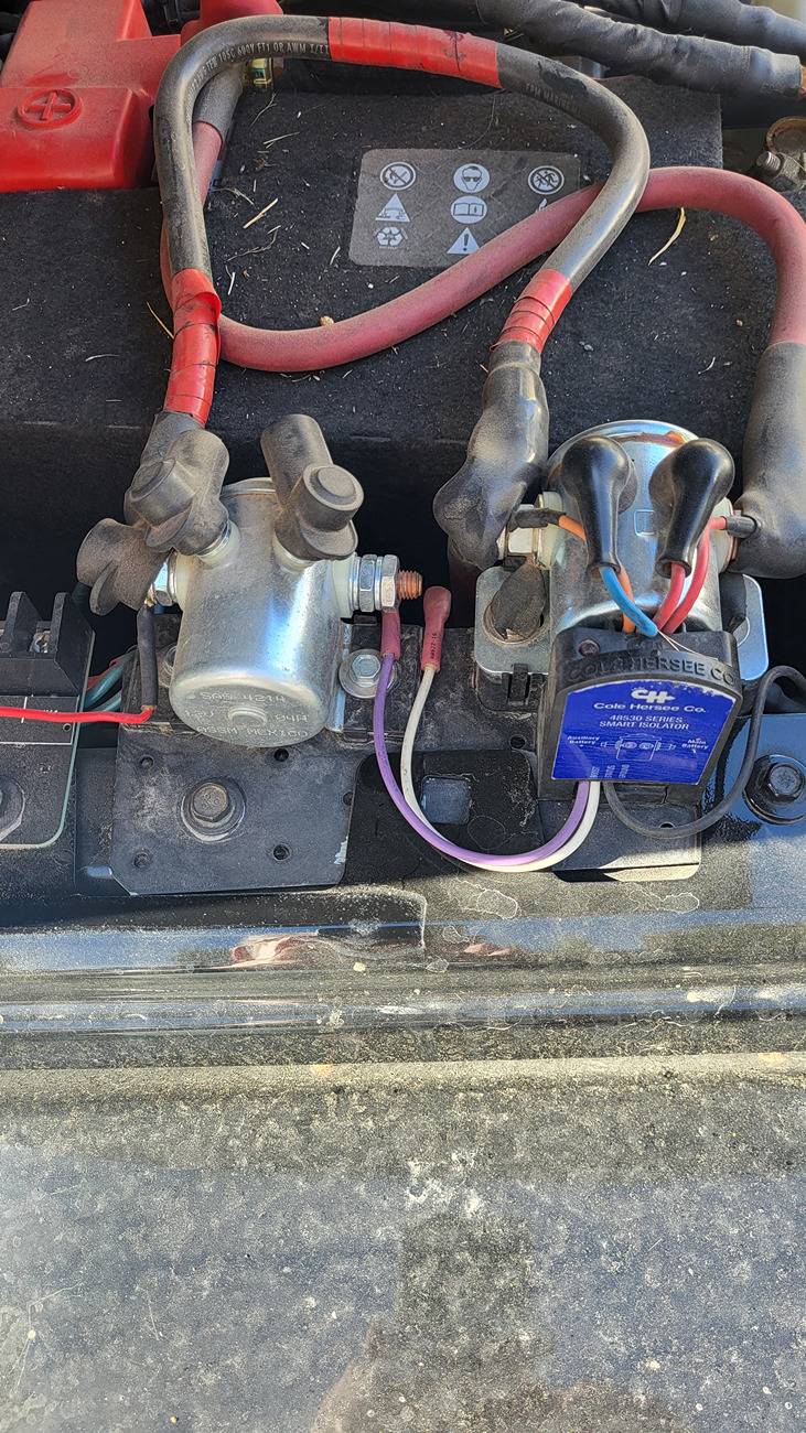

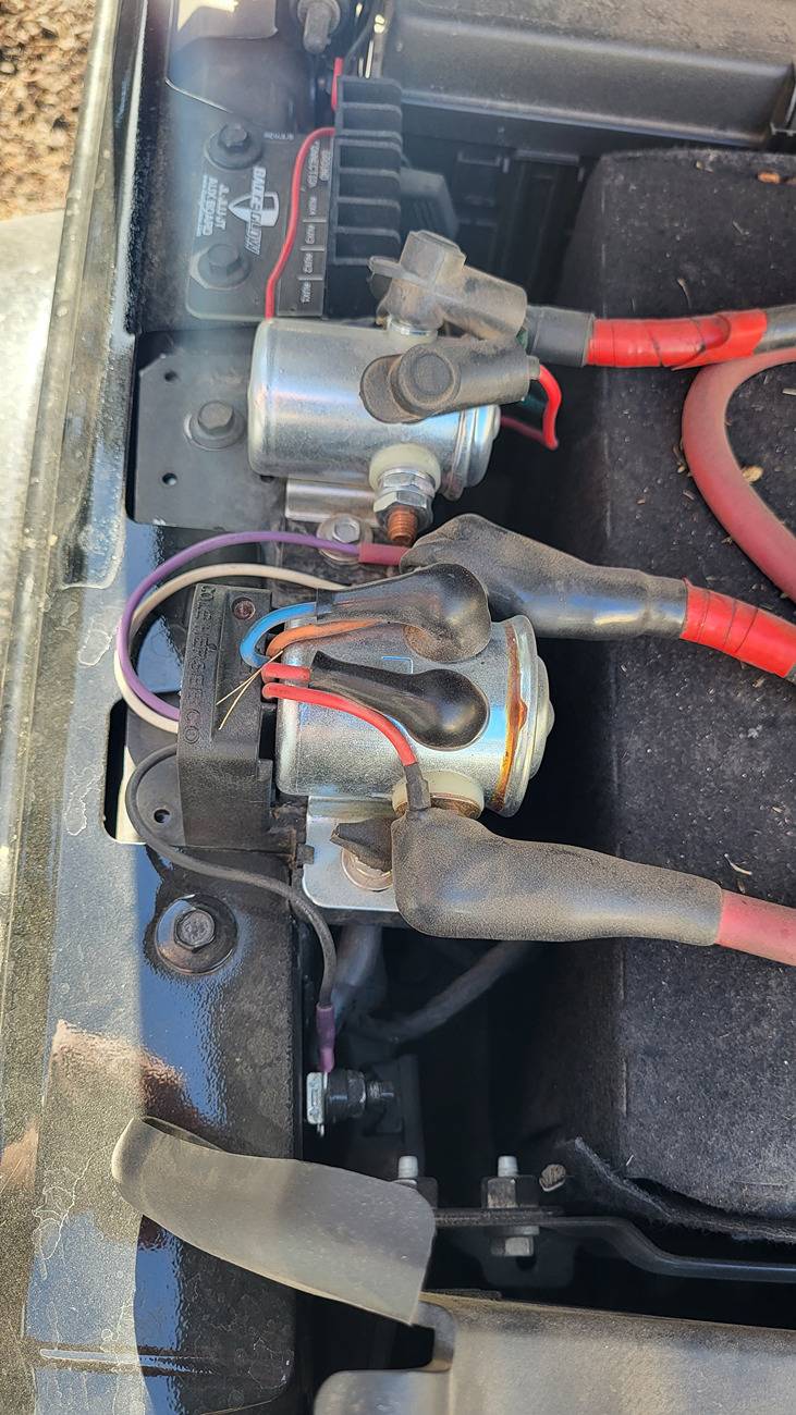

So which solenoid is a suitable choice? I see the Warn 72631 is used with the VR10000 but I don’t see a black solenoid in any of the pics in this thread.
The silver Warn solenoid I see is for smaller winches.
I use the warn solenoid on my Apex 12000 and it's fine. Remember DUTY cycles. Winches have duty cycles, but too many hold that button down until the rig is freed up. That's what kills things.
Of course, with the line out, I'm not really putting that much load on that winch, so that matters, too. A bigger winch typically uses the max amperage at max load. If you use a 12,000 and are only pulling 8,000 on the line, it's not going to max it out. And you don't hold the button on the winch for 2 full solid minutes unless you don't like the winch and want a reason to replace it or your batteries or alternator.
