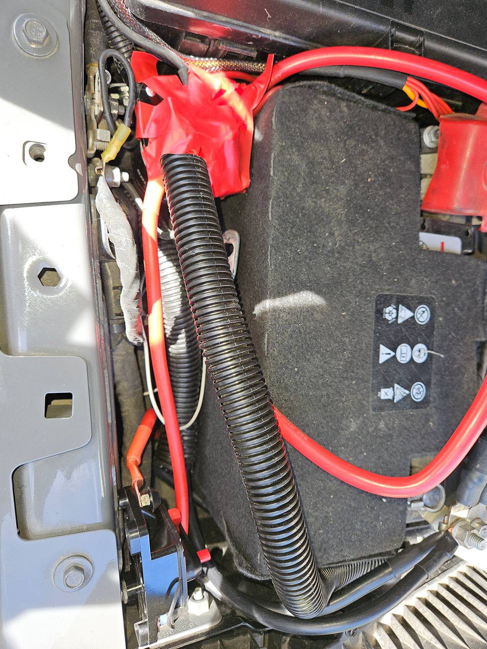

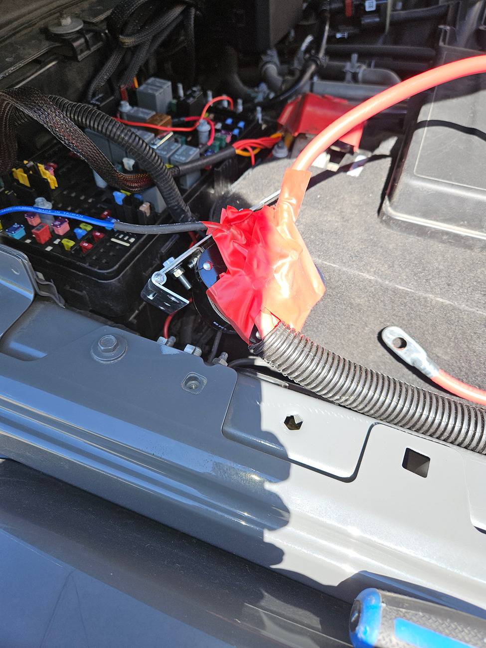

I've got a 500 amp solenoid for my winch. I want to wire it in near the battery, but seem to be lacking room. Has anyone got a description/pictures of what they have done? I've been trying to figure out a nice install and am a bit stumped.

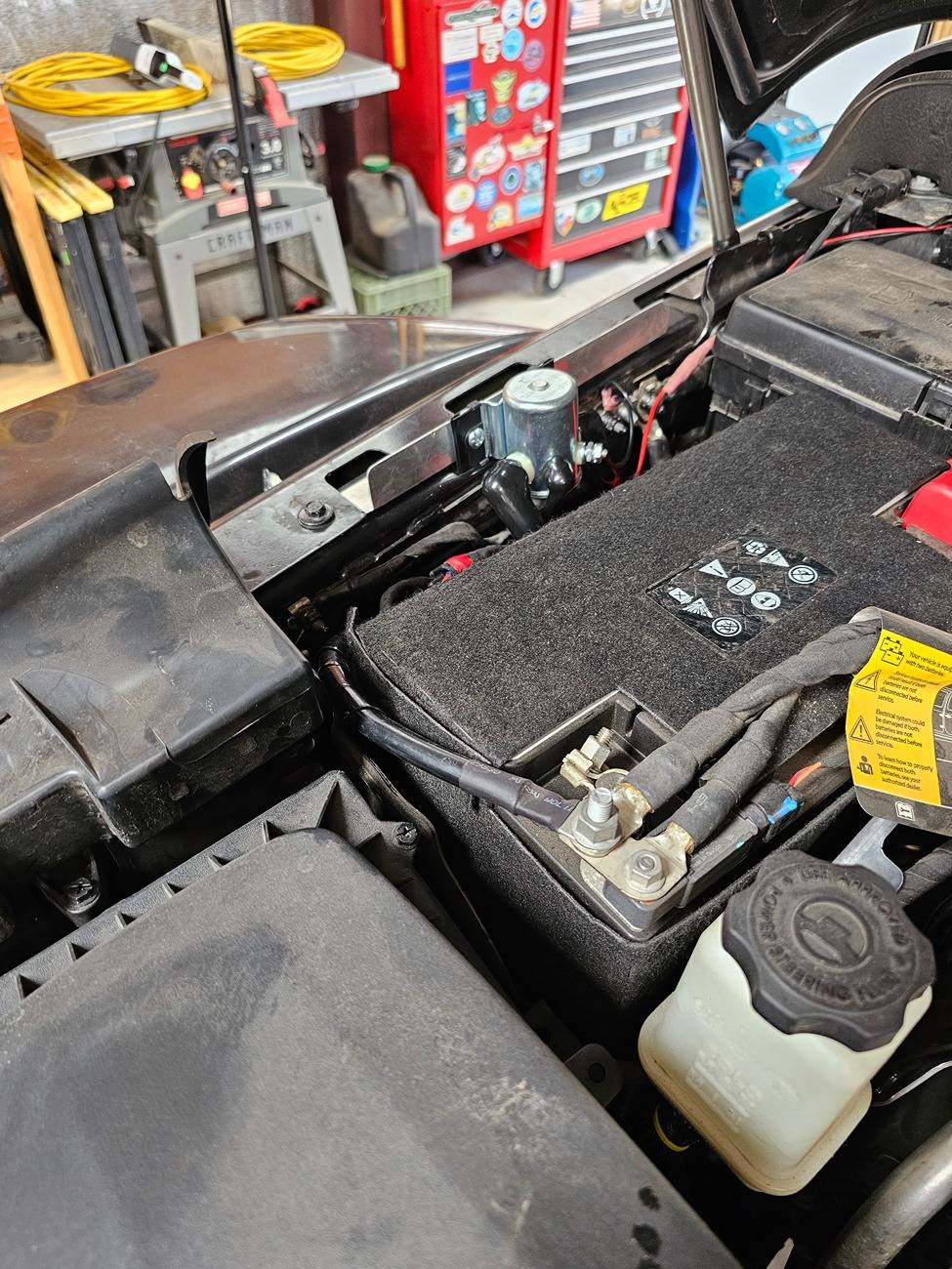

First pic is the hinge I used. Kinda like it in the end. Second is with the circuit breaker for the 56 ga wire going to the bed. Both the winch and that feed are off the solenoid, so I can leave them turned off most of the time and only on when I want to winch or air up. I re-wired my compressor with an Anderson connector that now plugs into the bed where the knockout is.
Happy with the results, just not the 3 hours it took to run the 6 G1 and finish up. Definitely am older than I used to be.

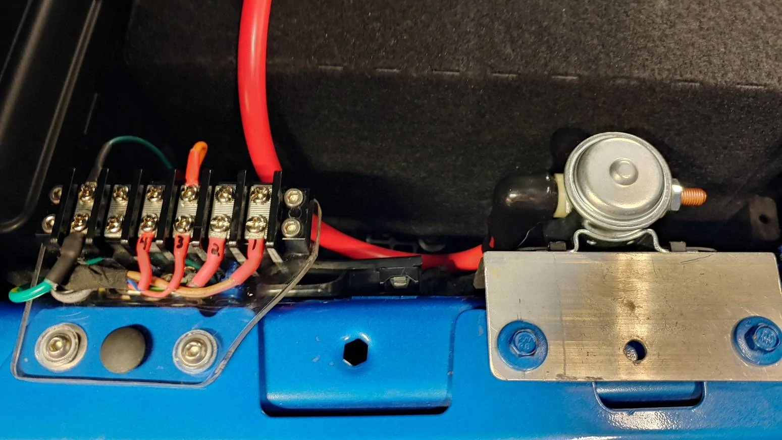

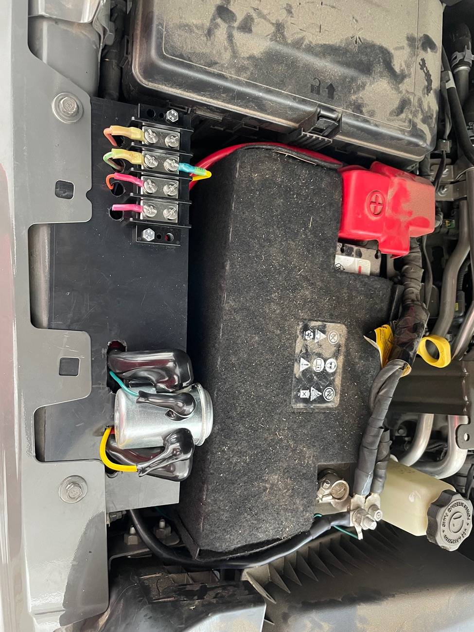

Here’s my less than beautiful DIY attempt at simplifying the winch solenoid and aux switch wiring. I used 1/8” ABS board and a Blue Sea terminal block. No issues since installation a year ago.
Looks good to me.

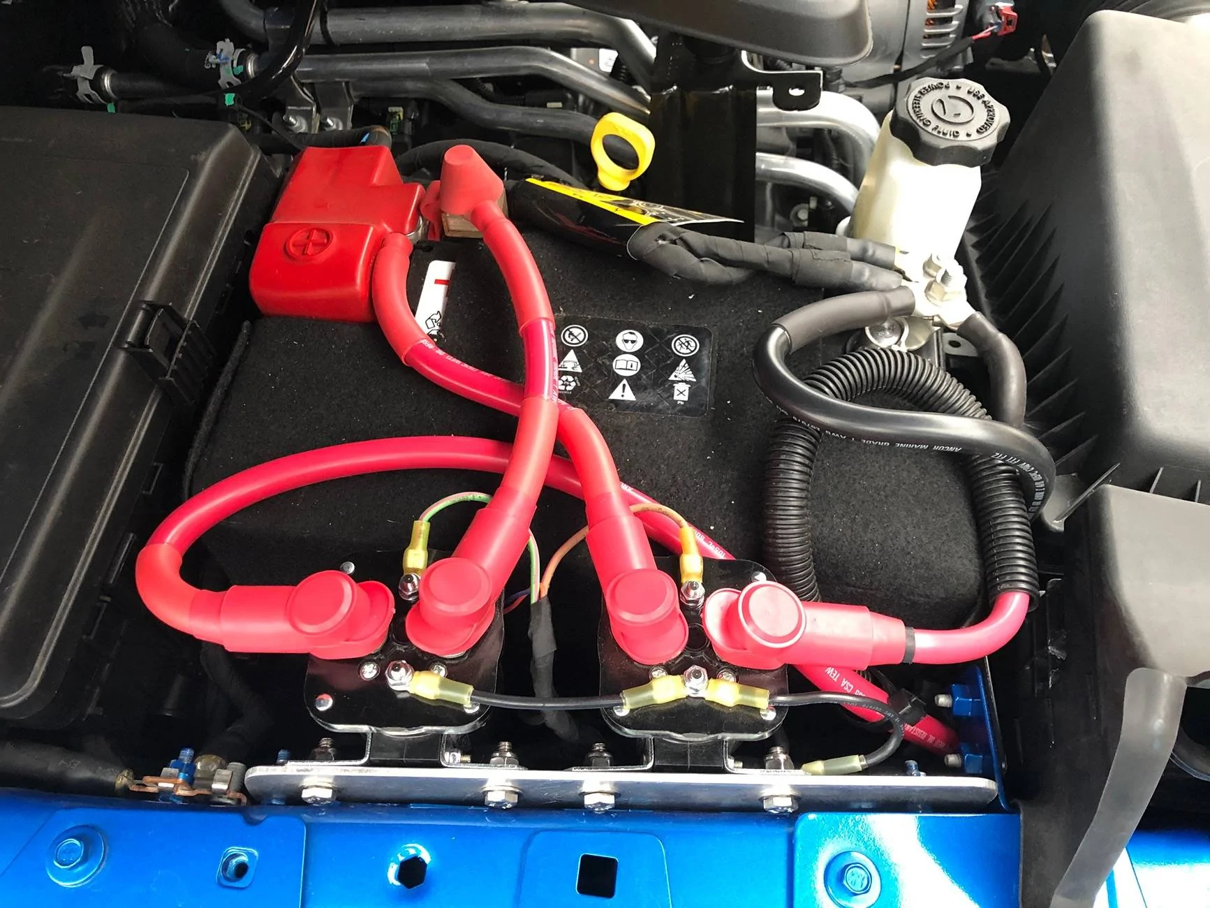

I started with the manual disconnect that came with my winch:
Jeep Gladiator How to fit a winch solenoid by the battery? 20201017_135923_HDR

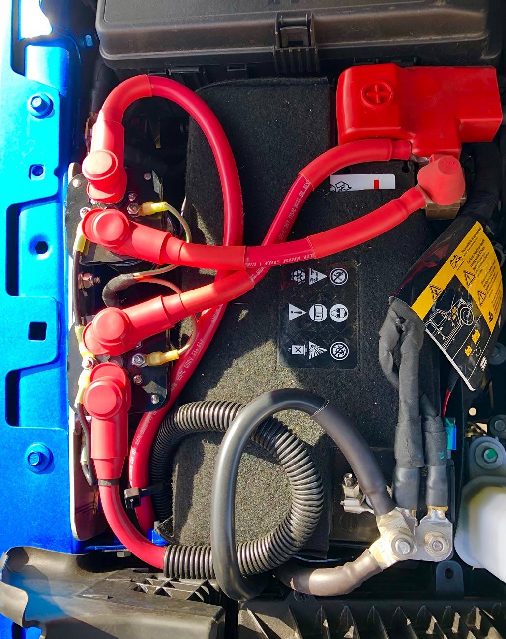

Then for my 2022 - I did not use that manual winch disconnect switch, I used a solenoid like they are talking about here, to replace that manual switch -
Jeep Gladiator How to fit a winch solenoid by the battery? 20220720_114419_HDR
