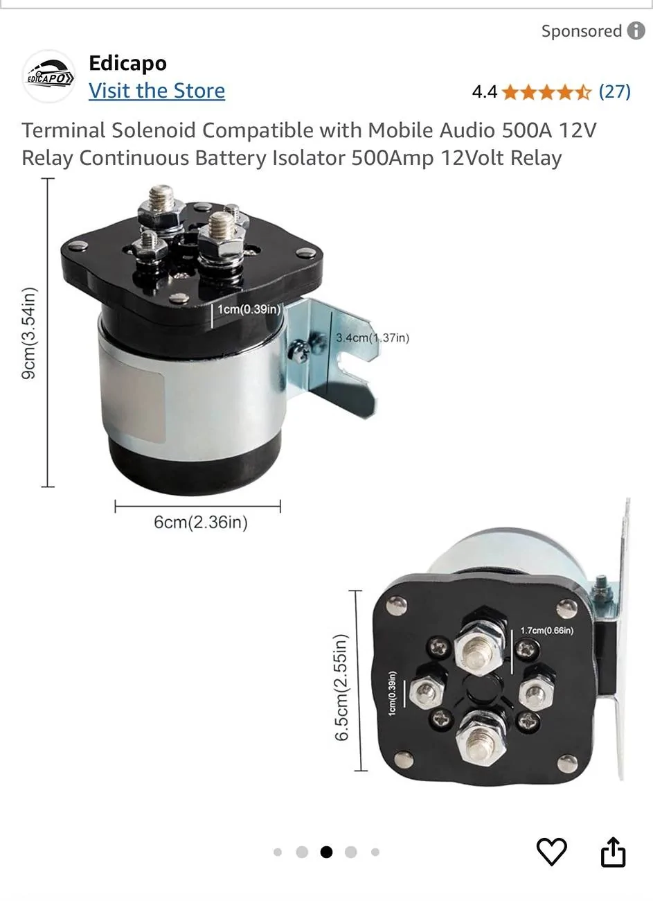

Yes. I have a switch in the truck that I can turn on and off the power to my winch (and bed power the way mine is wired) instead of having to open the hood. It's a 500 amp solenoid, so plenty of capability.
That, and the fact that winches have a duty cycle - you don't run them continuously or you over-heat them. Unless you push the winch beyond recommended limits, you aren't pushing the solenoid, either.

Another example.
Terminal Solenoid Compatible with Mobile Audio 500A 12V Relay Continuous Battery Isolator 500Amp 12Volt Relay

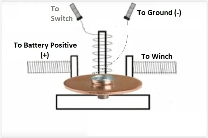

You have a large gauge hot wire from the winch that connects to one of the large terminals on the solenoid. The winch ground cable grounds to the vehicle with the recommended location being the battery negative terminal. The other large terminal on the solenoid has the same gauge cable connected to the battery positive connection. The hot wire from the auxiliary switches connects to the small positive terminal on the solenoid and the small negative terminal connects a small ground wire to the vehicle ground.
With the auxiliary power to the solenoid turned off the power to the winch is disconnected and when power is supplied to the solenoid the connection is made for the winch hot wire.

The solenoid is low power and is turned on and off with the switch on the dash. It sits on the winch power cable to turn the winch power supply off and on. With the solenoid (disconnect) the power from the battery is stopped at the disconnect until you turn it on and then the power runs through the disconnect and is supplied to the winch.

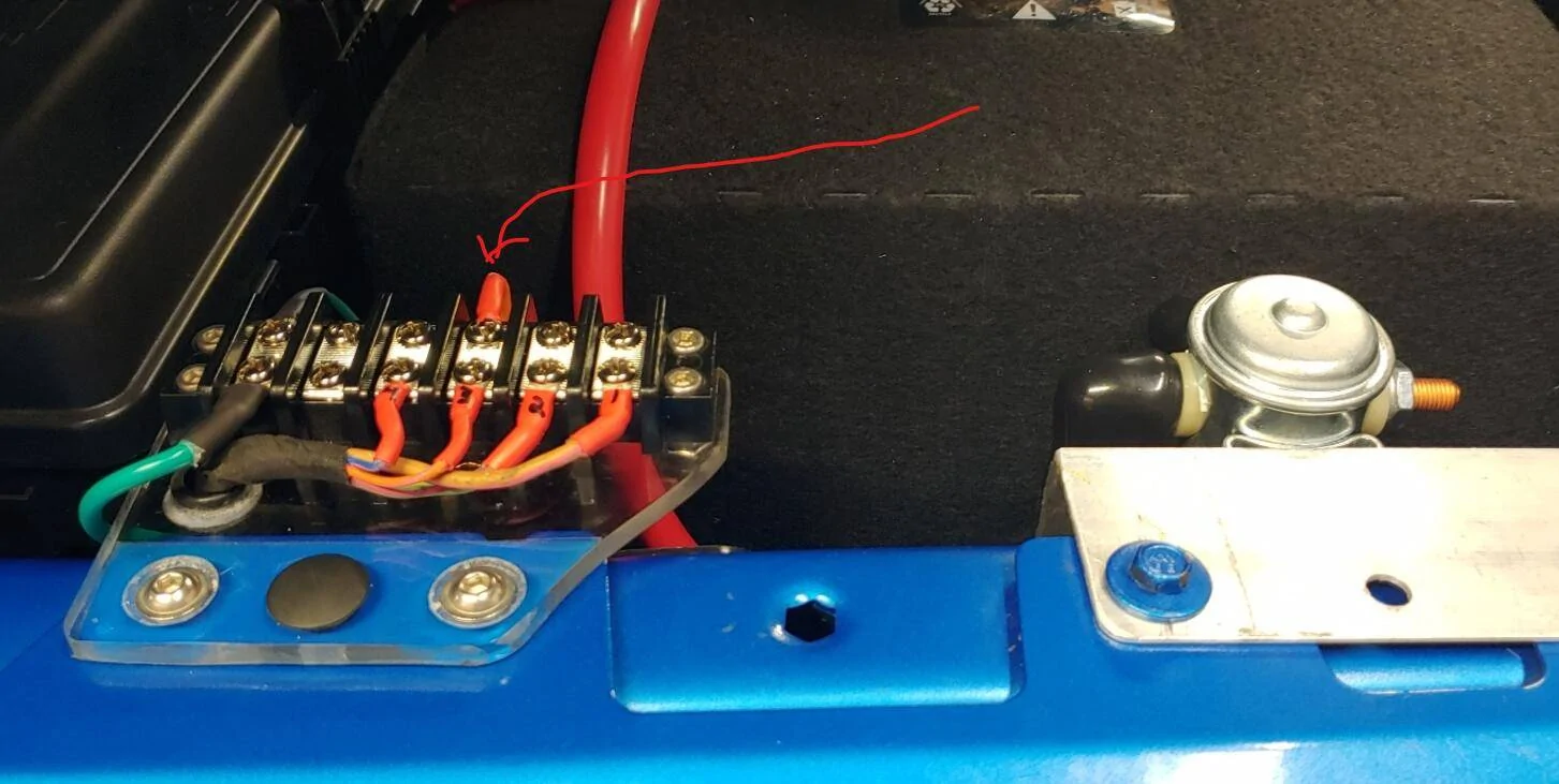

In this pic, the unsteady red arrow points to the wire that runs from #3 aux switch over to the solenoid. My aux switch wires from the factory are laid in this terminal strip. I could then wire in any accessory easily with this type of strip.
I have numbered my aux switch wires on the strip for easy ID.
The green wire is a ground I ran up there for easy access so I can ground small items up there and not mess with the body ground studs.

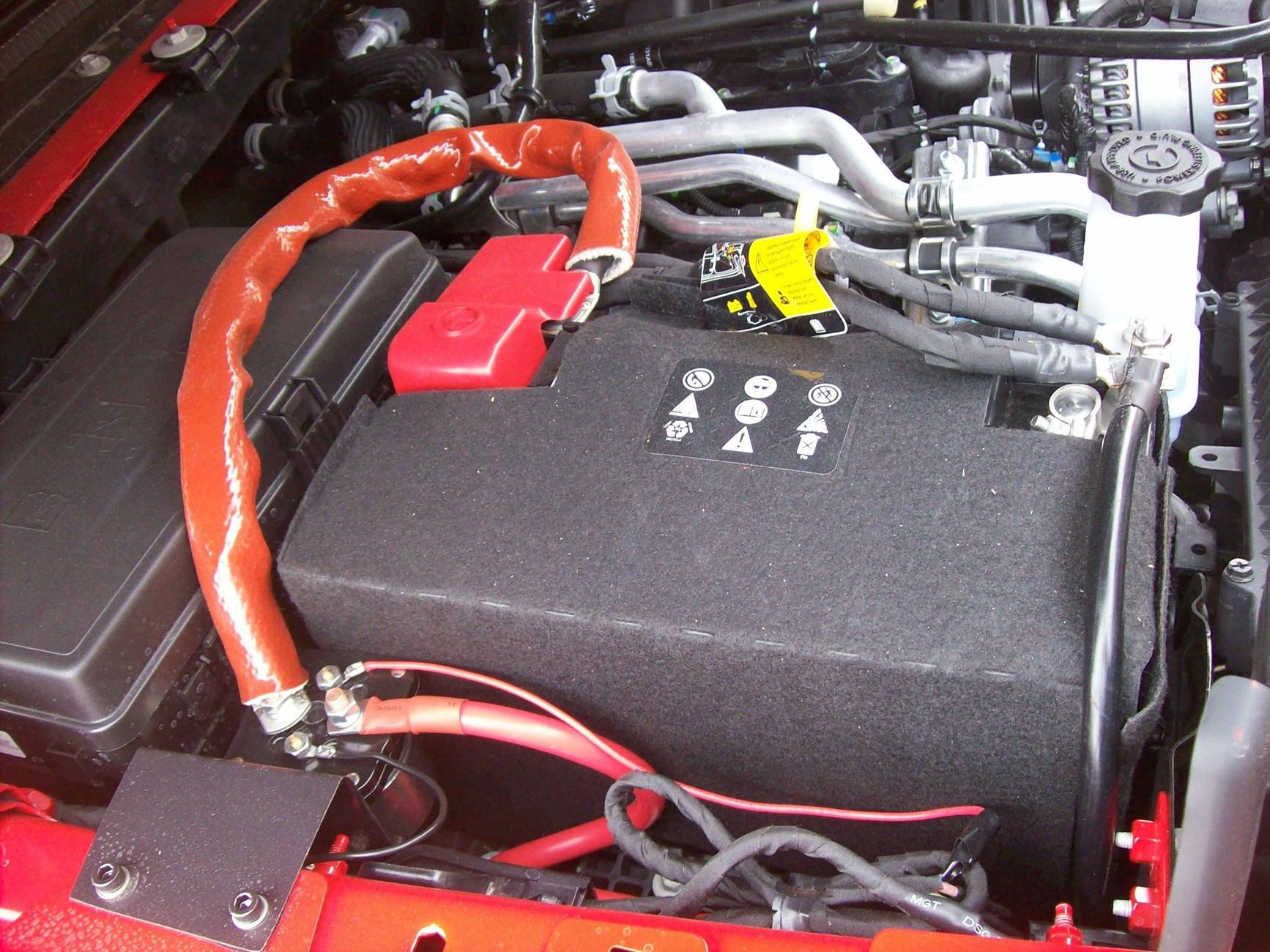

I am using the positive cable disconnect switch that came with the winch....
Jeep Gladiator How to fit a winch solenoid by the battery? JG-W1

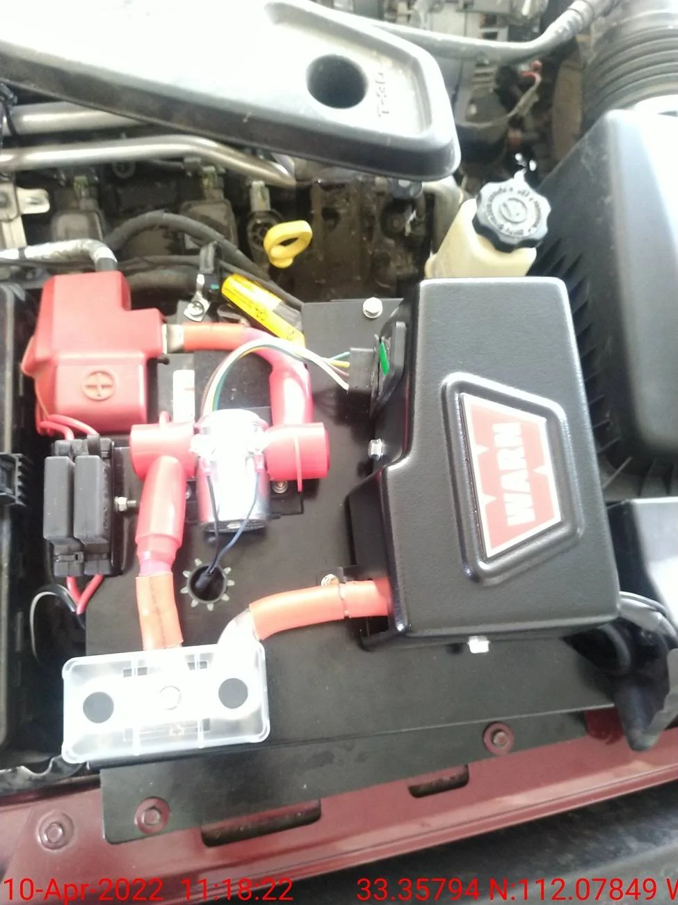

Relocated winch controller, isolation relay controlled by aux switch and terminal strip used for winch and jumper plug, picture is not latest configuration
Jeep Gladiator How to fit a winch solenoid by the battery? IMG_20220410_111822

Solenoid below - there's a plate attached to an iron rod that is pulled into the coil when the coil is energized. The plate comes down across the contacts as shown.
