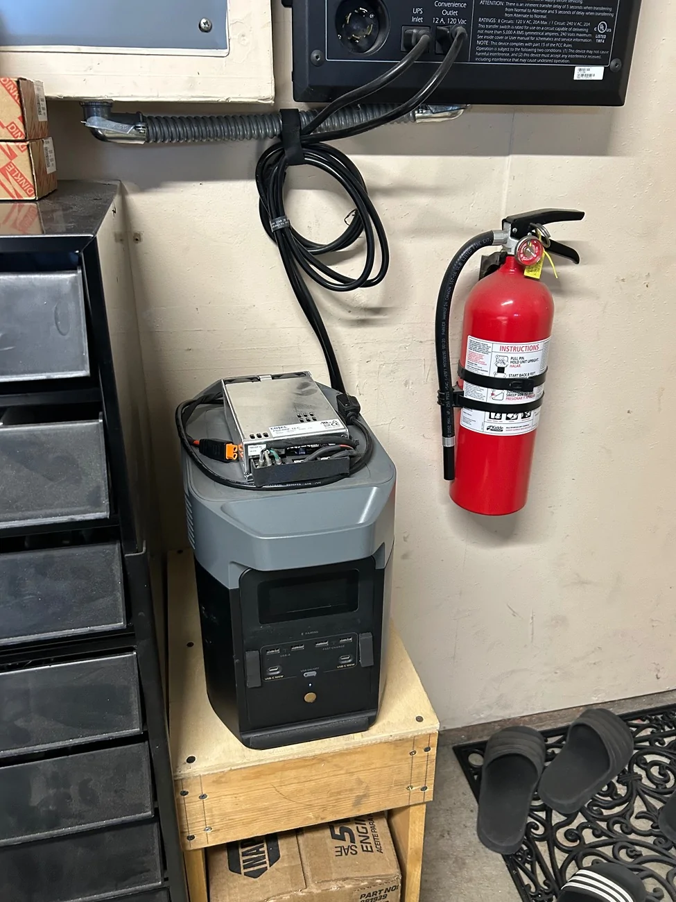

The converter is required due to the bed 120v outlet being a modified sine wave, Ecoflow won’t accept it directly. Heat won’t be an issue here with a converter.
It’s a super simple setup with a small converter velcro sitting on top of the ecoflow. Connect ac plug to the bed outlet and the xt60 connector into the solar port of the Ecoflow. I can turn it on/off with a button that’s already inside the cab. Once done with camping, i use the power station as a UPS backup for the home.

Pardon my ignorance then, I thought the Ecoflows could handle a 12v DC input and that was always better than trying to run it off the inverter even at lower amperage?
It does allow DC charging, but only at 200w max. DC to DC charging is great if one doesn’t already have the bed outlet.
I like keeping things stupid simple as possible and saves the complicated stuffs for work lol. Here’s an Ecoflow serving as a UPS via an auto transfer switch at home. Connect that 5-15p power cord from converter to the bed outlet and get 200w charging while driving.
No offense, but that might seem super simple to you being an electrical foreman, but to others it may sound complicated. Now Iyou're telling people to go buy another device to charge their Ecoflow? And it has to be a certain size. And you have to turn on your vehicles inverter in order to use it.
