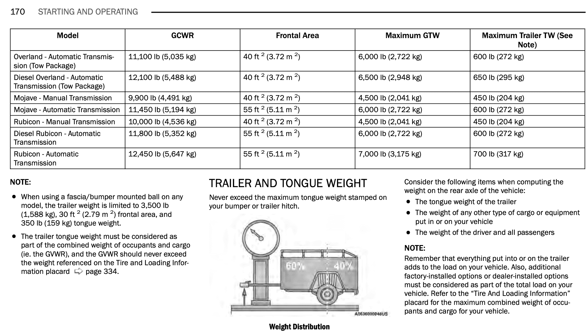

Towing with a JT isn't rocket science. It IS science, however. Set your full rig up properly and carefully. Be circumspect in what you carry/pack/tow, but towing a 5k lbs trailer with your family and necessities with a JT isn't a doomsday scenario. Be judicious in your packing and loading. Don't carry more than you need to. Make sure you have a weight distributing/anti-sway hitch that's set up properly, a brake controller, proper towing mirrors, and load the trailer properly. You'll be fine. The JT isn't a 3/4 ton truck, but neither is it as incompetent a towing vehicle as the numbers might lead you to believe.
You'll find all of the towing/weights information in your owner's manual pp 166-171 (at least that's the page numbers for my 2022 Overland.)

Seems this keeps coming up every week............ and yet all of the stuff is in the freakin book.
No one checks this stuff out, buys a truck, then wants to tow a trailer and then complains the truck isn't capable enough.
Payload is on the door sticker.
ANY THING, any person, any object, accessory whatever, comes off that number.
If your family dog weighs 100 pounds and goes with you, subtract 100 from that number.
Trailer TONGUE WEIGHT is what goes against that number, so if that's 500, take that from the number.
If you have added stuff to the bed, subtract that.
If your beer cooler is 100 pounds, subtract that if it's in the truck somewhere.
It's really simple, it's math, it's not complex and Jeep, Ford, GMC and Dodge/RAM have made it stupid simple with that door sticker and the book.
Sorry, but I don't see how it gets so very complicated.

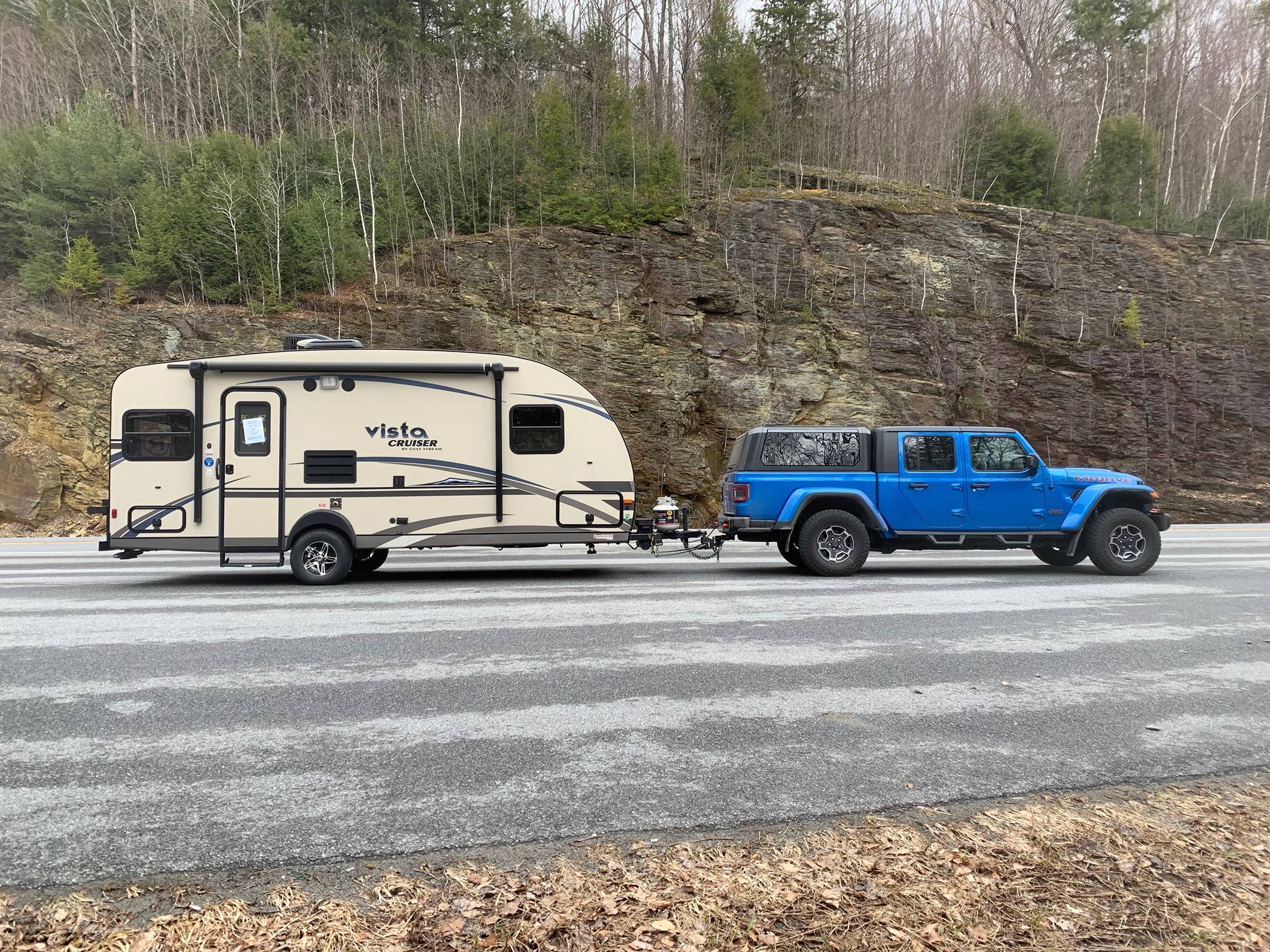

Which camper?
Gulfstream Vista Pro 19ERD!
No bump out either, bump outs add weight , tandem axles add weight, I am surprised how well it tows with a single axle…..Jack
Jeep Gladiator I’m having trouble with payload for a RV, help? IMG_0983
40,465
53,921
Yeah, they add weight, but superior towing, IMO. I'd never own a single axle camper again. But then, in my case, I'll probably never own another camper of any sort anyway. Too far beyond that, my cares and interests are in the other things to see and do now. So what I think doesn't really matter then, does it? LOL.
A good, level setup, good packing, good weight distribution on the rig, and a good hitch - that's probably why you have a good ride. The owner is part of the equation.

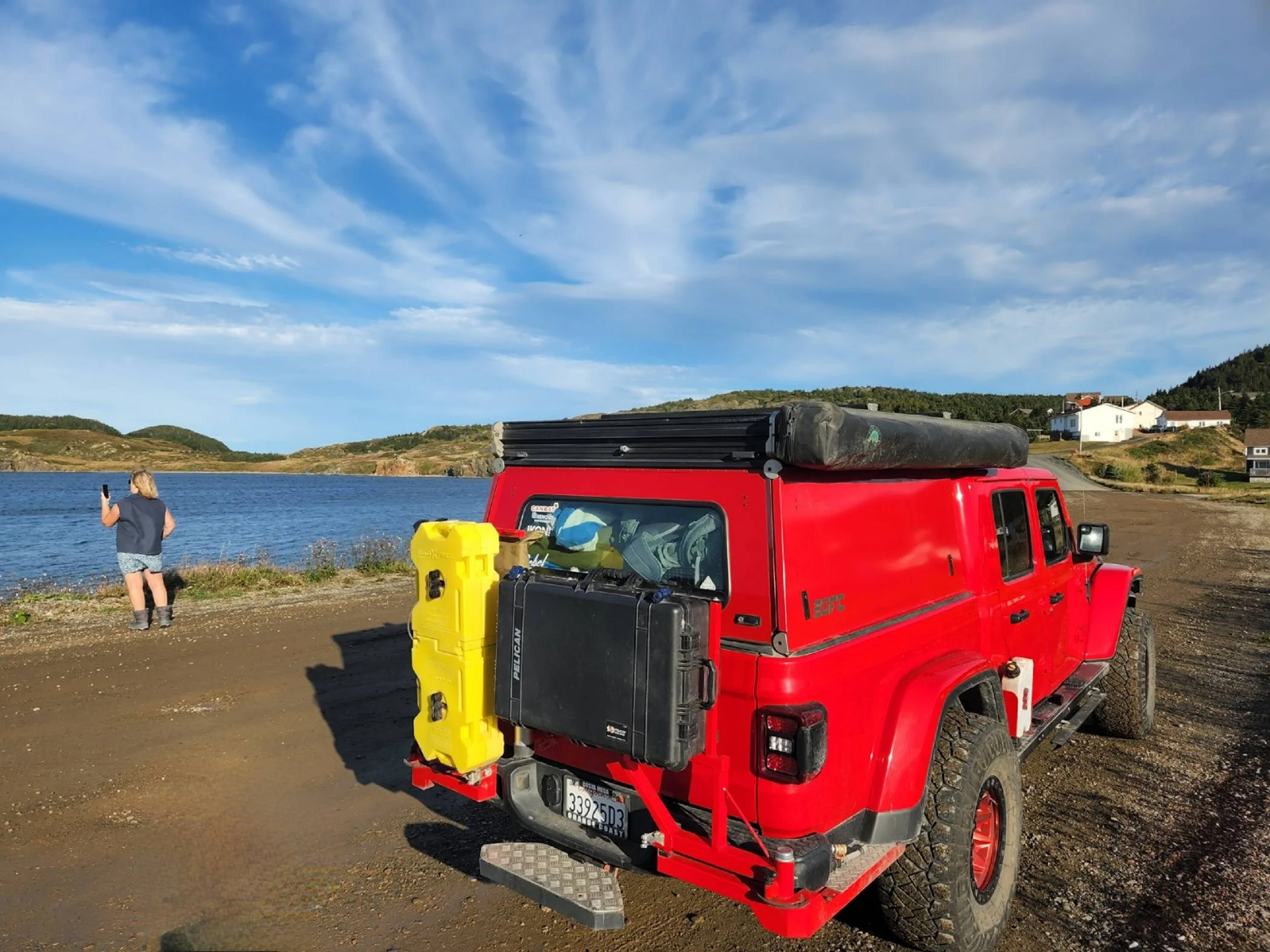

I was going by the GVWR and keeping it under 5k lbs but now people are telling me my payload on my Rubicon (1126 on door) it’s too low to tow anything but a pop up;(
Family of 4 com
Jeep Gladiator I’m having trouble with payload for a RV, help? 20220923_085548
bined weight 500 and what all do I have to add up from here?
We put the AEV heavy diesel springs and it carries the weight fine. We weigh in at 6200
