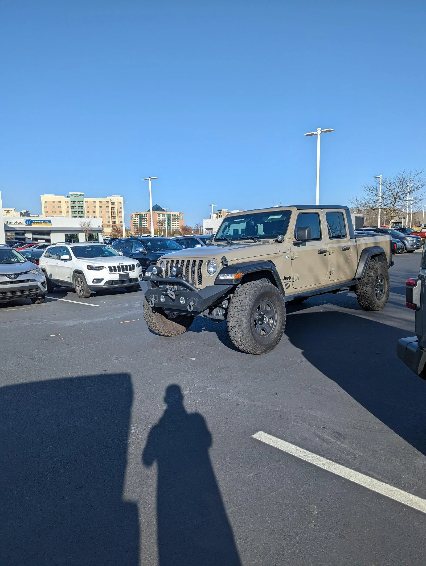

I'm just on the fence on why not just 4.56. I've only been under 17 Mpgs on the colder mornings when it gets below 30 and that was only dropping the Mpgs to 16.8. Only twice it has gotten down that low and within a day or so I was able to get it back over 17. I feel like 4.56 would be the sweet spot with 8spd auto if your not planning on towing and stay with a lighter 37. Mine weigh 72lbs. This is how it's sitting currently
Jeep Gladiator I was in denial but after driving up to Sacramento... PXL_20211225_194447821.MP
