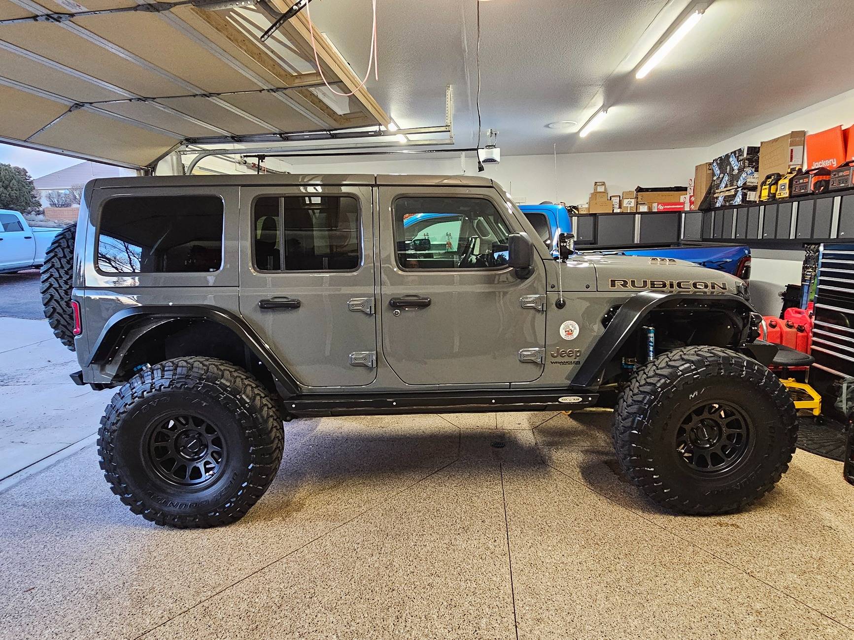

I have the same front axle as you in both our Mojave and our 392 XR. I don't plan to spend any money on the stock axles either. If it breaks, I'll change to UD 60s. Stock 4.10 gears are fine on our Mojave with 35" tires, and stock 4.56 gears are actually fine with the 392 XR and 40" tires. The 392 has enough torque that gearing doesn't seem to matter in that Jeep.
A shock upgrade can make a difference, especially by increasing suspension travel. Our Mojave is basically stock, with just a Mopar lift, shock extension brackets for the stock shocks, Metalcloak control arms and track bars. My 392 has had some mods in the 3 years I have owned it though. Initially a 2 1/2" lift and Fox DSC shocks on 37s; now with a 4 1/2" lift and Accutune valved King adjustable shocks on 40s. On the 392 I have 6" of uptravel in front and 4 1/2" of uptravel in back. I had to extend the rear bumpstops 1 1/2", but the front bumpstops are stock length to maximize uptravel. Aftermarket fenders provide enough tire clearance to prevent any rub. The King shocks ride much better than the Fox shocks did, just something for you to consider. They are plusher while also being more controlled. The additional 2" of uptravel that came with the 4 1/2" lift dramatically improved ride quality at speed. I think that made more difference than anything else.
Neither of my Jeeps are really what I would consider a go-fast machine though. I wouldn't be going 100 mph off road with either of them. Kudos to you for that feat.:)
Here's the 392:
Jeep Gladiator IFS Jeep bombing through the desert 392 40
