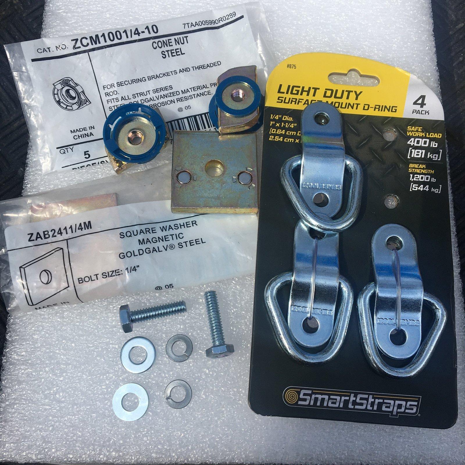

These cone nuts work well in the bed rails. No spring to deal with.

Cone nuts are the best. I got tired of fighting spring nuts...
Agreed - that's what I used to attach the Superstrut crossbars to the Tower Brackets - they work way better than the spring nuts
From post #125...
I also replaced the Spring Nuts (right) with the Cone Nuts (left) - they work much better for this application.

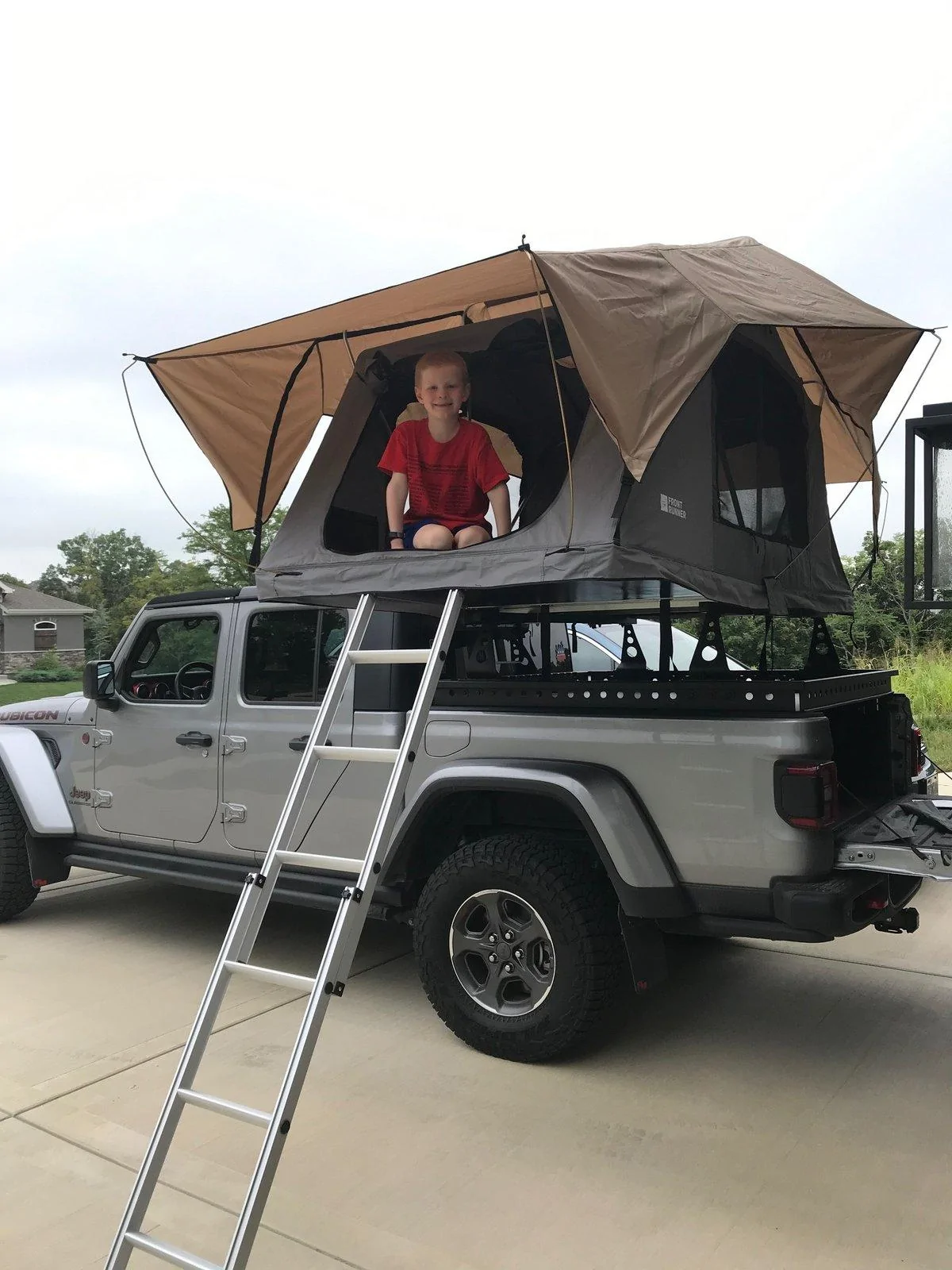

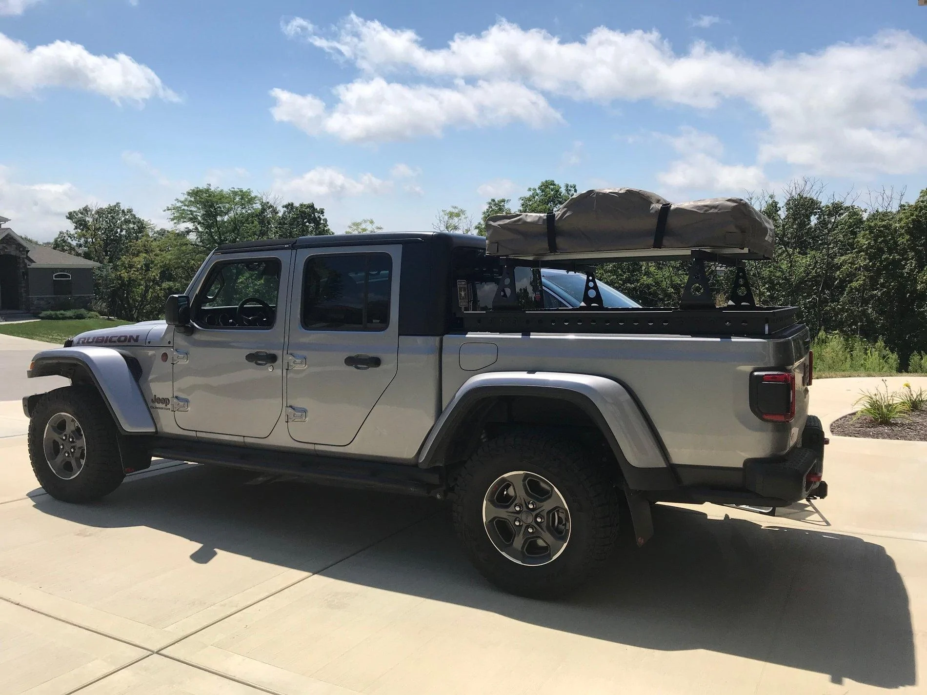

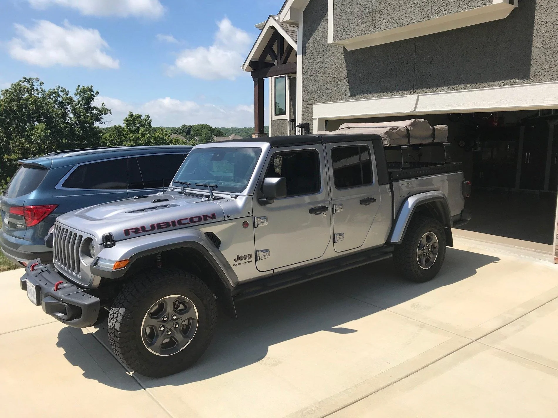

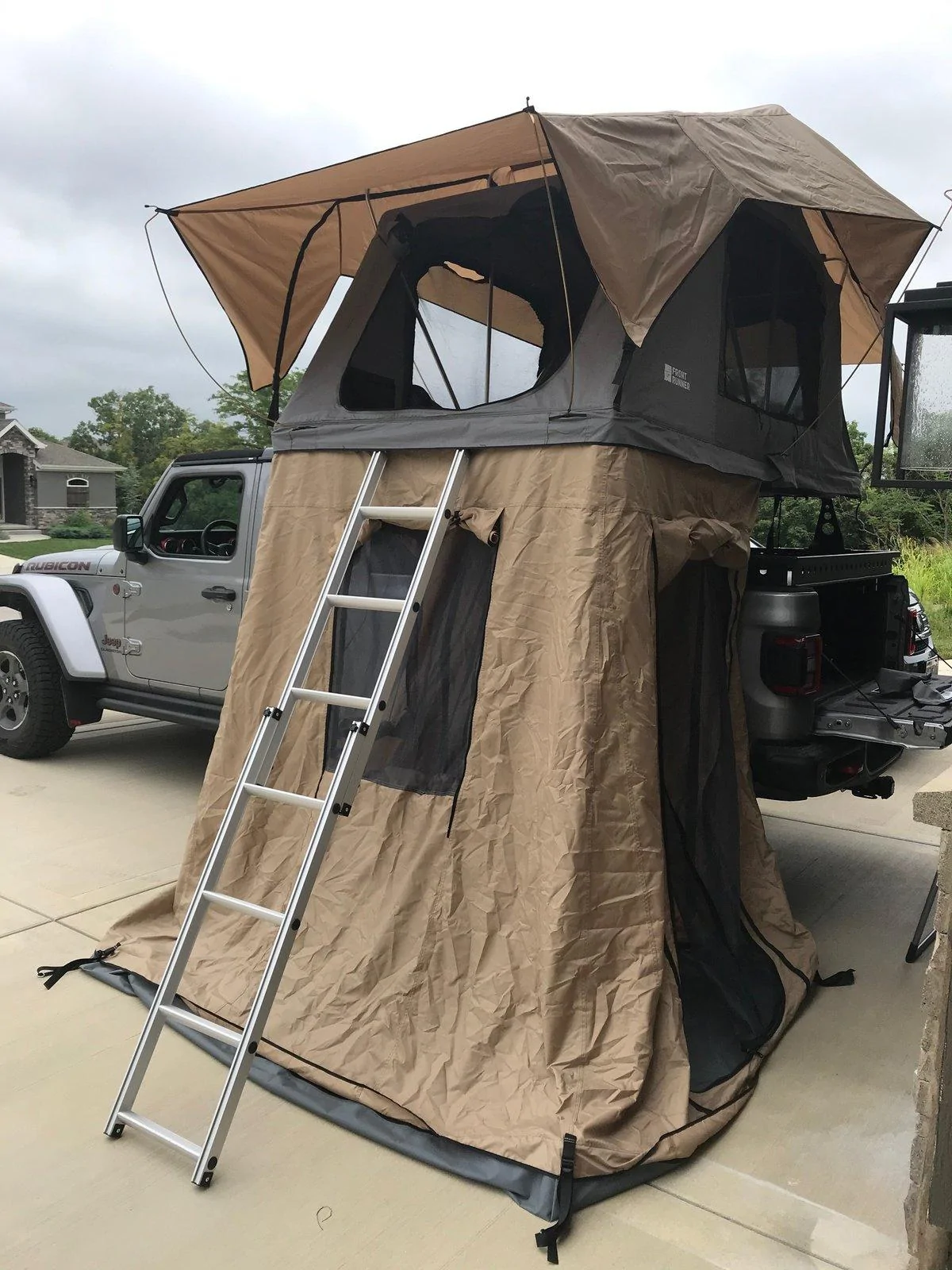

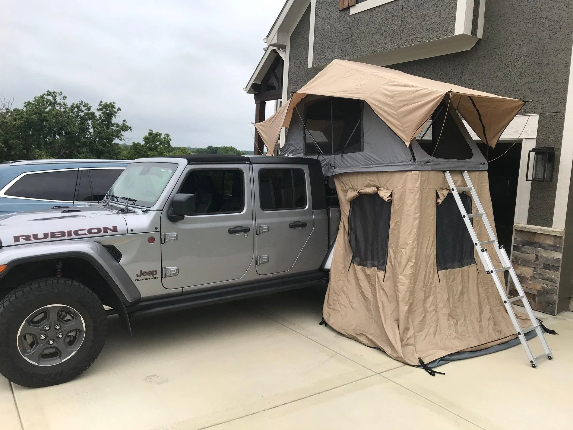

So I have finally gotten my rack parts painted, and my Roof Top Tent arrived, and it's all now put together.
In sum, I have:
1) Ace Engineering Upper Decker
2) Custom Camping Concepts Towers and Bars
3) Welded plates on the Towers that bolt to the Upper Decker
4) Front Runner Rooftop Tent and Annex
It all works great. My only issue overall is that the Upper Decker will no longer stay up all on its own, due to the total weight. I can open it, but I'll need to get something to hold it open if I need it that way temporarily.
All in all, though, I am very happy with the set-up. Driving at speed shows little noise, even with my Bestop sunrider open. Pleny of space in the bed (under the Upper Decker) and on top of the Decker (under the tent). Pleny of visibility out of the back window.
Now just to get out camping!
In sum, I have:

Nicely done! Great to see what you've built!
Rather than using a "stick" (block, etc.) to keep the Upper Decker up/open, can you add more or stronger struts to do that?
LTCSlacker
Nov 30, 2018
128
84
Kansas City, Missouri
2020 Jeep Gladiator Rubicon (Billet Silver)
Military Officer
In sum, I have:
Yes! I could possible get some new gas struts that are more powerful, as long as they can fit in the allotted (pre-drilled) space. I need to check into that.

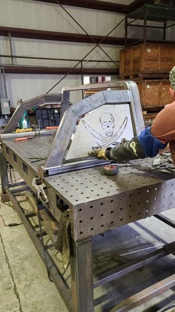

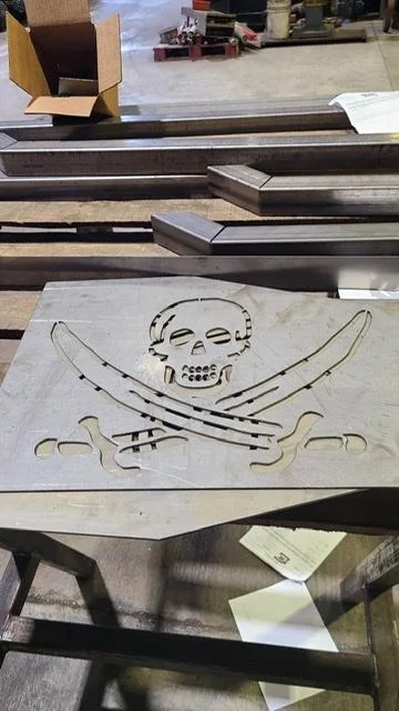

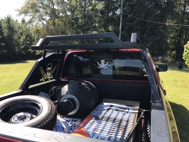

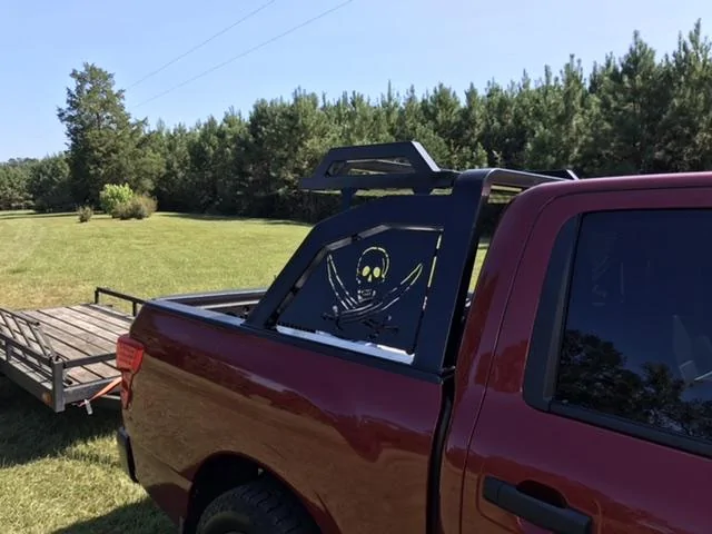

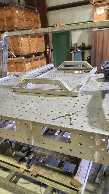

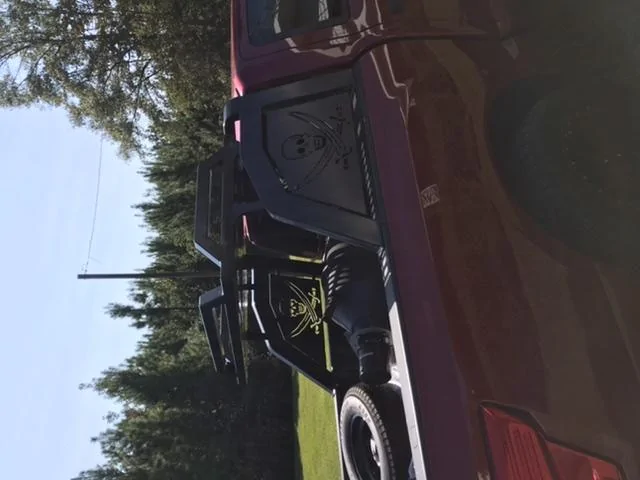

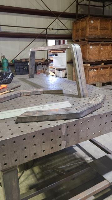

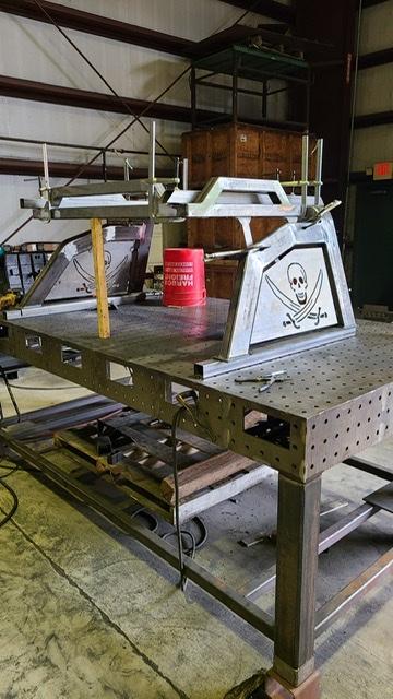

This is a rack I just built for my Titan. I finished it right before I picked up the Gladiator. I gave this truck to my son and traded his on the JT.
This rack was really stout. We used a tube laser to cut the details.
Powder coated it satin black. My guess 800 lbs + would be no issue for the rack.
