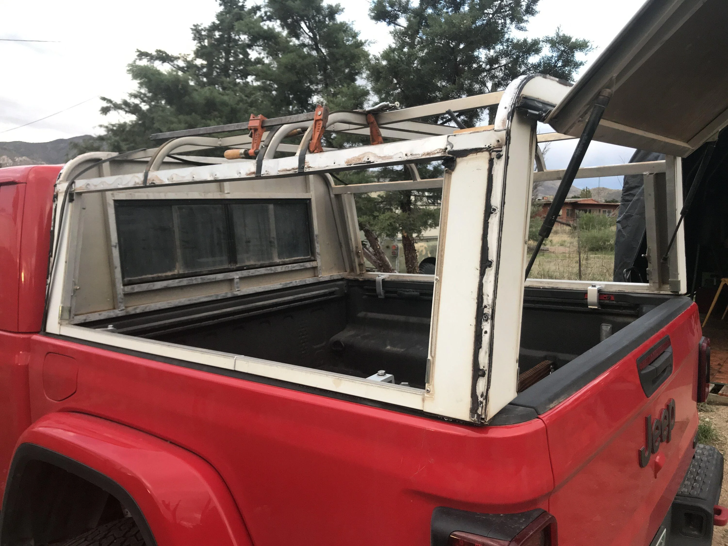

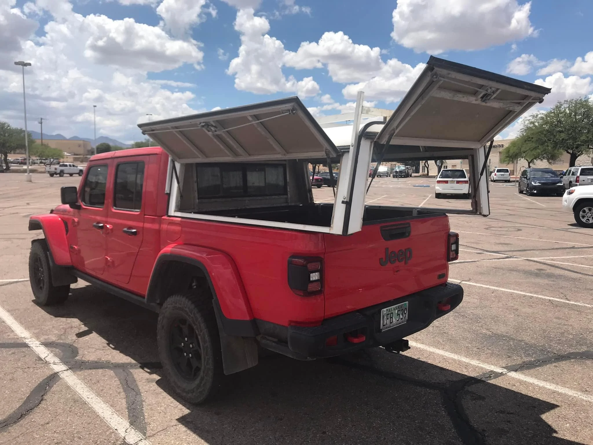

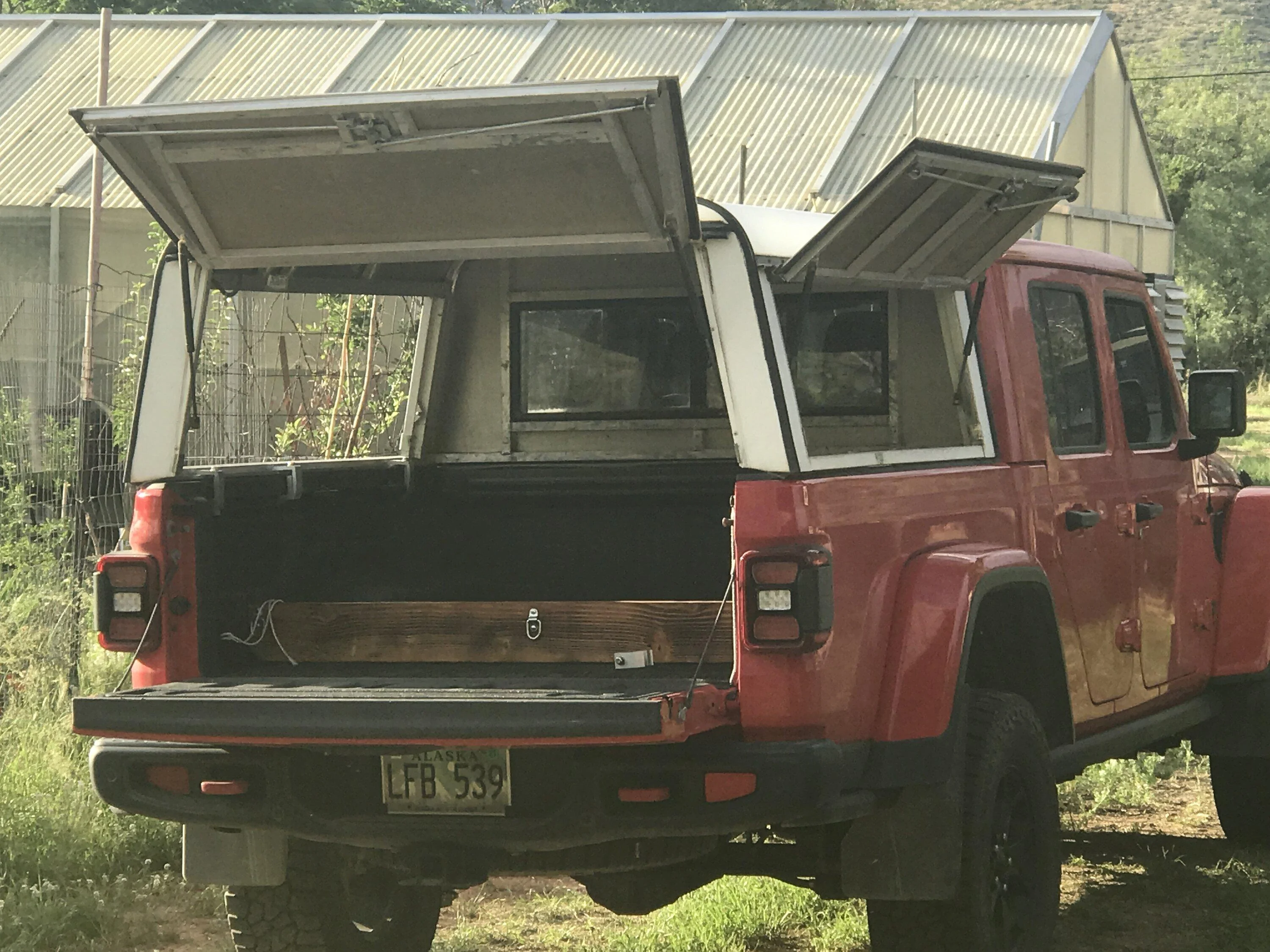

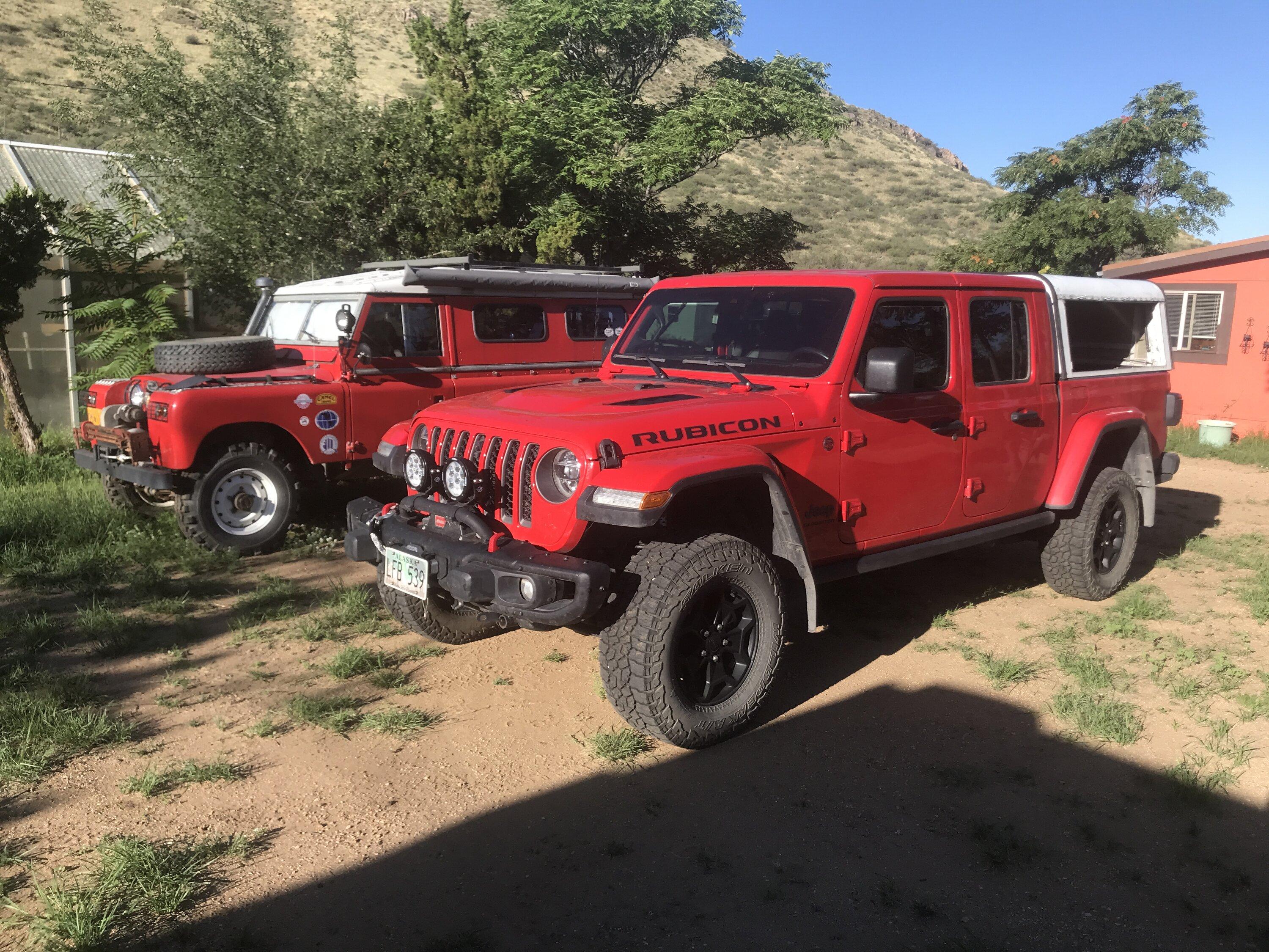

I haven't read thru the thread yet but the short answer is no. Stock is more than capable. And you don't need to spend tons of cash on an already expensive truck to have a blast. I have used a 2 inch spacer lift for just a little more clearance for the back roads but will keep the rest stock. I found a ARE aluminum topper for a Toyota that fit the height and width pretty good, just needed to be shortened 13 inches. I'm shortening the last side door now then will be shortening the roof rack to mount my awning.
