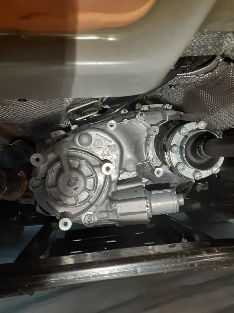

This is a Rubicon JT/JL Rock-Trac Full Time transfer case, probably very similar to the Selec-Trac.
Jeep Gladiator Is Selec-Trac worth trading in your 2020 Gladiator for a 2021? thumbnail_20201210_114104

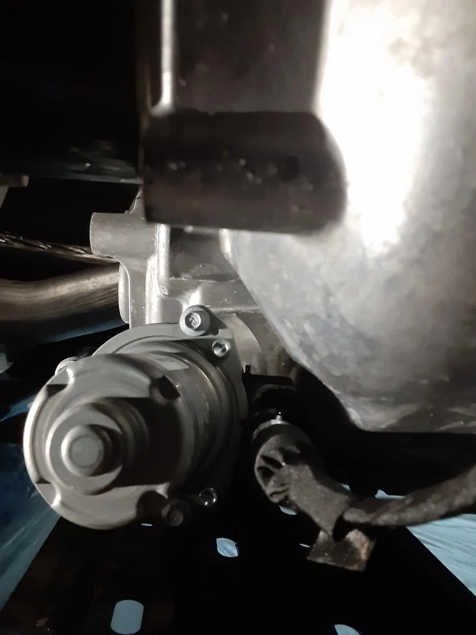

In order to do a swap for a full time transfer case, an active wire harness that plugs into the transfer case full time shift motor would be needed.
Jeep Gladiator Is Selec-Trac worth trading in your 2020 Gladiator for a 2021? thumbnail_20201210_114304

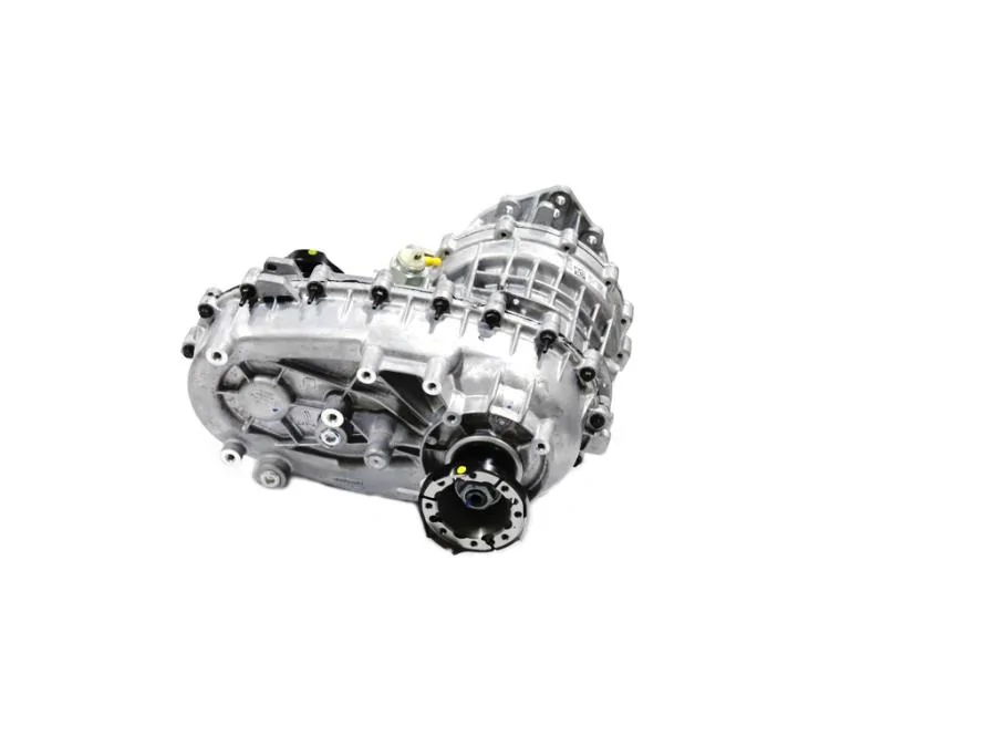

This is a part time Rock-Trac, notice the absents of the full time shift motor.
