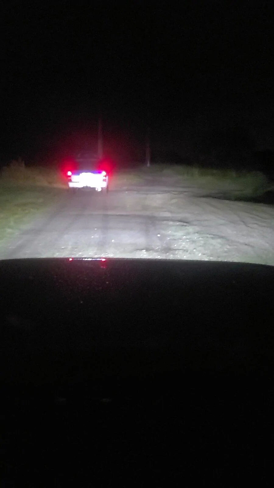

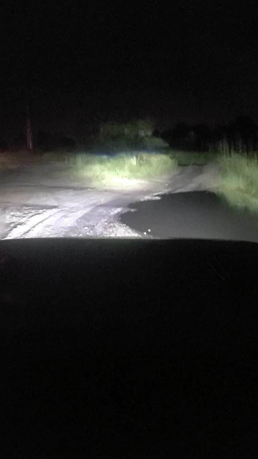

Here's some night shots on a trail to add to my post on page 1. Low beams and fogs. Several car lengths behind a Chevy Trail Blazer. Then into the shrub. In both pics u can clearly see the cutoff, and its just below his rear glass.
