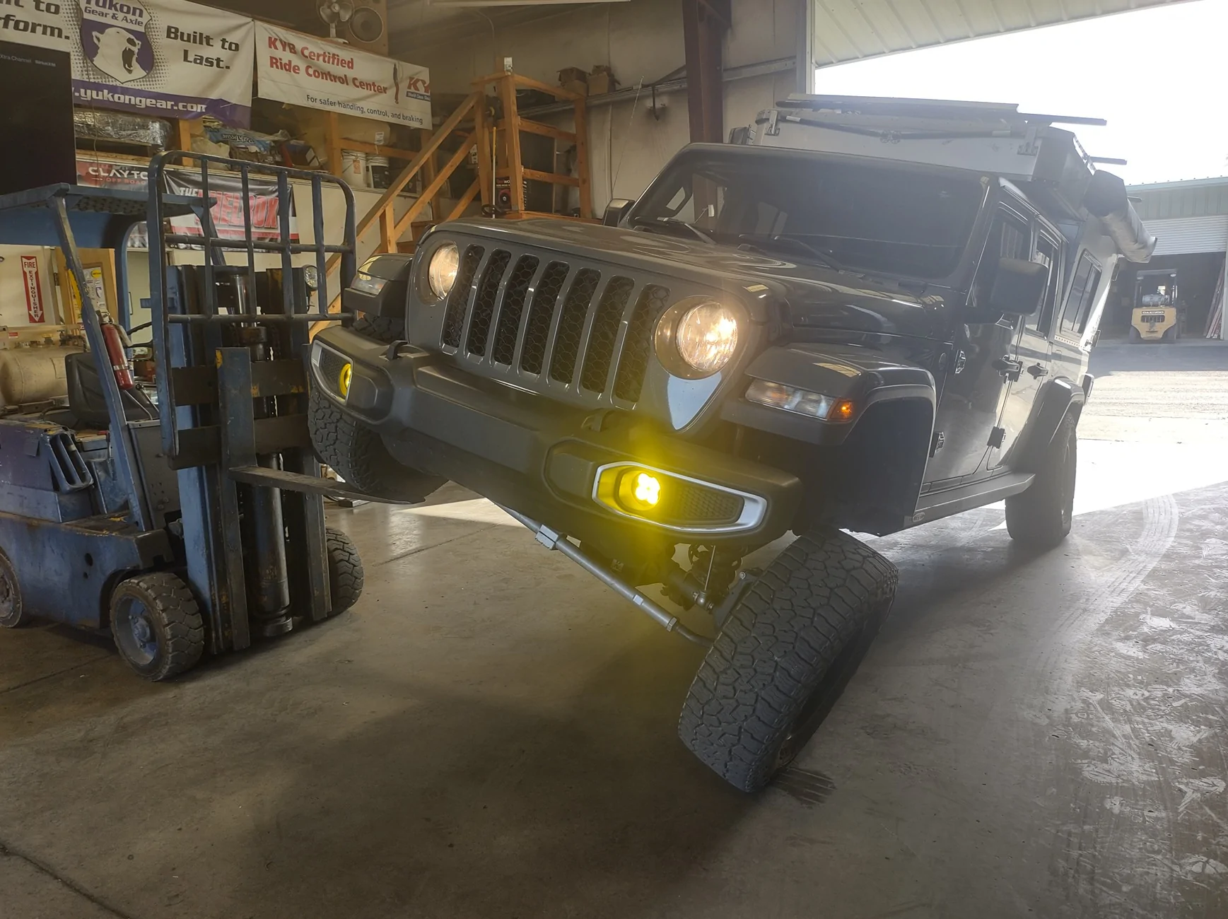

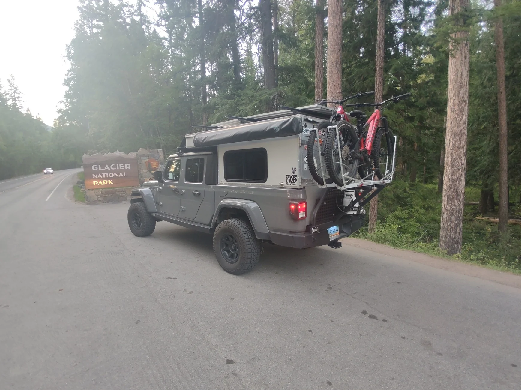

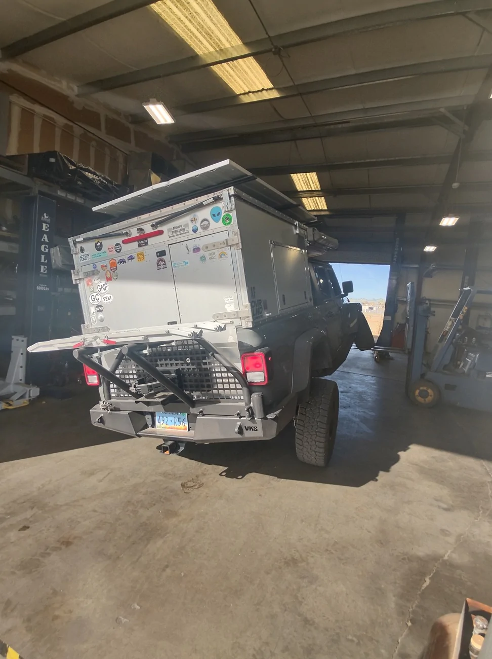

I went Fusion 4X4 for the steering. 2.5 Fox Elites and 2.5 Clayton Overland lift. Also have Icon Rebound Pros -6 It is a diesel and I carry a lot of weight. Just my setup. How about Northern California for a shop? Hit up @CrazyCooter he did my shocks. Still loving them. Also Apex disconnects.
Damn keep thinking of more things
Search the forum for the triangulated 4 link threads. There's a few people on here who have done it. The one who I seem to remember was @TheSolarWizard don't remember his exact setup.

Great pics and I appreciate it. California means taxes gotta try and stay out of there. Oregon hopefully or maybe even Idaho If I can find a shop. I am still looking locally. So hopefully
Taxes one one way or another. The guy I mentioned has two businesses that are top notch!
