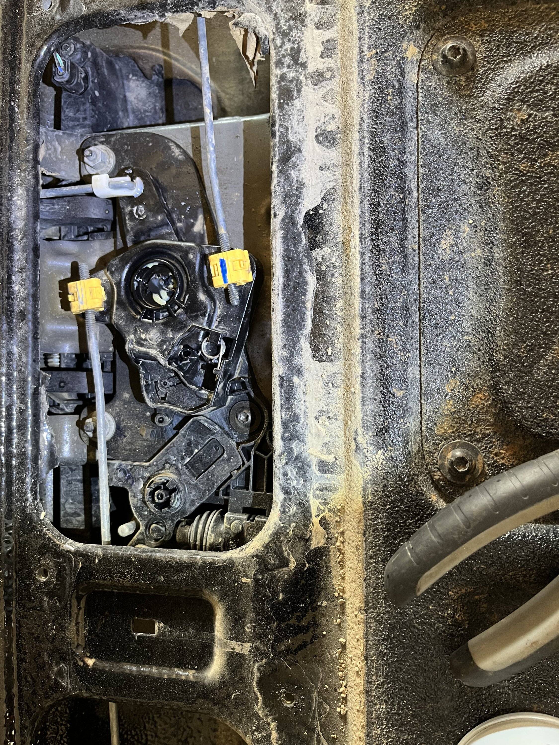

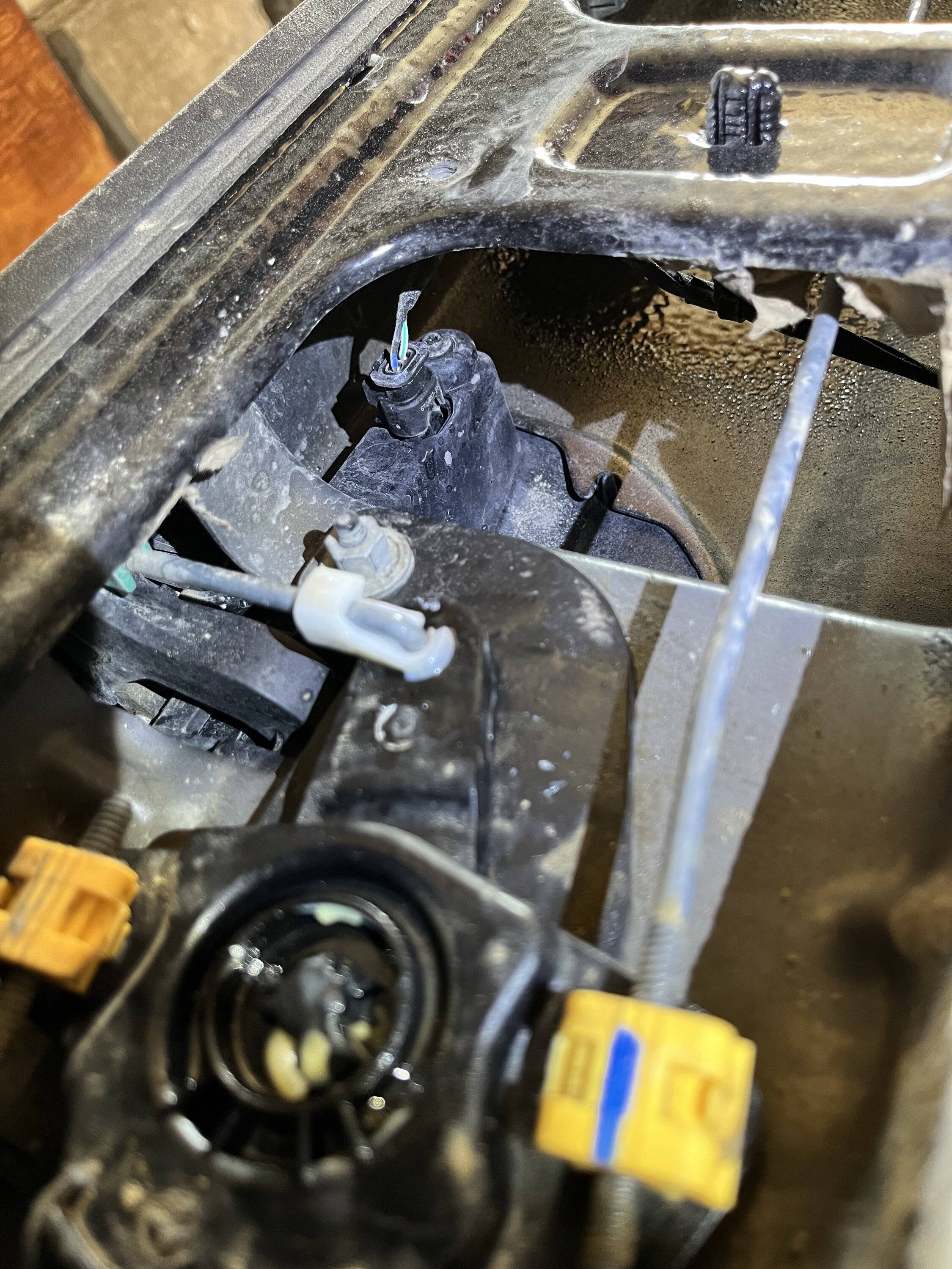

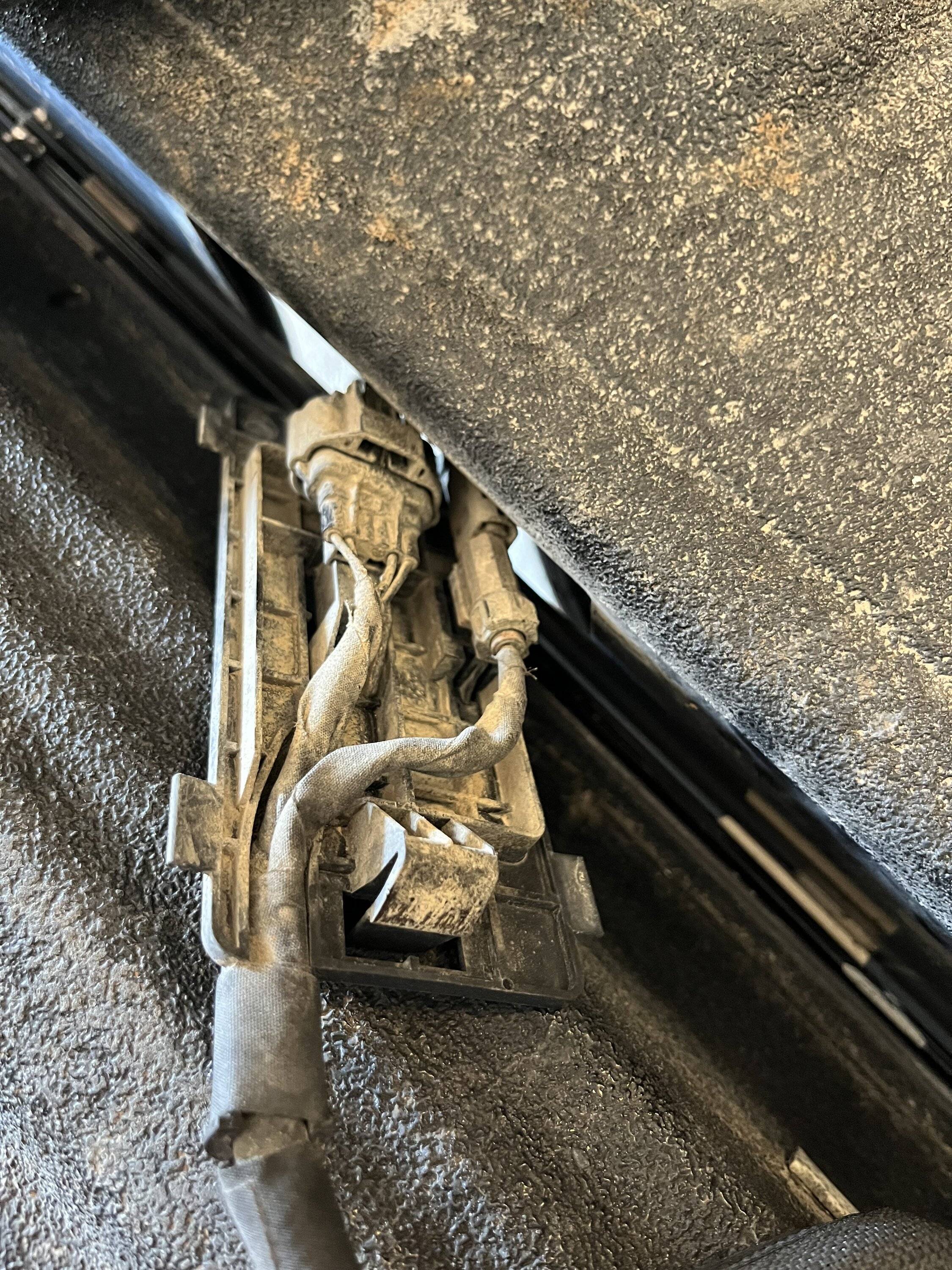

UPDATE!:
took the cover off the gate and unplugged the 3rd light. Cleaned it out, lubed it up and same for the connector coming into the base of the gate.
NOPE! It’s done, gone and dead. Now all I need to do is either buy a new one or snap a photo and send it to the dealership and they will call when it’s in for install.

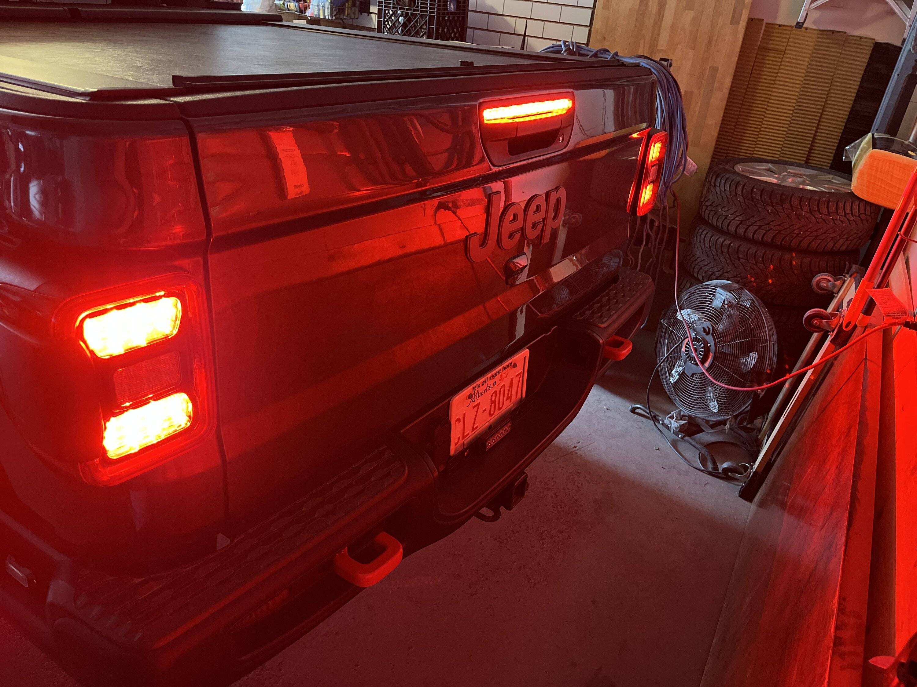

UPDATE:
Possible relearn??!
Got in the truck to go pick up my new light and lo and behold, the light is working.
I’m monitoring now. Hoping the cleaning and lubing of the connectors actually did something.
