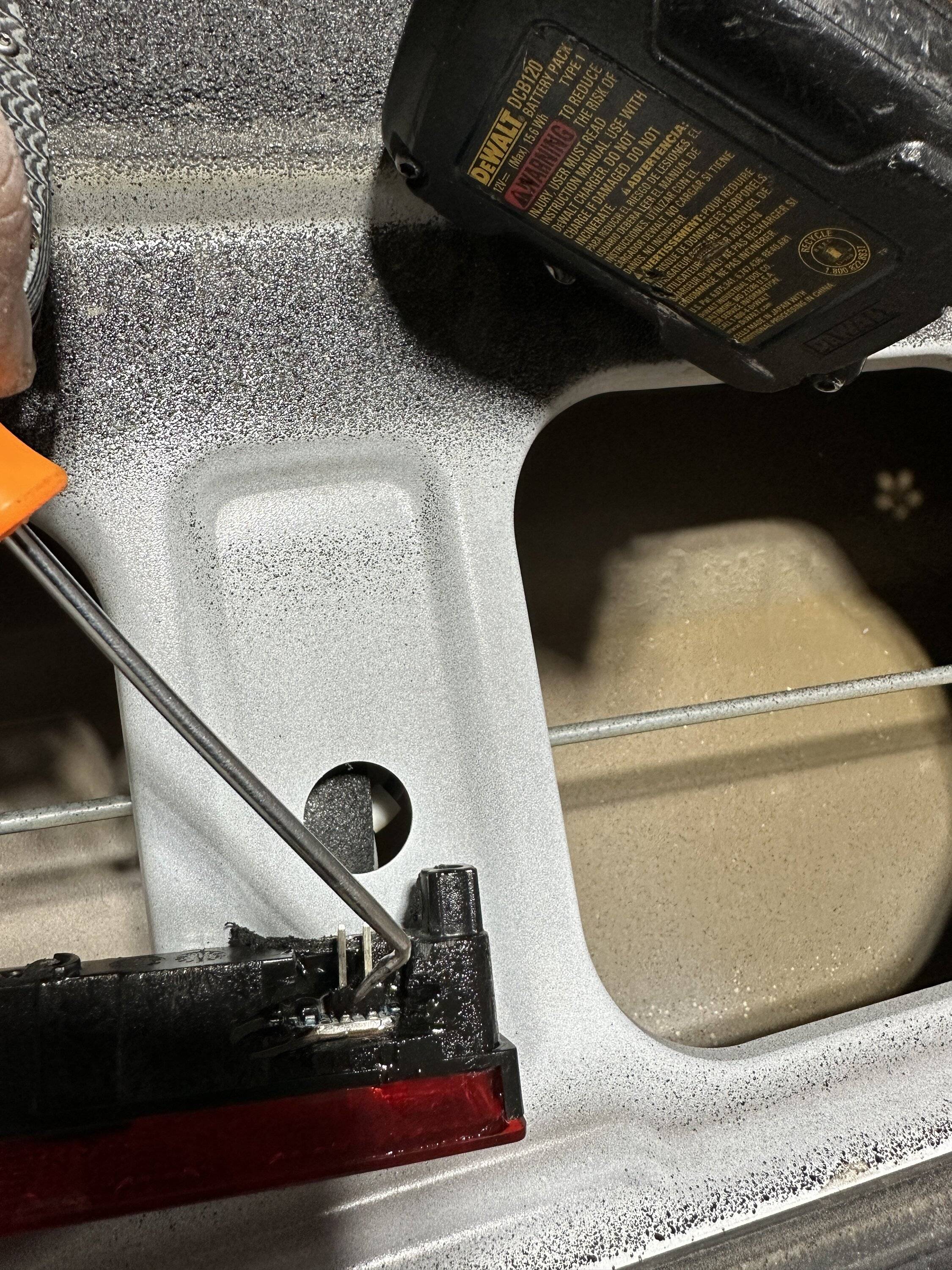

I took my tailgate apart and cleaned the connections and added some dielectric grease. It works, sometimes. No inspection in AZ so I give up. It’s not worth the hassle at the dealer.
