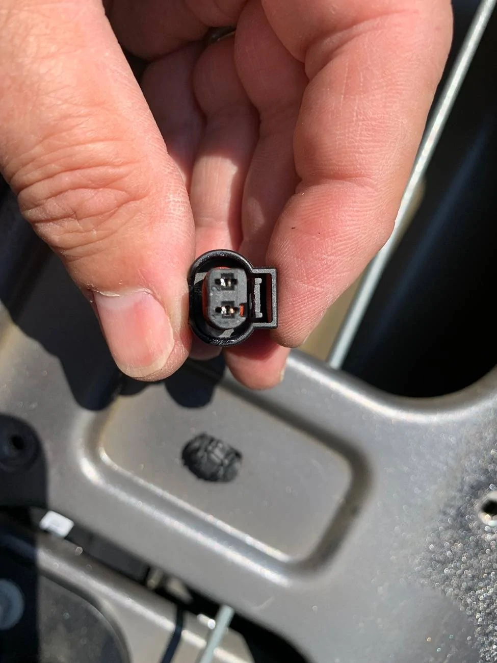

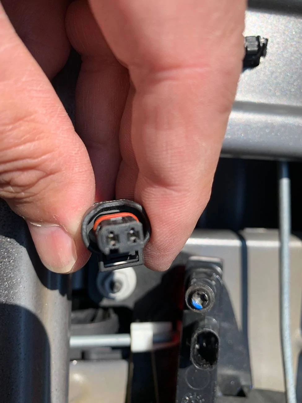

I just fixed my third brake light, either permanently or temporarily, time will tell. In any case, my LED strip was perfectly fine when I powered it on the work bench, even when tapping / wacking it, so I focused on the wiring.
Testing the voltage at the connector, it was fine. But, when plugged into the LED strip, I could make it go on and off with some pushing and pulling of the connector and the wires at the base of the connector.
That led me to focus on the contacts within the connector. I did some gentle bending of the ā€˜forks’ that sandwich the pins to bring them closer to each other so they pinch the pins on the strip more firmly (used a fat needle). That made it about 90% more reliable when pushing the connector back and forth, so I put the whole thing back together. I smeared some grease on the silicone seal around the connector, to help it to snap on a little deeper.
After it was mounted back in place, I could still make it stop working if I pushed the connector one direction, so I dressed the wires so they tend to pull the connector the other way. I put the panel back on and it works fine, at least for now. And, I’m $80 richer, at least on paper.
Pictures below of the contacts before and after bending them closer together.
