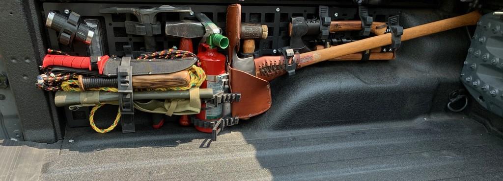

Here is a couple of pics of my JCR side molle panels completely loaded up normally for daily driving and 4wheeling. I really like them and I always have everything I need. Shovel, Viair 440p compressor, Pulaski, pick, sledge, rachet straps, baton, fire extinguisher, hatchet, Twisted Wedge, entrenchment tool, saws, etc.... I keep my max-trax hooked up to my stock front trail rail with some hardware I put together.

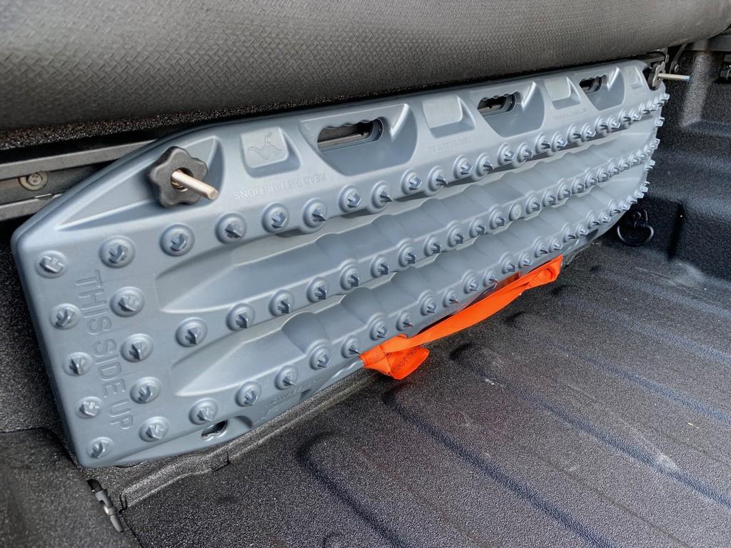

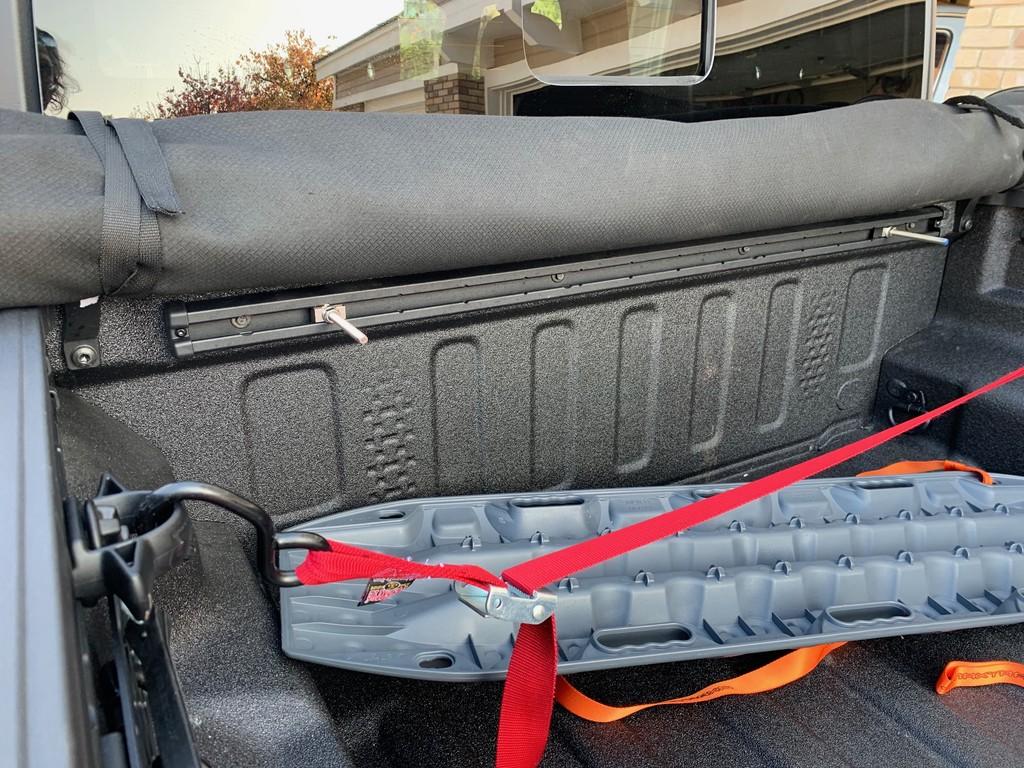

Can I see how you mounted the maxtrax to the trail rail??
hjdca
Oct 27, 2019
1,733
2,496
Southern California Mountains
Here is the link to my installation of the Maxtrax to the trail rail.
https://www.jeepgladiatorforum.com/...one-setup-for-day-wheeling.25530/#post-406585

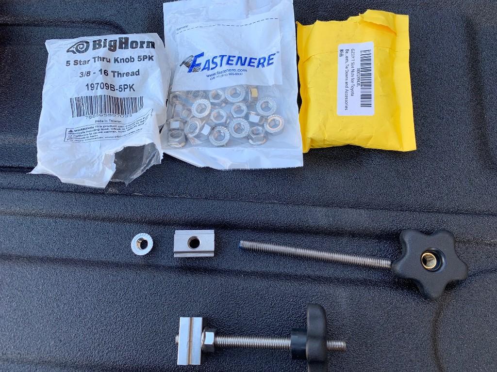

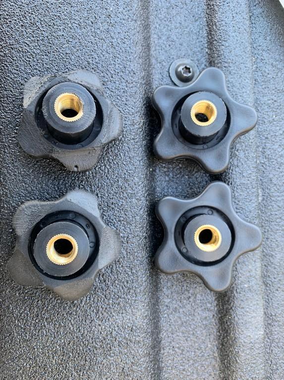

Here is the Stainless hardware for Maxtrax mounting on the Gladiator rails. I got them from Amazon.
Big Horn 19709B-5PK 5 Star Thru Knob 3/8 x 16 (5/PK)
GZSJY T Slot Nuts for Toyota Bed Deck Rail, 4 PCS Stainless Steel Nuts for Tacoma & Tundra Cleats, Tie Downs and Accessories 3/8"-16 Thread 304 Steel
3/8-16 Serrated Flange Hex Lock Nuts, Stainless Steel 304, Bright Finish, Quantity 25
316 Stainless Steel Fully Threaded Rod, 3/8"-16 Thread Size, 12" Length, Right Hand Threads
I cut the stainless studs approx. 4-3/4" long so the Maxtrax could be easily stowed when full of mud. You can also hang a Silky Katanaboy saw or something else on those studs before or after you put on the Maxtrax.
Genius!! Thank you thank you thank you.

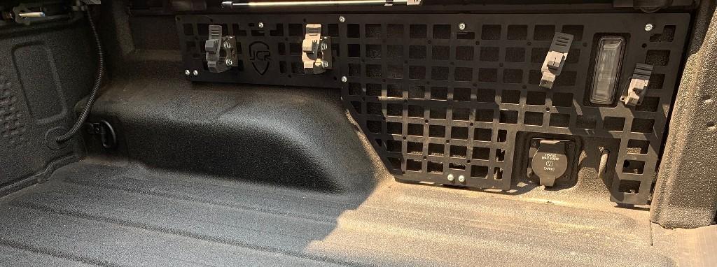

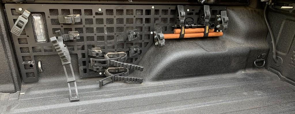

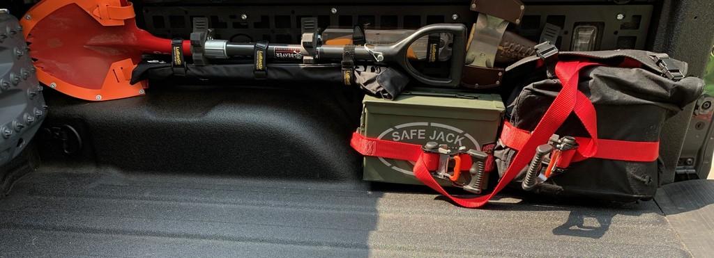

JCR Molle side panels have worked out really well for me. Strong, no rattles and plenty of storage. Here are some pics of just the panels with the quick fist mounts, then, some pics with the mounts loaded up. Note: I changed to rachet straps for the safe jack and my portable Viair compressor because I want ratchet straps in the truck anyway for blown tire seals, limiting the articulation of an axle, or other such emergencies. I am also using the builtright industries riser mounts for the quick fist so that I can mount additional tools under the long shovel and Pulaski.
Drill, dowels, Pulaski, Hatchet, Twisted Wedge splitter, Sledge hammer, Fire Extinguisher, Copper rawhide mallet, hand pick, flashlight, two ropes, Entrenching tool, filet knife, tire thumper
Jeep Gladiator JCR bed side molle panel DX2xLV
Jeep Gladiator JCR bed side molle panel Jg105n
Shovel, Katanaboy saw, Big boy saw, safe jack, Viair Compressor, double bit saddle axe, two rachet straps
Jeep Gladiator JCR bed side molle panel V4AFXa
Jeep Gladiator JCR bed side molle panel cW9Uo9
