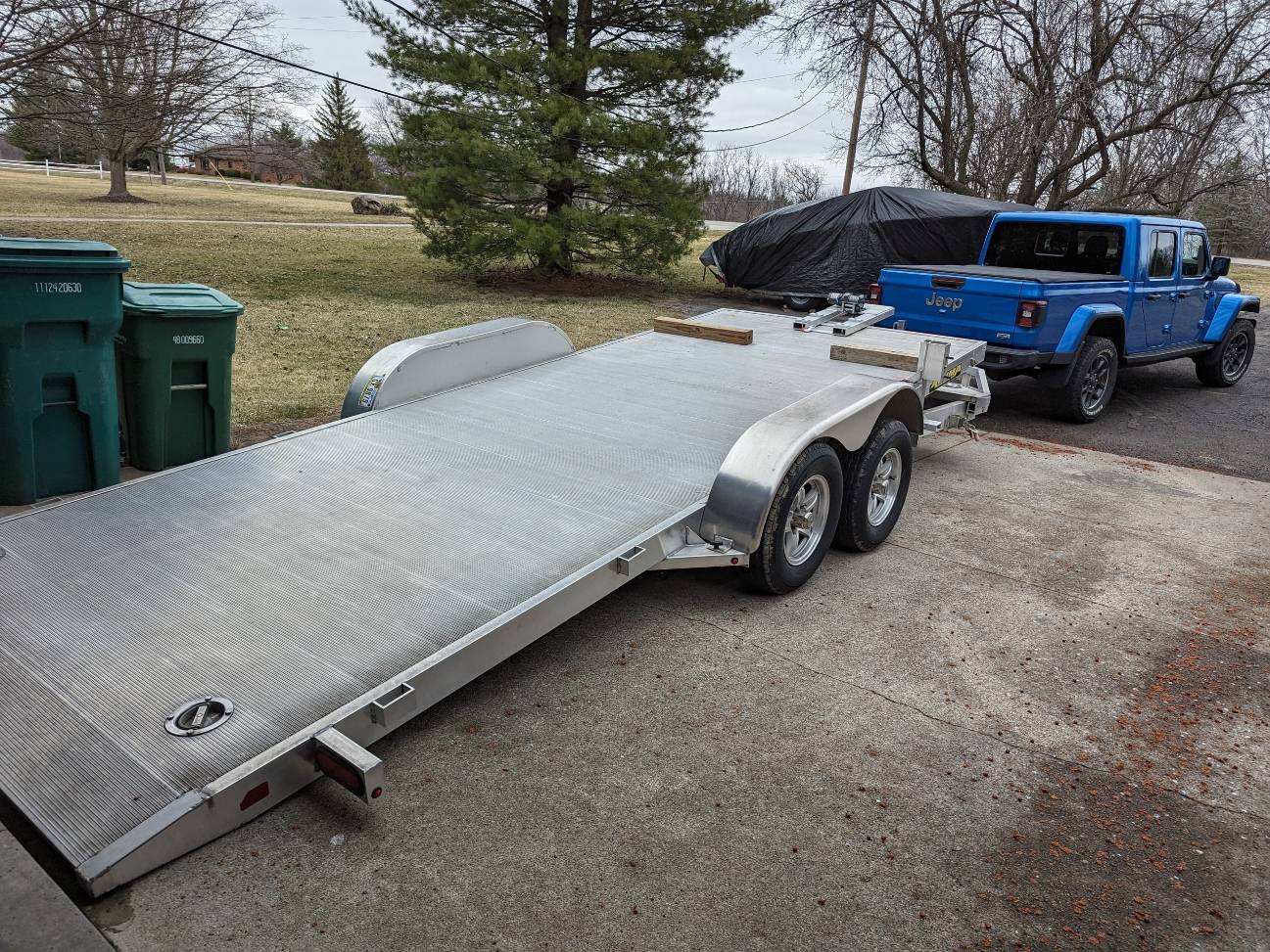

Me backed up to your garage ready to grab your Jeep.........
Jeep Gladiator Jeep Theft in Broad Daylight PXL_20240304_171348292
(just kidding, I would never do it even if I could)
