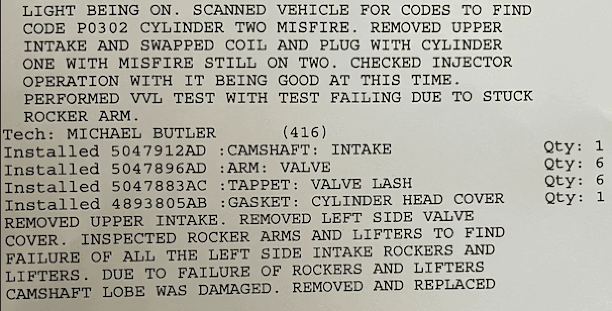

Had owned our 2022 JTR 3.6 for one day short of a year last week Thursday when check engine light came on and engine started running rough. Right at 20.5k miles. Got service appointment for this past Wednesday, dropped it off at 7:00 a.m., they had it back to us by 3:00 p.m. Thursday.
Jeep Gladiator Joined the code P030x damaged camshaft club camshaft
Has this root cause of this type of failure ever been determined with any certainty? By that I mean something like bad metallurgy in the camshaft, lifters or rocker arms? Poor design of the oiling system on that cylinder head?
Given that it has failed and been repaired once, is it fixed for good? Or is it something that has a higher likelihood of happening to us again and we should be prepared for that?

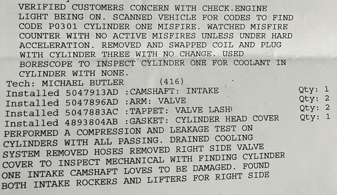

And then three months later...
Jeep Gladiator Joined the code P030x damaged camshaft club Cyl_On
Have just less than 22k miles on the truck, have gotten the oil changes done at about 7k mile intervals.

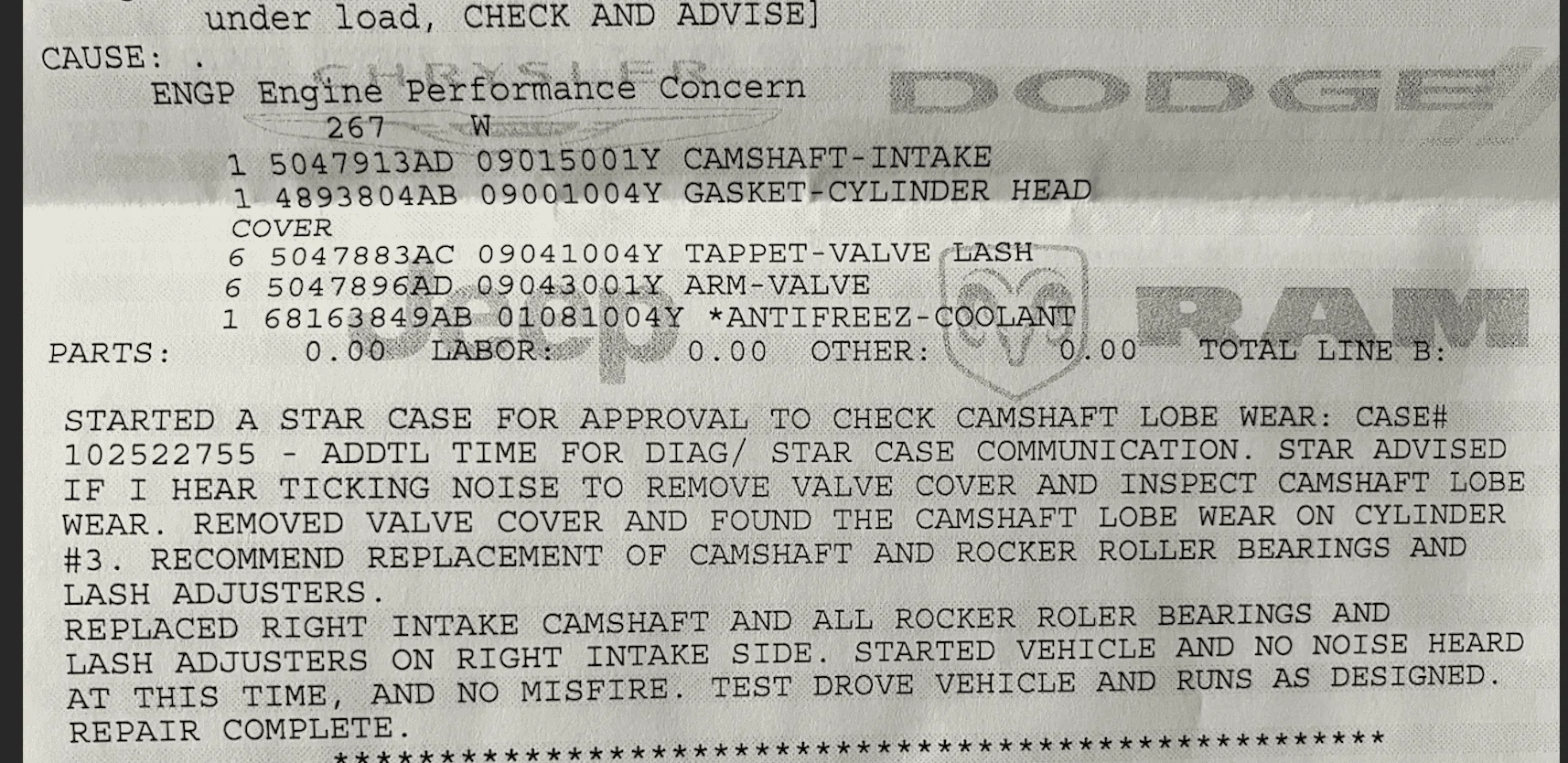

Less than 2,000 miles later the Malfunction Indicator Light came on yet again:
Jeep Gladiator Joined the code P030x damaged camshaft club P0303
Though since it was the same cylinder bank as the last time (misfire on cylinder #1, this time misfire on cylinder #3) and last time they only replaced the rockers on cylinder #1, not the entire odd bank, I'm not that surprised that it failed again so soon.
