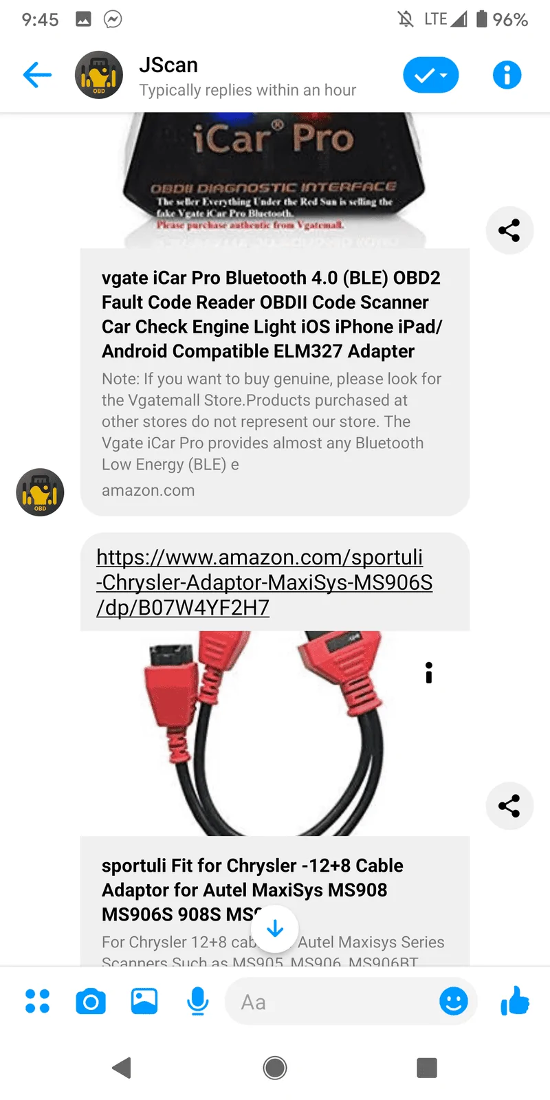

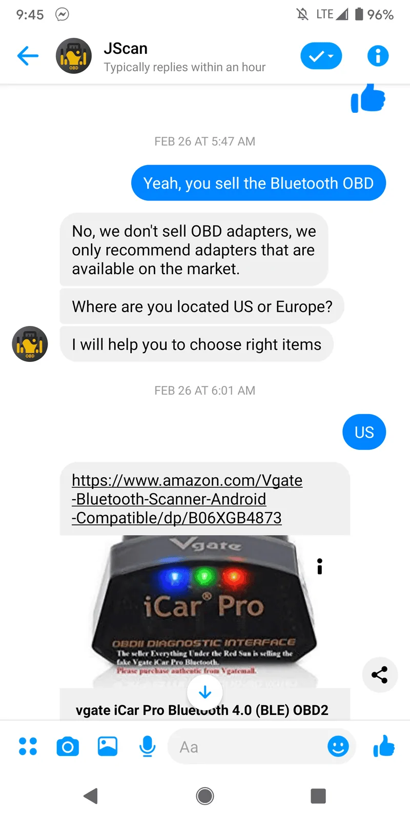

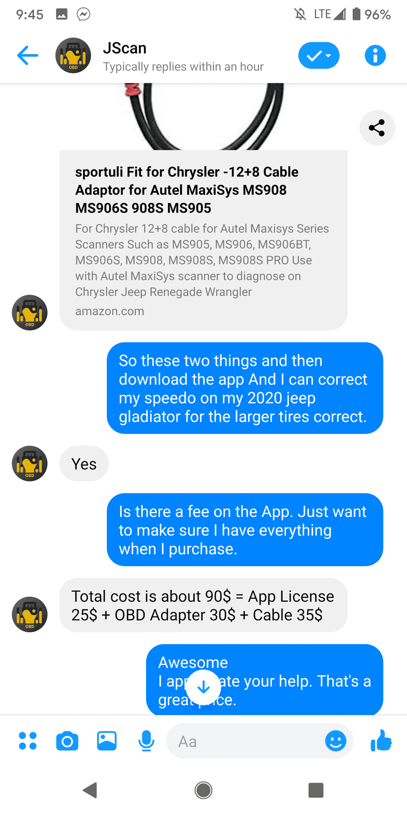

There is a security bypass on the JT, you can't use JScan to change for tires or do the main things you want to do. I think all it will do without the cable is read trouble codes. The developer sent me the links to by those things for it to work and others on here bought it as well.
Here you go screenshots straight from the conversation I had with the developer. He mentions what is needed and the total cost. You don't need the Cable on JKs on JLs and JTs
