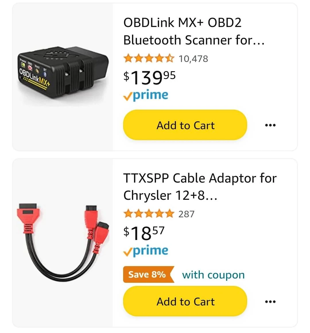

If I want to use the AlfaOBD, do I need anything besides these two things?
Jeep Gladiator JScan Help Screenshot_20221224_005035
Out of curiosity, what about Jscan?
Although, I'm leaning towards AlfaOBD at the moment. Mostly because my wife has a JLURD and I have the JTRD. Plus my inlaws have 2 Jeeps as well.
Thanks.

Those will do it - but a warning -
AlfaOBD does not yet support 2022 Gladiators/Wranglers.
When are they going to? "when we get the info we need and have enough requests".
They actually state on their web site what happens first is dependent on the number of requests.
So I suggest Gladiator owners storm them with requests LOL
JSCAN handles my 2022 just fine - but I much prefer the logging in AlfaOBD (well, I did on my 2020, it can't fully access my 2022 yet)
AlfaOBD will work with any FCA vehicle with one license.
JSCAN is licensed per VIN. Have two Jeeps - you need two licenses.
When you trade Jeeps you need to buy a new license for the new VIN.

What exactly are you not able to do on the 2022 with AlfaOBD? Everything should function the same no matter what model year, you just need to go into settings and check the box for “do not verify ECU” so you don’t get the unable to identify pop ups. Also, if there’s a module not in the gladiator modules list that you need access to, just switch over to a different vehicle that does have the module you need, and you can connect to it that way.
251
40,635
54,390
Couldn't get to anything engine-wise - PCM
I tried to check some things like CCDIFF and it said it wasn't able to get there.
I tried several times, and each time it err'd out saying it couldn't connect.

While this is technically a "nice to have", it's as close to mandatory as it can possible be without actually being mandatory.
The SGW connections are way up behind your steering wheel, and hidden behind a poorly finished metal plate. I have fairly skinny hands, and while I was able to reach the ends of the cables with my fingertips, I cut my hand open several times on the metal plate just trying to get the cables to budge. Thankfully my tinier half was able to get them out eventually though.
This cable plugs into the original spot that's a pain in the ass to reach, and hangs down just behind the steering wheel trim panel, so you can easily reach and disconnect/reconnect in the future if you ever need to change anything else. I have two, just because it was still kind of a pain with just one.
