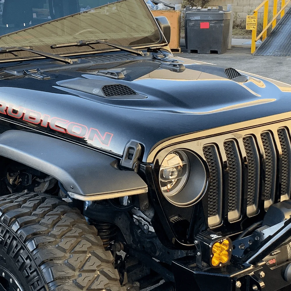

No mojave Diesel but there are Diesel with Mojave hood.
Mojave got different hood - it is not only different hood style but it is higher mounted. This means that Snorkels like Rugged Ridge will not fit Mojave hood. Same is with light bar mounts, cowl lights mounts etc...
All European Diesel Gladiators got Mojave hood design. This means that EU people got a lot of problems getting anything for their Gladiators.

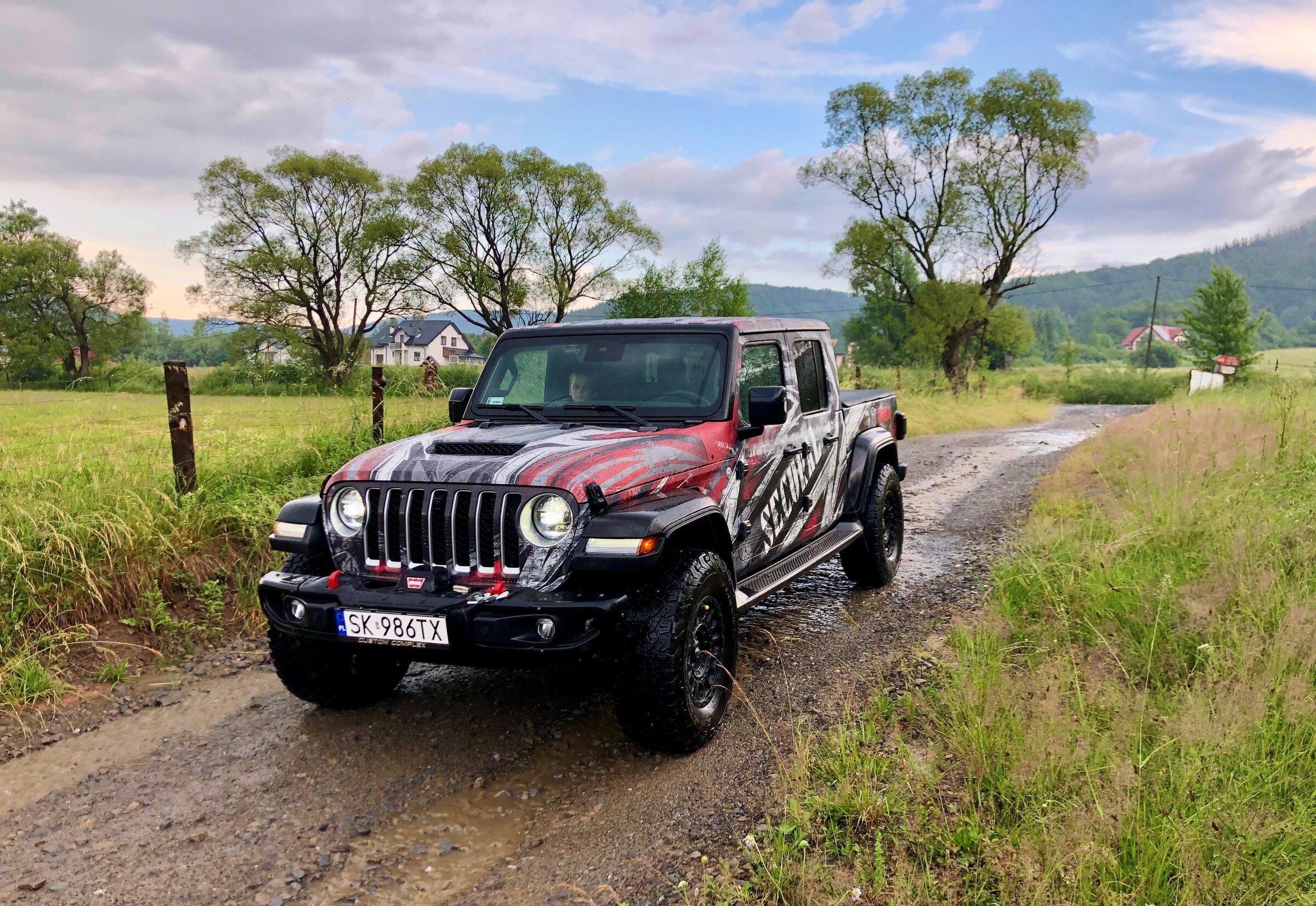

Below - my EcoDiesel Overland (from factory: Mojave hood + Low fenders +Front parking sensors + Selec Trac Full Time 4WD)
Jeep Gladiator JT Diesel Snorkel Mojave hood

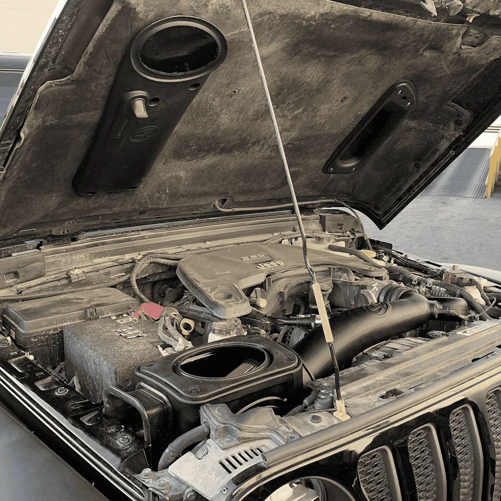

Hauk Offroad Snorkel
That doesn't look that bad, I kind of like it.

That Hauk snorkel looks really good to Mr. Functional yet not super flashy/aero drag as most. Mine only concern before purchasing is the long intake run above the back of the engine and how much that raises air temps. Plus is it catching hot air escaping the hood vents at low speed.
