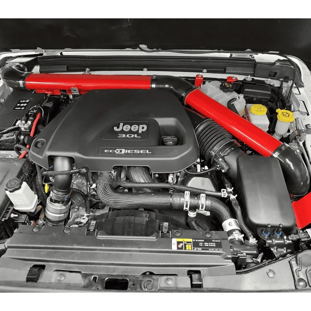

That Hauk snorkel looks really good to Mr. Functional yet not super flashy/aero drag as most. Mine only concern before purchasing is the long intake run above the back of the engine and how much that raises air temps. Plus is it catching hot air escaping the hood vents at low speed.
Is the tube aluminum or plastic?? If aluminum then ceramic coat it to keep the heat out. If plastic then exhaust wrap?? At 1800 rpm’s one would think the draw of outside air would still be cooler then the stock setup??

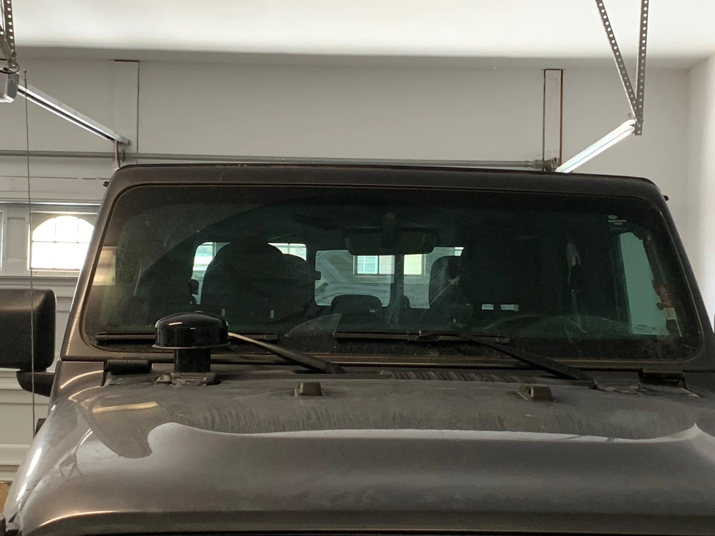

Jeep Gladiator JT Diesel Snorkel 66141375-C30C-48B3-BE10-9A9FE318B469
Same as in USA we do not have diesel snorkel:)
So if I am not mistaken, the cowl hood vents are intake vents for the interior climate control (heat, A/C and vents) so that would not affect it.
I thought about the long run across the top of the engine and I don't think it would matter because you will be pushing air thru it fast enough to avoid any huge increase in air temps to the air box. Besides, you are sucking hot engine air when stock, the iput of cooler outside air has to be a benefit.
With the placement of the snorkel in the cowl area, the aerodynamics of the Wrangler style will prevent huge amounts of dust from going thru the system keeping your air filter cleaner longer.

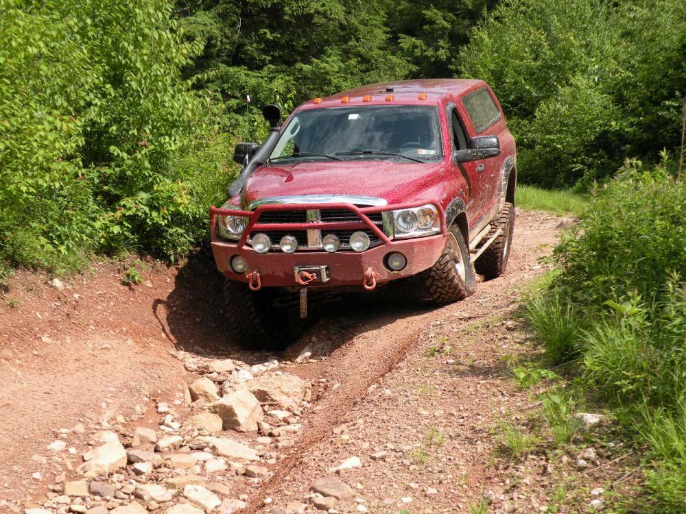

If we could get AirFlo to make us a snorkel. We'll be in business. The guys on the Power Wagon forum years ago asked them if they could make a snorkel for the 3G Rams. It took them about 18 months to do it. BUT they wanted a deposit before they started. The first run was 400 snorkels. I got one of them. Great quality. I just shot them an e-mail. asking if they are planning to make them. Other people need to do the same.

You won't damage an AirFlo snorkel. Believe me. I've busted tree branches with the one on my Power Wagon.
Engine intake temperatures have lowered. The hood vents do not allow hot air to escape. Instead hot air is drawn through the bottom of the back of the engine.

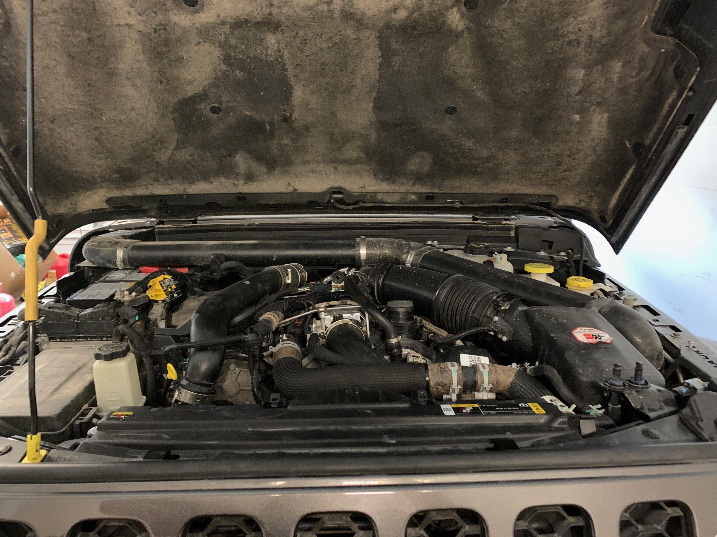

It’s aluminum. No need to coat it. The intake allows cooler air regardless of the engine temps. I have seen some improvements in throttle response from it. The biggest was when we got our green diesel engineering tune. It really helped. My exhaust and down pipe are my restrictions now.
That say only real downfall is that if you need to work around the battery you need to remove the back pipe. I’ve been nothing but pleased with the system.
FYI these systems have been used for decades on military vehicles without any detriment to intake temperature or use. I can talk to Hauk to see if I can get a discount code for everyone.

My thought with coating it if aluminum is that you lower heat soak even more. Perhaps not needed but couldn’t hurt. I’m glad to hear it’s not plastic.

Two things going against the Hauk snorkel. In Pa. it would be illegal because of it's placement. It block the view out of the windshield on the right side. The other issue is heat soak. With all that piping under the hood. When going slow. Engine heat will soak into the piping, driving your IAT up. If it goes up high enough. The ECU will cut back on power.

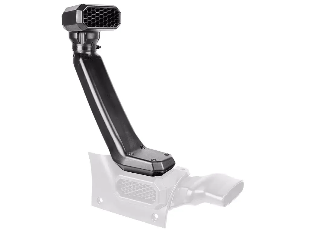

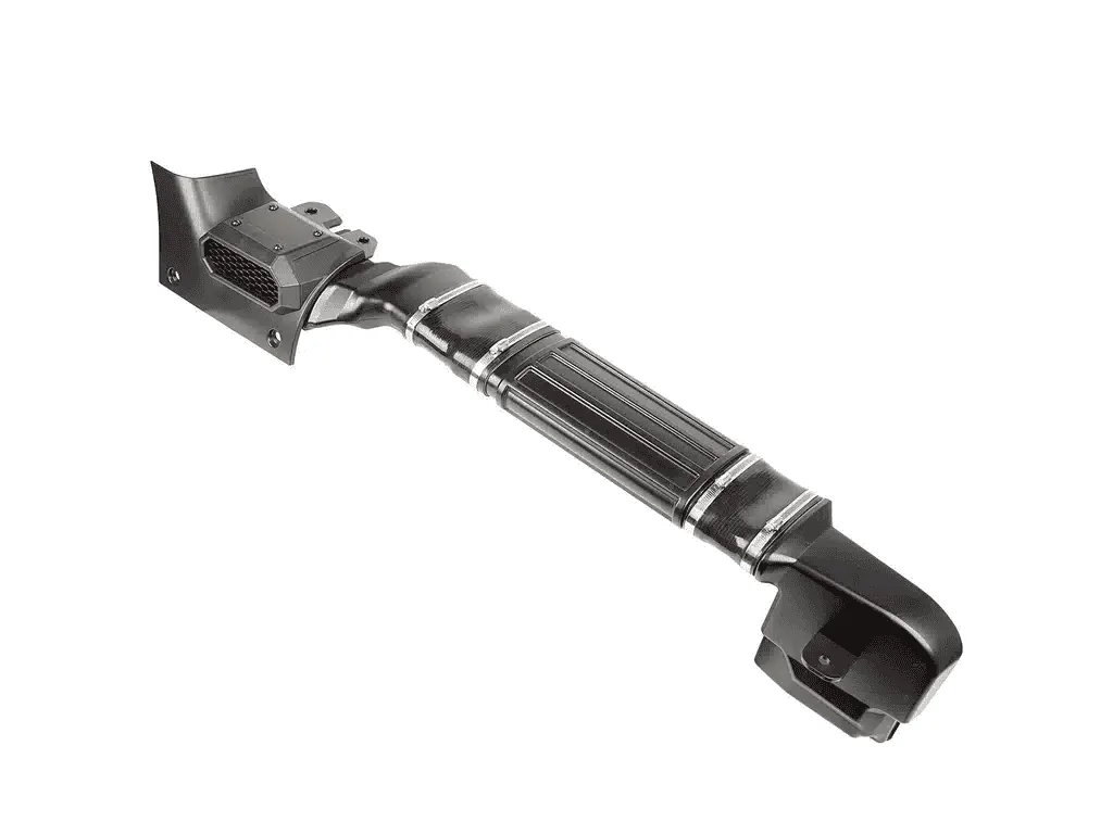

I think the Hauk air box and plumbing to the Rugged Ridge cowl snorkel is the way to go. Doesn't Hauk already sell their kit without the snorkel itself? All we would need is to talk them into adapting the housing to the reach Rugged Ridge inlet. Maybe another company could develop an adapter. Will Rugged Ridge sell just the cowl part of the snorkel with no plumbing?
