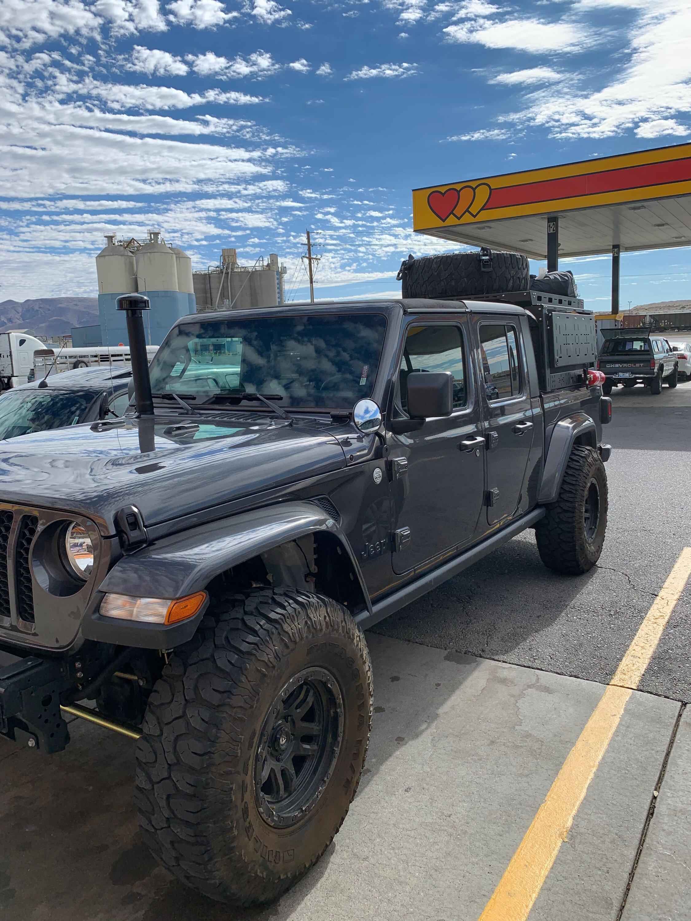

doing desert running behind a crew makes the snorkel well worth it. ive used the short one and the tall one, and the dust level is way better with the tall snorkel. i wish they had made a standard one, but this works for me.
I spent nearly a month thru 6 states on a very dry and dusty overland trip. The guys with no snorkels and high snorkels had to clean their air filters every day. I was using the Rugged Ridge short snorkel and had a clean filter the entire trip. I asked Rugged Ridge about this and was told the airflow in that area created a dust free vacuum, hence a clean filter.
