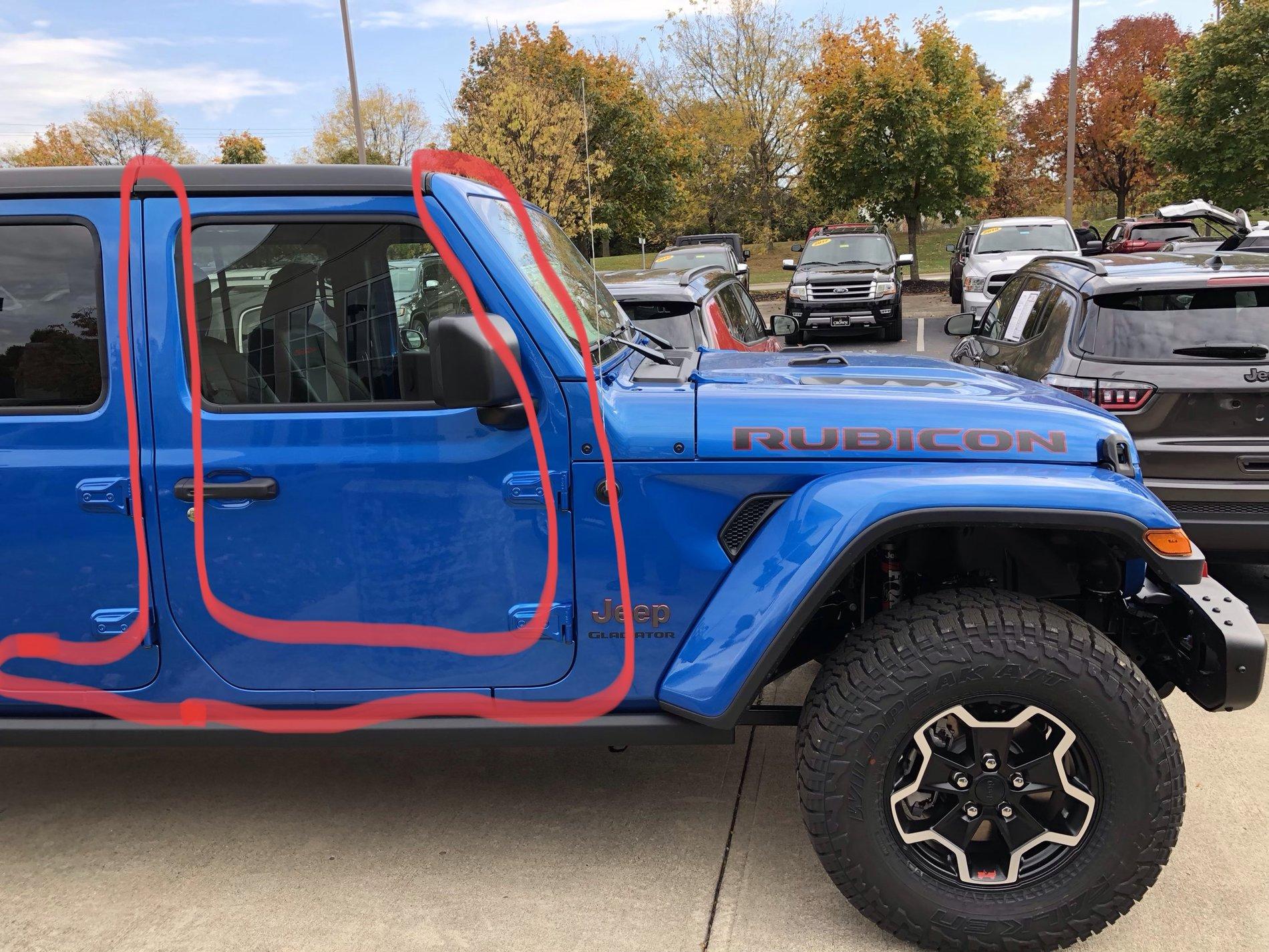

Can you elaborate? Do you have some pictures?
Check to make the the door to body gaps are consistent, I have seen a few including my wife’s new JL that the door is too close near the top of the windshield with larger gaps at the bottom. See photo for reference, the gaps in the photo are not too bad and has space along the windshield.

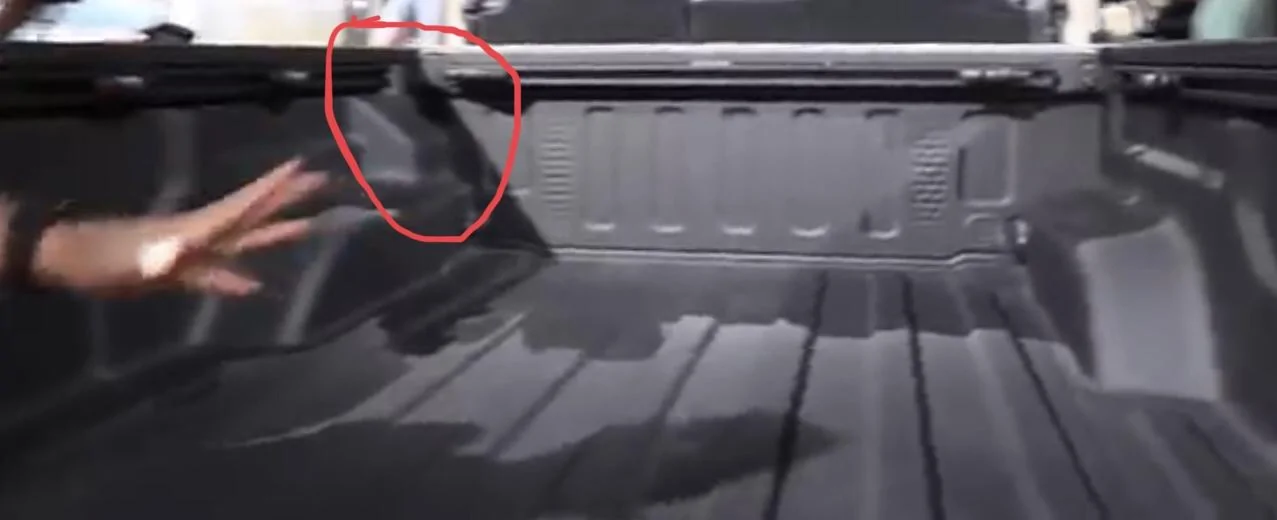

18. Plywood notch is in proper working order (keeps plywood from sliding left and right while turning)

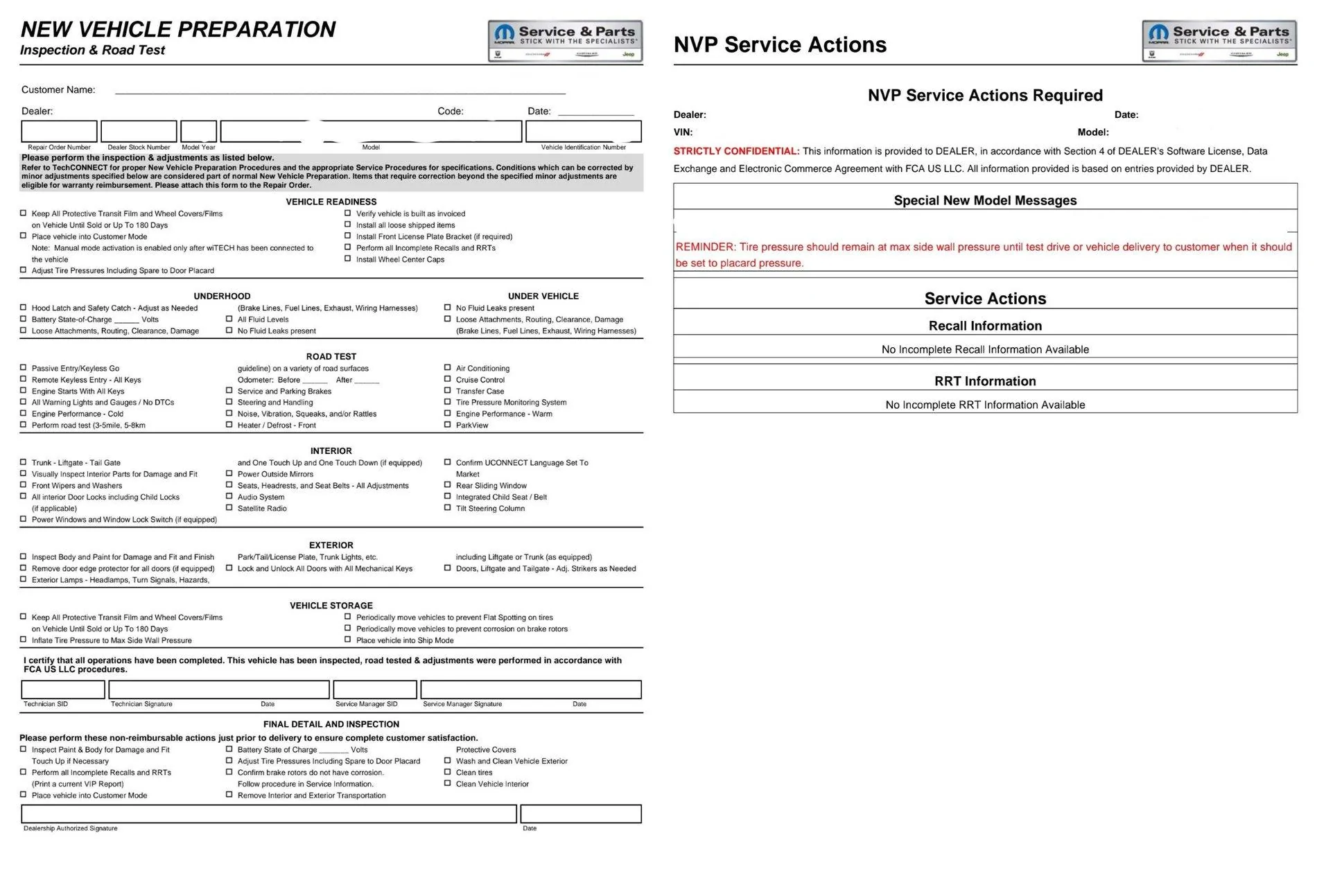

22. Ask for copy of the New Vehicle Preparation Inspection & Road Test Form. Check for completeness. (https://www.jeepgladiatorforum.com/forum/threads/loose-steering.16550/page-14#post-374032)

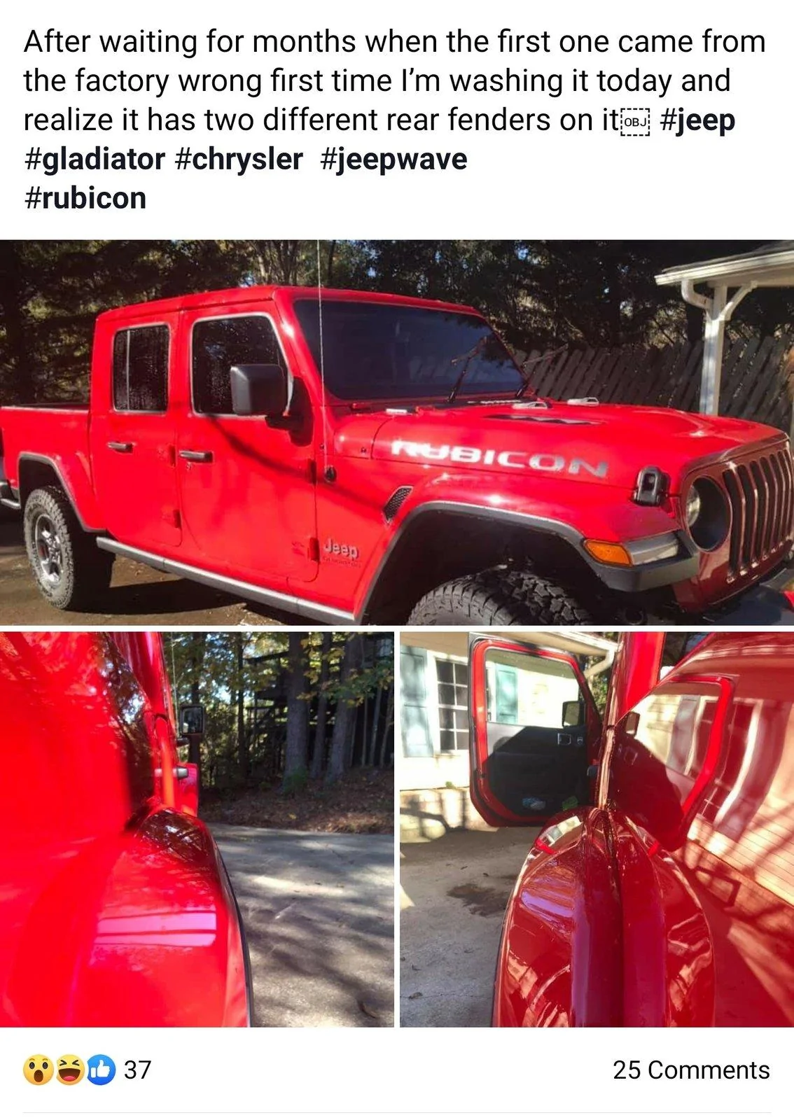

23. Check fenders on both sides of Jeep to make sure they match. Rubicons have higher flatter rear fenders.

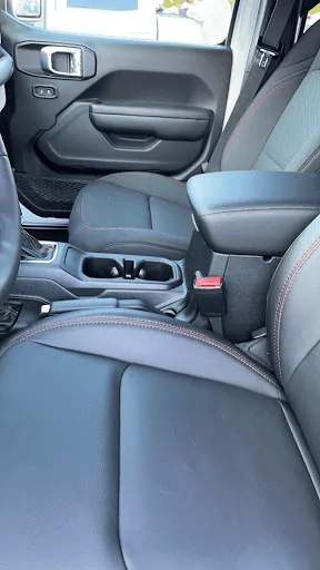

Can someone elaborate a bit on item 11. The dividers for the cargo box.
I ordered the option but am not entirely sure if I am missing something
OMTBiker
Derek
Oct 20, 2019
474
647
Ohio
'21 JLUR, '21 JLU 80th | Past '20 JTR, '18 JLUR
There is a package of 3 dividers for the undersea cargo box, they allow you to create smaller areas for organization.
lmao, you funny! just saw this. nobody talks about ply anymore..... =(
