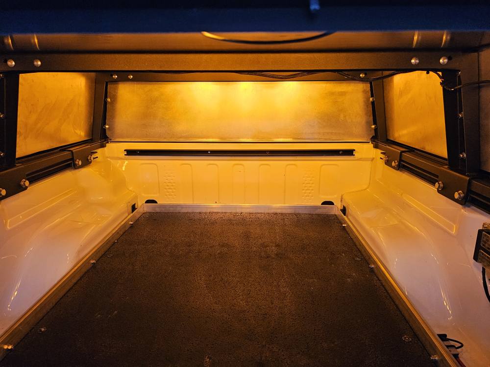

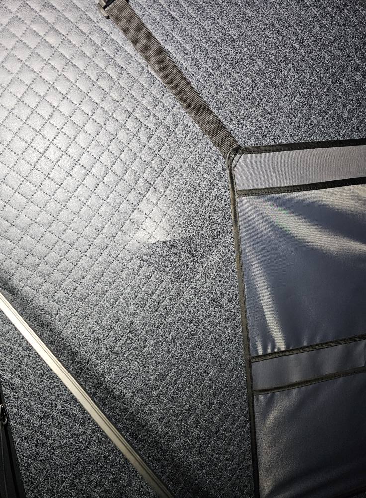

Evening update:
Opened and inspected the rest of the tent. The forklift dented the interior roof panel as well but it didn't break through. Other than that everything looks great, so I'll move forward with patching it myself. Sent the CAD file off to get a new panel cut out of .063 aluminum.
Jeep Gladiator JTdiRtyD ever changing build, trip reports, and BS thread 537228457_10163729748269172_8339215593470070717_n

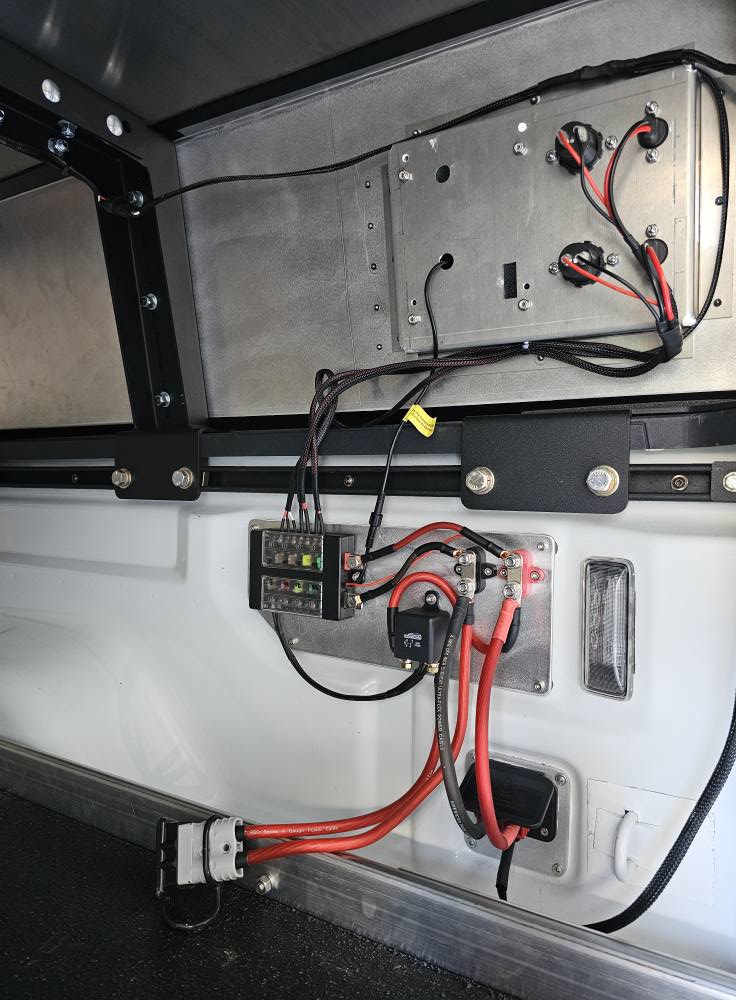

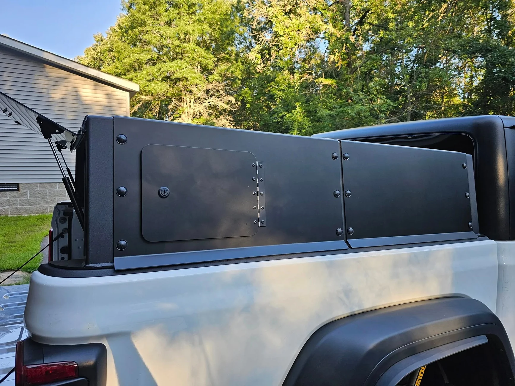

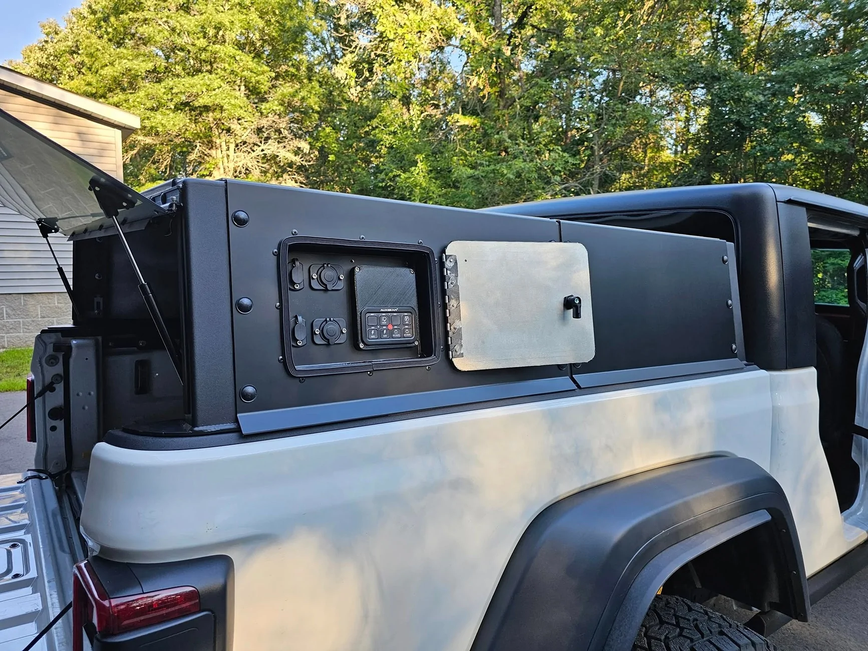

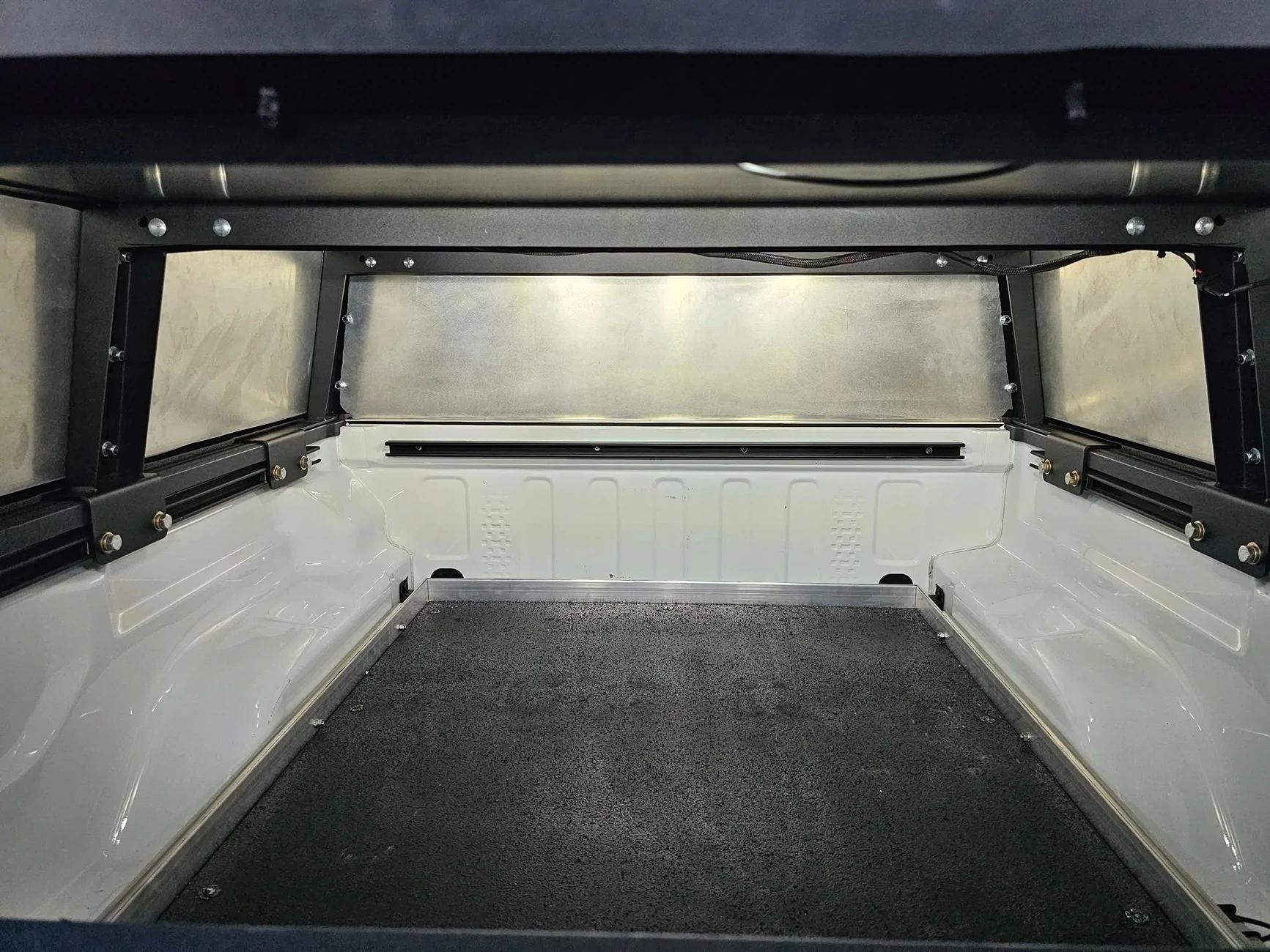

I also finished up the rear electrical. Used some .125 alum sheet I had laying around and cut a panel to fit the shape of the inner bed side and used rivnuts to secure it. Auxbeam and accessory outlets installed in the access panel I built into the enclosure. Exterior lights (once I get some), bed interior lights in both white and amber, accessory outlets and air compressor (SB120 connector) will all be controlled from the Auxbeam. Need to tidy up the wiring a little better, too spaghetti looking for my likes.
Auxbeam mount is 3dprinted from TPU. Not sure how long the TPU will maintain shape but this a temporary solution. My original plan was to have the Renogy battery monitor in here as well, hence the big wasted space above the Auxbeam, but after moving the house battery into the cab I decided it was easier to put the monitor in the cab as well vs wiring up an extension and plug for it, so now I have this big blank space glaring at me when I open the panel. I think I might re-print the mount in ASA and add an SB50 connection point. What for? No idea, but it'll be available if I ever need one. Or better yet, maybe a solar panel or trickle charger hookup. That would probably make more sense.

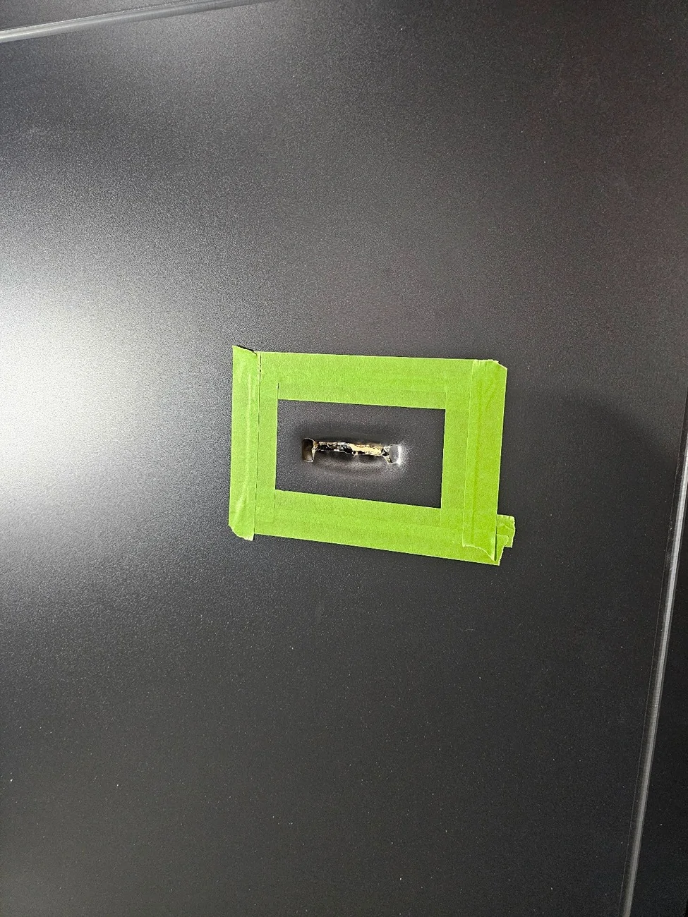

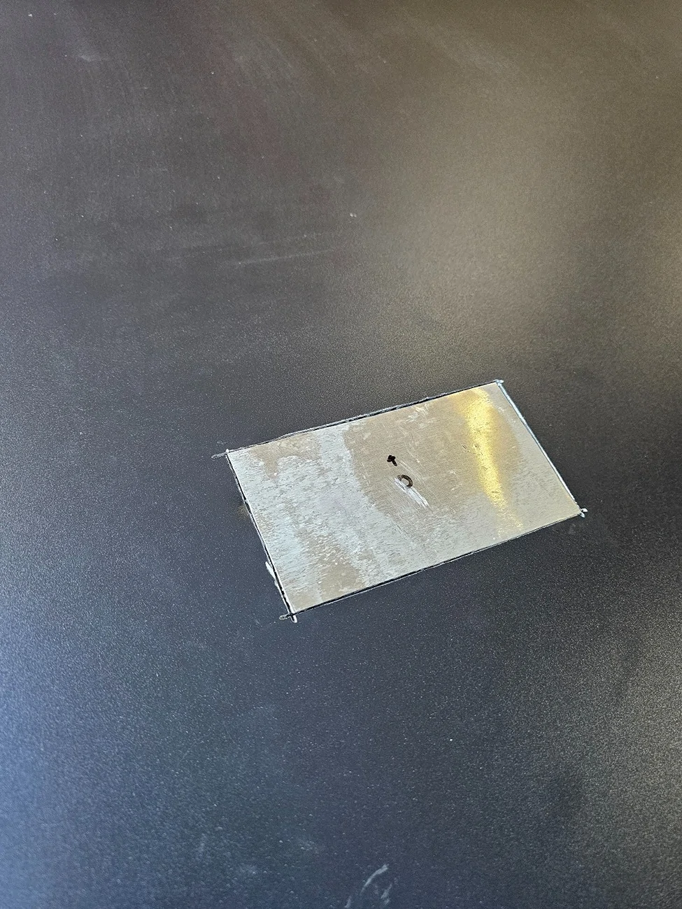

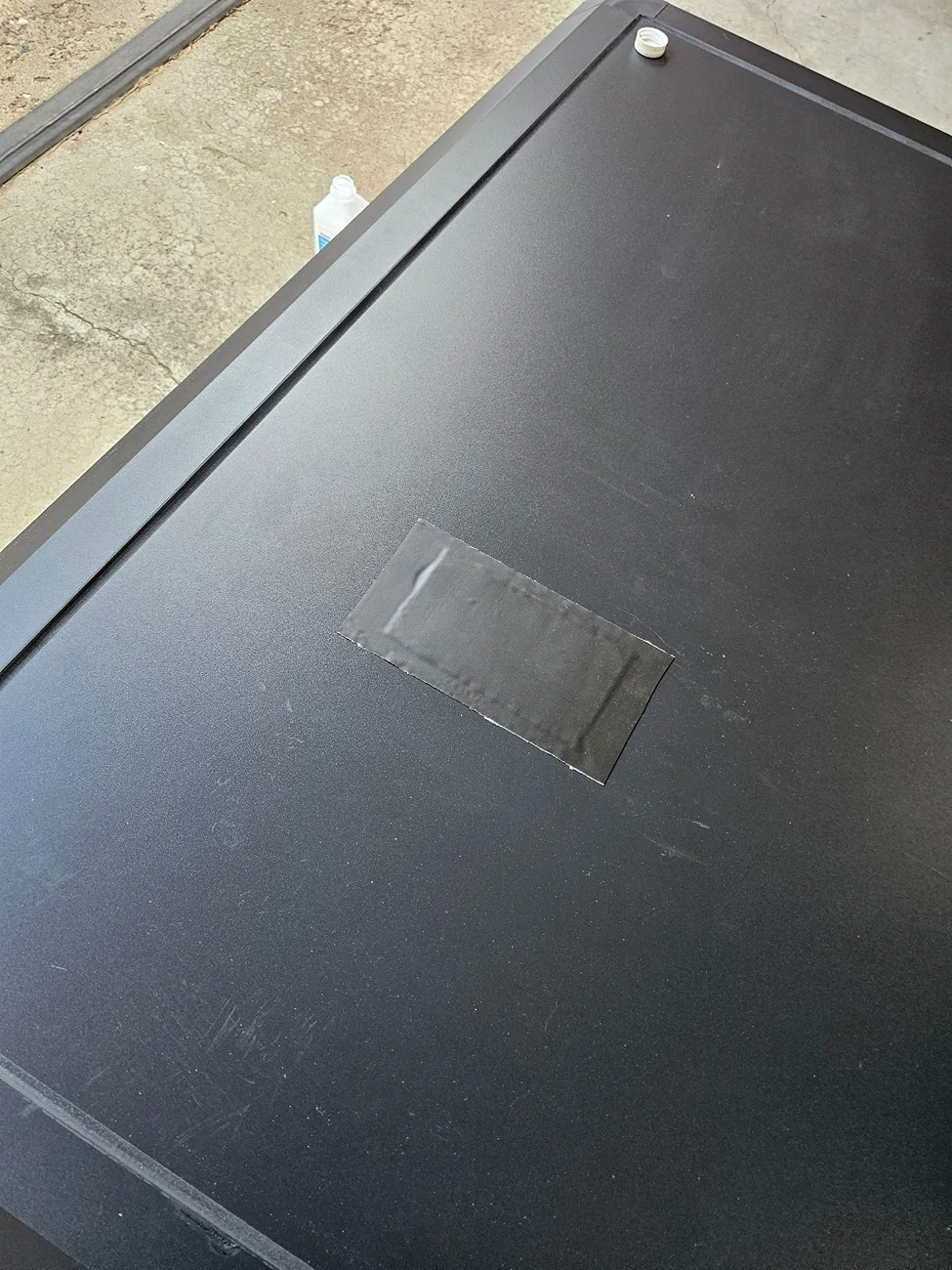

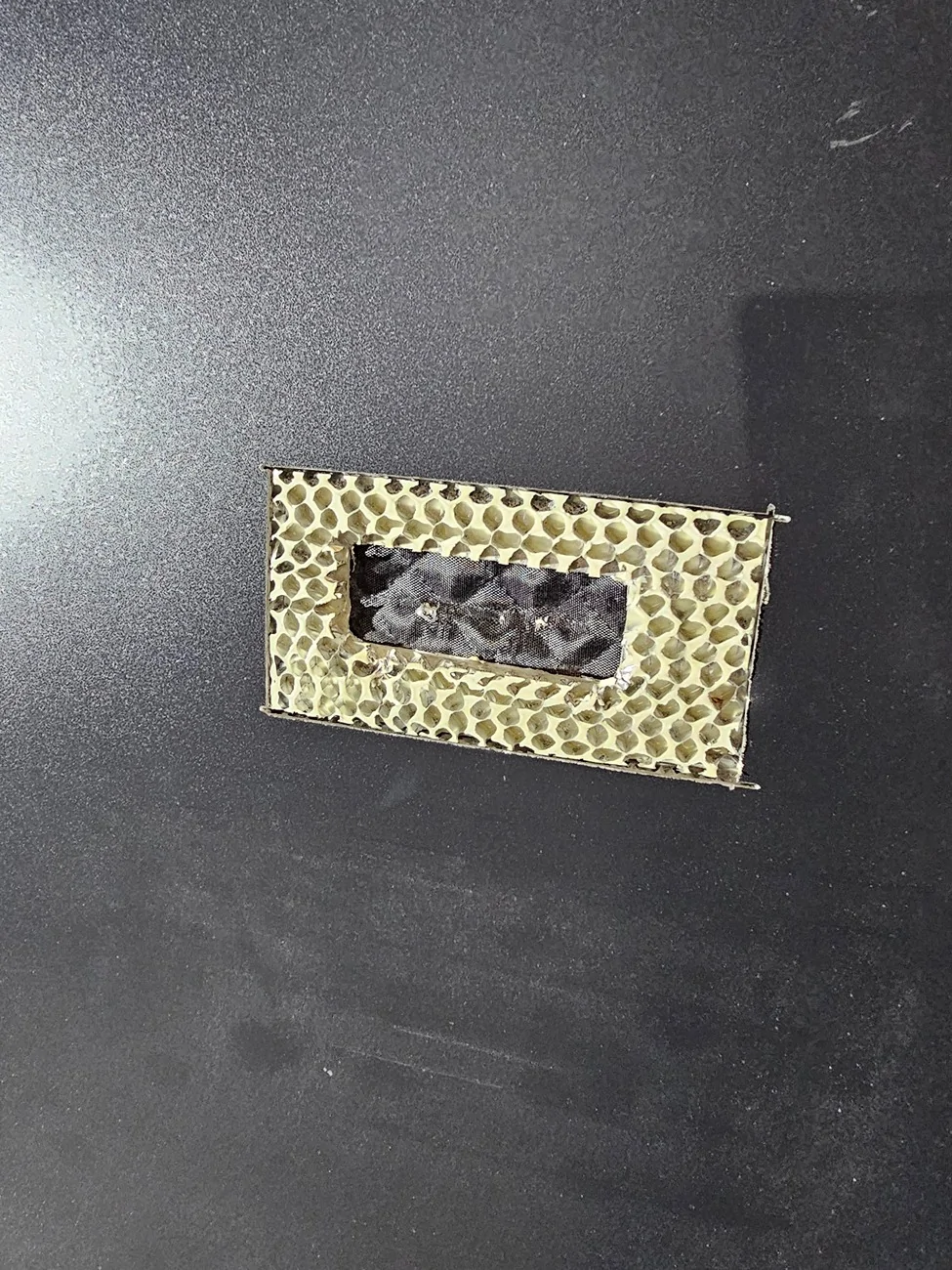

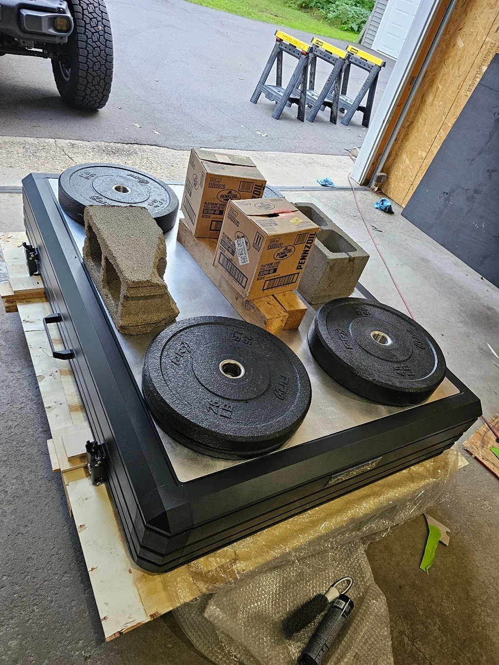

Patching tent underway...
Cut out the damage and used some .040 alum I had around the garage to cover the hole. I also 3d printed a filler piece out of TPU to replace the honeycomb that was cut out. Some epoxy to keep it in place and some butyl tape over top. Then had a panel cut out of .063 alum that was the size of the entire roof. Cleaned everything up, applied construction adhesive (store bought, didn't feel like waiting a week for them to send some), and now letting it cure for a few days. Will run some silicone around the edge and should be sealed up and ready to go. Hopefully have the tent installed this weekend.
Also measured the tent height. I was hoping to flat mount it to the rack, but they use a hinge that wraps underneath and needs about 1/4" of clearance, so I'm looking at about 11.75 inches height total, which leaves me VERY close to not fitting in the garage. Dammit. Might be building my own half rack sooner than I thought.

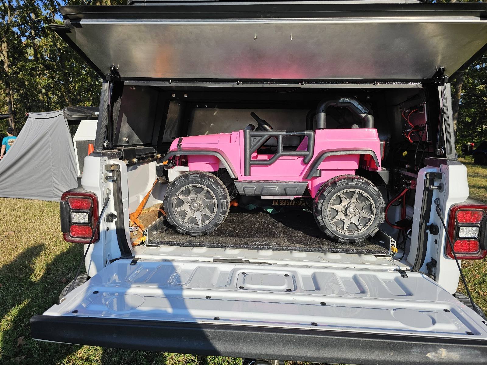

However, we DID win the barbie jeep race! The Deliberately Lost Outdoors "sponsored" barbie jeep piloted by my buddies "in-process of adopting" 15yr old son took first! So that was cool.

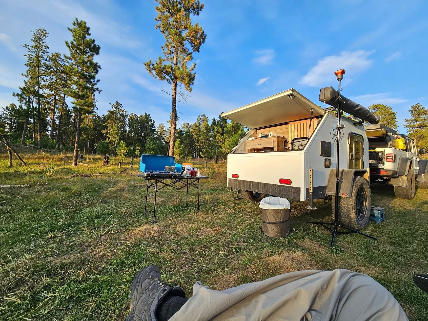

After another long day of driving we found a dispersed camp site in the Black Hills. Just an easy overnight spot before we head home in the morning.

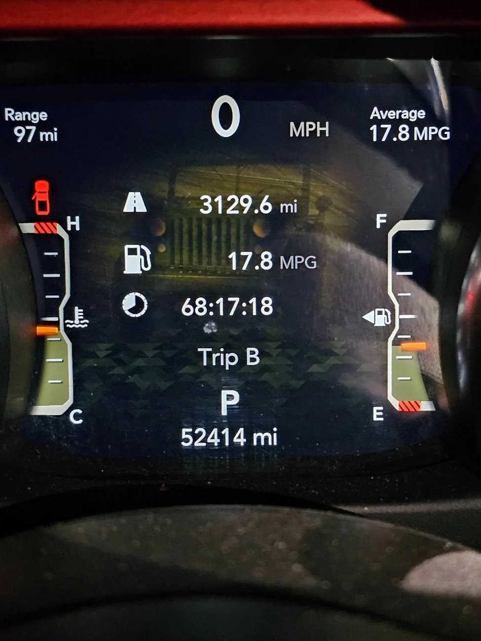

When we got home our animals were excited to see us. We got home around 8pm, unloaded any gear that needed it, and went to bed. Overall a great trip!
MN to OK - 16mpg average
OK to CO - 14.5mpg average
Entirety of CO - 20.2mpg average
CO to MN - 16mpg average
Gotta love the diesel!
