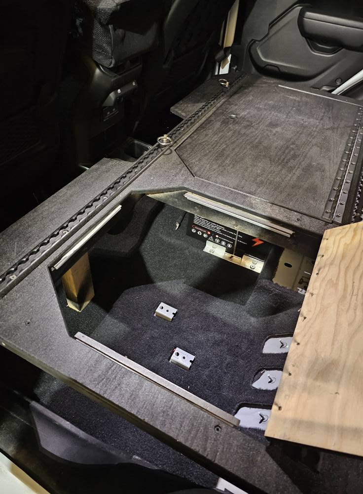

Should have some updates soon regarding the house battery system install, and some basic measurements for the rear seat platform.

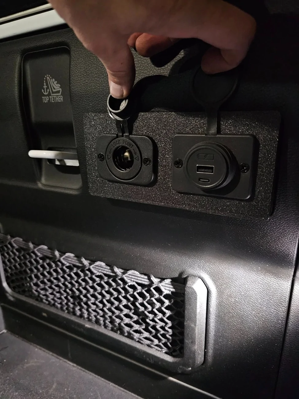

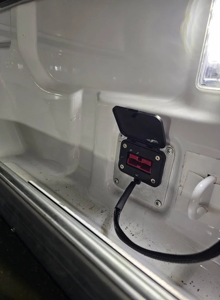

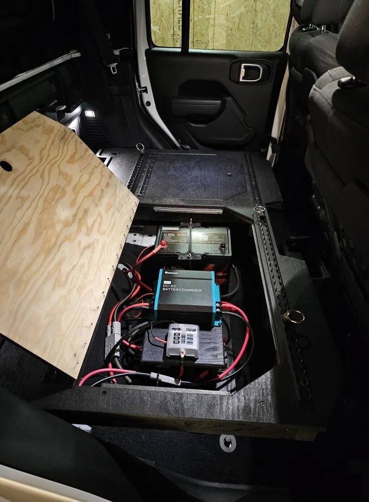

Finally got the house battery system 95% installed. I still need to build the electrical panel that will go in the bed, waiting on a bus bar to finish that. Everything ended up taking more space than I anticipated and I don't like seeing the cabling (even though its under the rear platform, so I'll eventually redo it all and hide the components, I just need to find a way to do so with everything still accessible.
100ah lithium battery, 20a Renogy DC-DC charger with monitor, Anderson plugs to make removal easy. Simple fuse panel in the cab for the 12 outlets and fridge. Electrical panel in the bed will have an Auxbeam for controlling everything else.

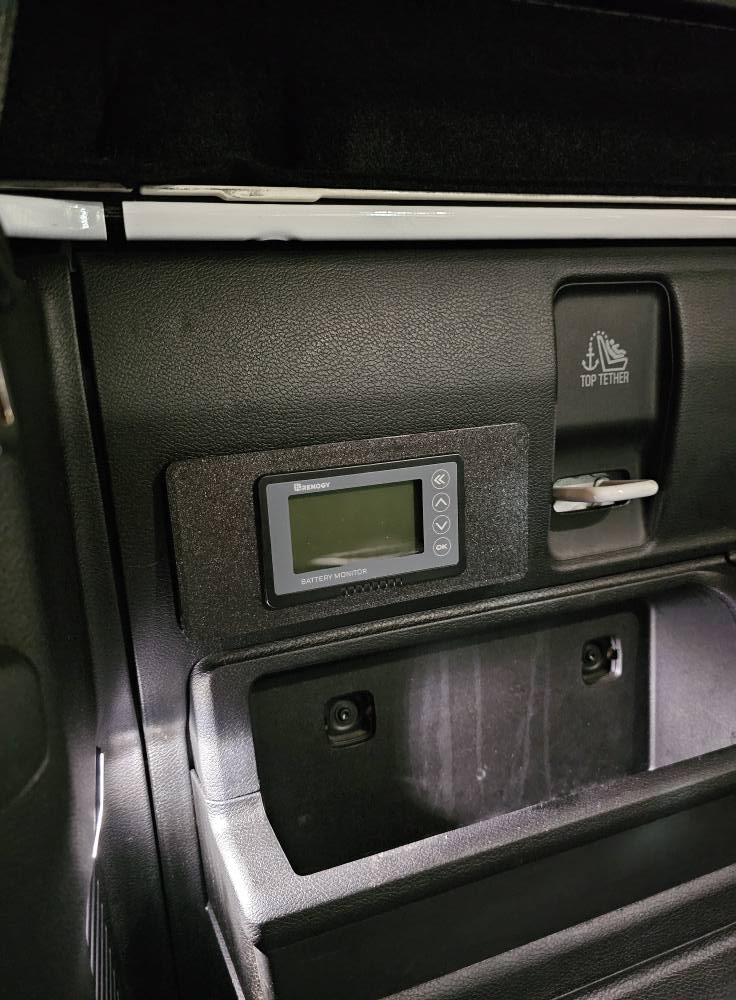

I 3d printed panels for the battery monitor and 12v outlets that replace the bus bar panels on the rear wall. They pop into place well enough but still felt like they aren't quite right, so I'm curious if they stay in place on the trail.

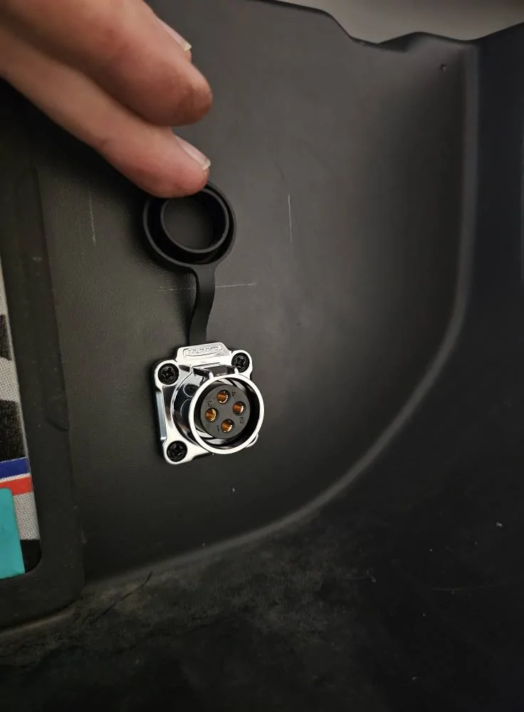

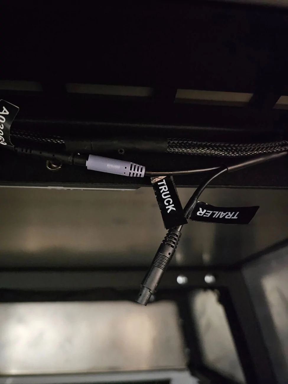

I also ran an extension for the Wolfbox camera down to a plug on the bumper so I can plug in my trailer camera. The Wolfbox wire is tiny and takes some finesse to strip and solder without breaking it. Unfortunately my dumb ass forgot to record what wire went to which pin, so I have to pull it back out, strip the heat shrink off and figure it out.

Love the build so far. I hope your panels work out as that makes for such a clean install!

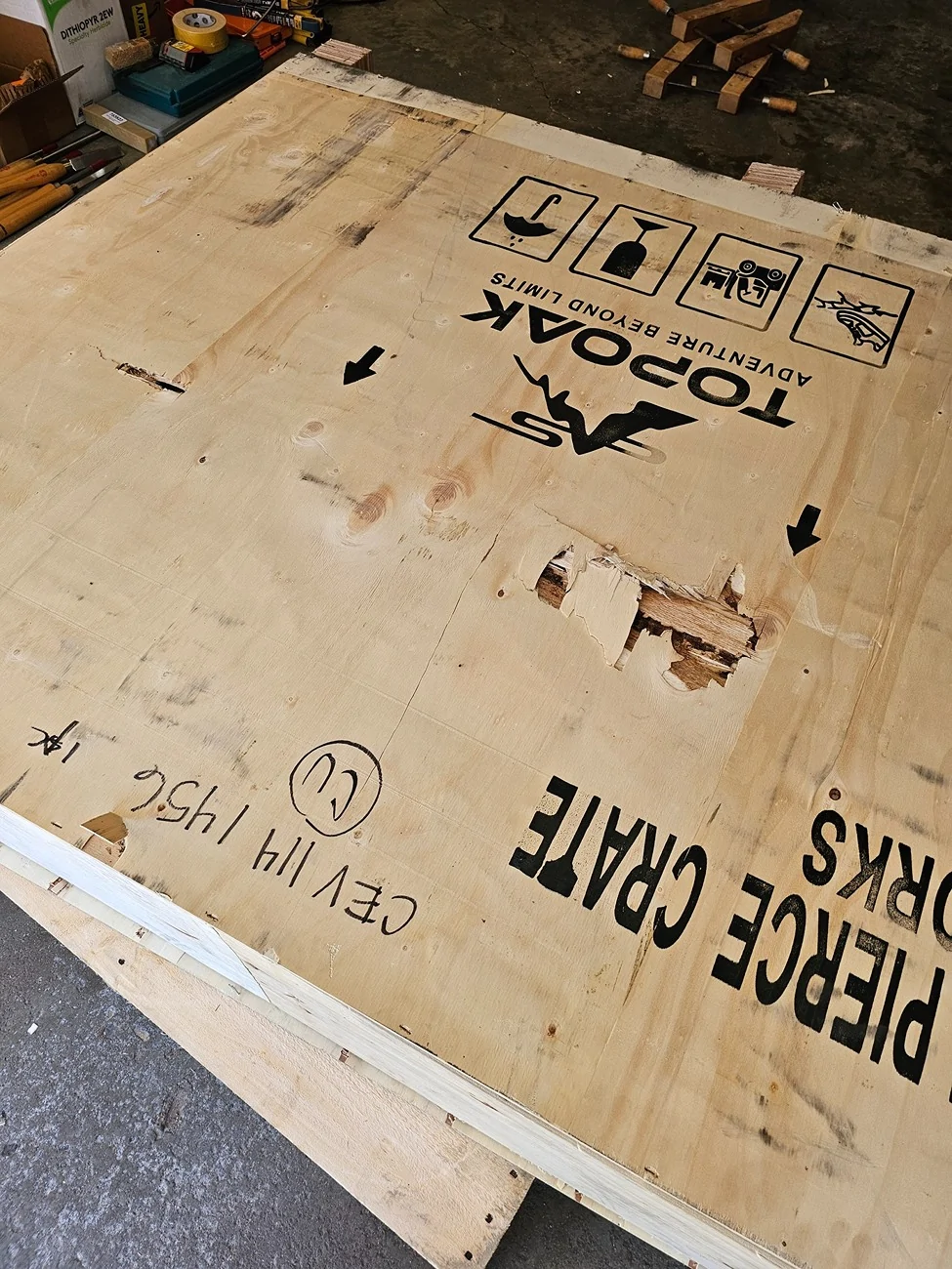

Damm- that sucks, sorry to see that. It's a toss up with these freight companies. Hopefully Top Oak makes you whole with no issues. I had a minor issue with mine, it was missing the support poles for the rain flys and they were on it, had them shipped right out to me.

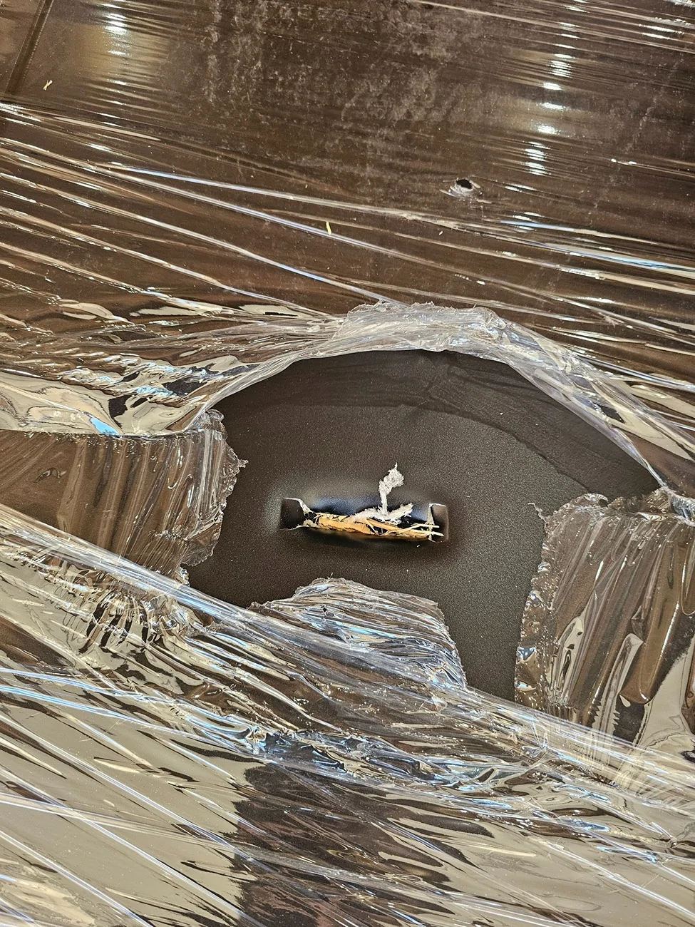

I have no doubts they'll make it right, it just sucks having to wait yet again after all the BS I've dealt with trying to get a tent. I was hoping to have a tent for Overland of America in a few weeks so I didnt have to drag the camper.
TBH it would be easy enough to patch. I've got the aluminum at home. Will see how it plays out, if anything I'll ask for some money back and patch it.

I emailed Topoak and pitched the idea of patching the damage myself. They emailed me back and thanked me for thinking of a solution that was a benefit for both parties. They offered $300 compensation and to send me structural adhesive to use when patching, and would honor the full warranty on all parts. I had told them I hadn't unboxed any farther than when I found the damage, so when I get home from work I'll finish unboxing and inspect everything, and if all looks good I'll accept.
It'll be too easy to send a flat file to my local steel shop and have a panel cut out of .040 or .063 alum sheet. Can even use white painted and it will help cut down on heat from the sun as well.
