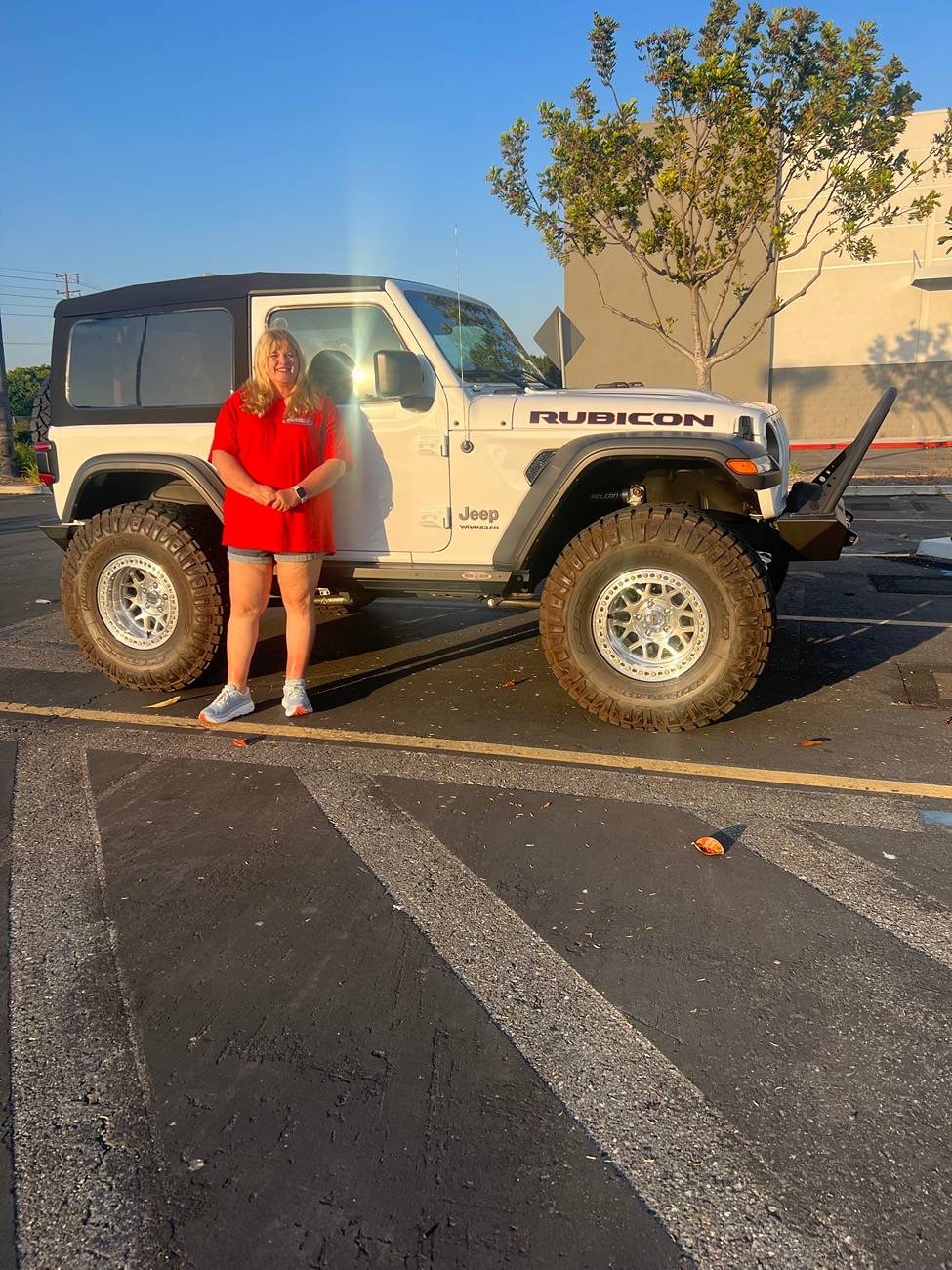

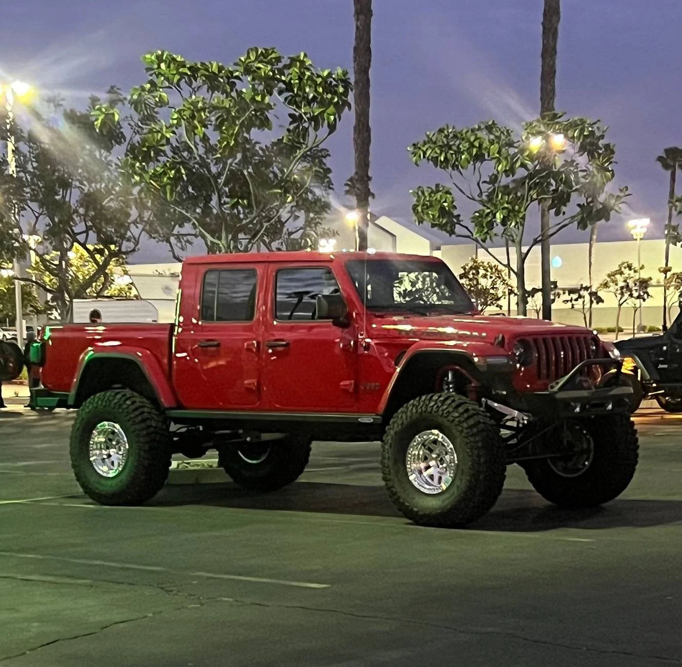

“””””””””That is a REALLY good price! I couldn't find that price 15 years ago. It was $2,000 an axle back then, and that was labor only.””””””””
I am guessing that Rebel / Revolution has their regear method down to a science with experienced axle jockeys that are fast and efficient.
[/QUOTE]
I believe it’s a crazy good price. I had a local hard-core 4 x 4 shop do my wife’s wrangler a year ago for $3000. I just had my gladiator done by Rebel last week for $1799 with 5.38’s.
