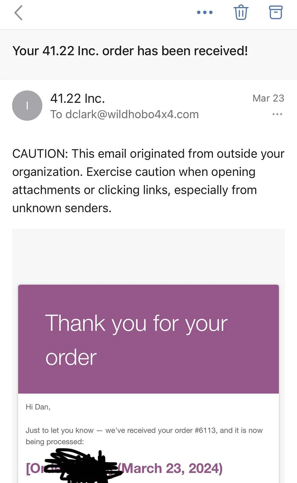

Yes and it was that email I replied asking why FedX doesn’t have the package yet. It was Easter so I understand holidays and catchup from the demand of other orders.
Tracking numbers can be issued a day or more before the company actually has a package. I see that all the time in this day of automation.
Seller prints a label, there's a tracking number on it, label gets put on box, box tossed onto stack of other boxes to get picked up by UPS or Fedex or whoever - and that could be 1 to 2 days, or a few hours, after the tracking number is generated by the seller printing the label - not even put on a box yet.

The “we received your order” email is my latest.
I had that email on the 20th. Then on the 28th I got another from them with the confirmation and FedX tracking number attached. Your first email is 3 days later than my first one so you should be getting a tracking number any time now I’m guessing.
Sounds good. Thanks. That’s why I asked someone who had ordered from them as well.

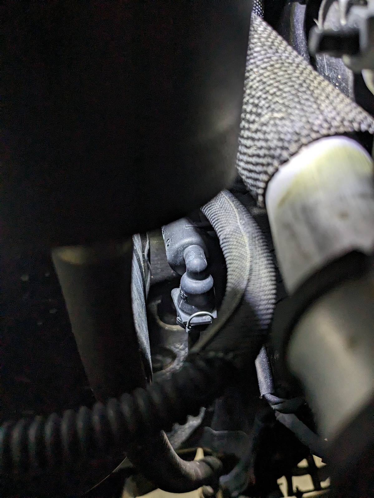

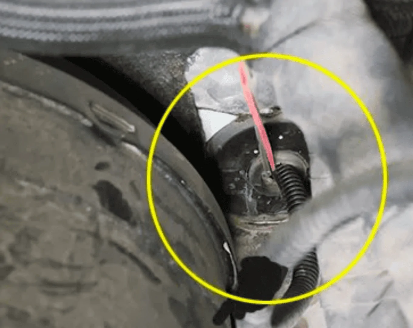

Mine showed up yesterday. Installed last night and it works as advertised. Check orientation of the relay, and rotate 180° if it doesn't work. Only thing different for myself is that I have a MT so the easy access firewall grommet that's in the instructions, is filled by a hydraulic clutch cylinder. Went through the A-pillar next to the drain tube and then into the cab.

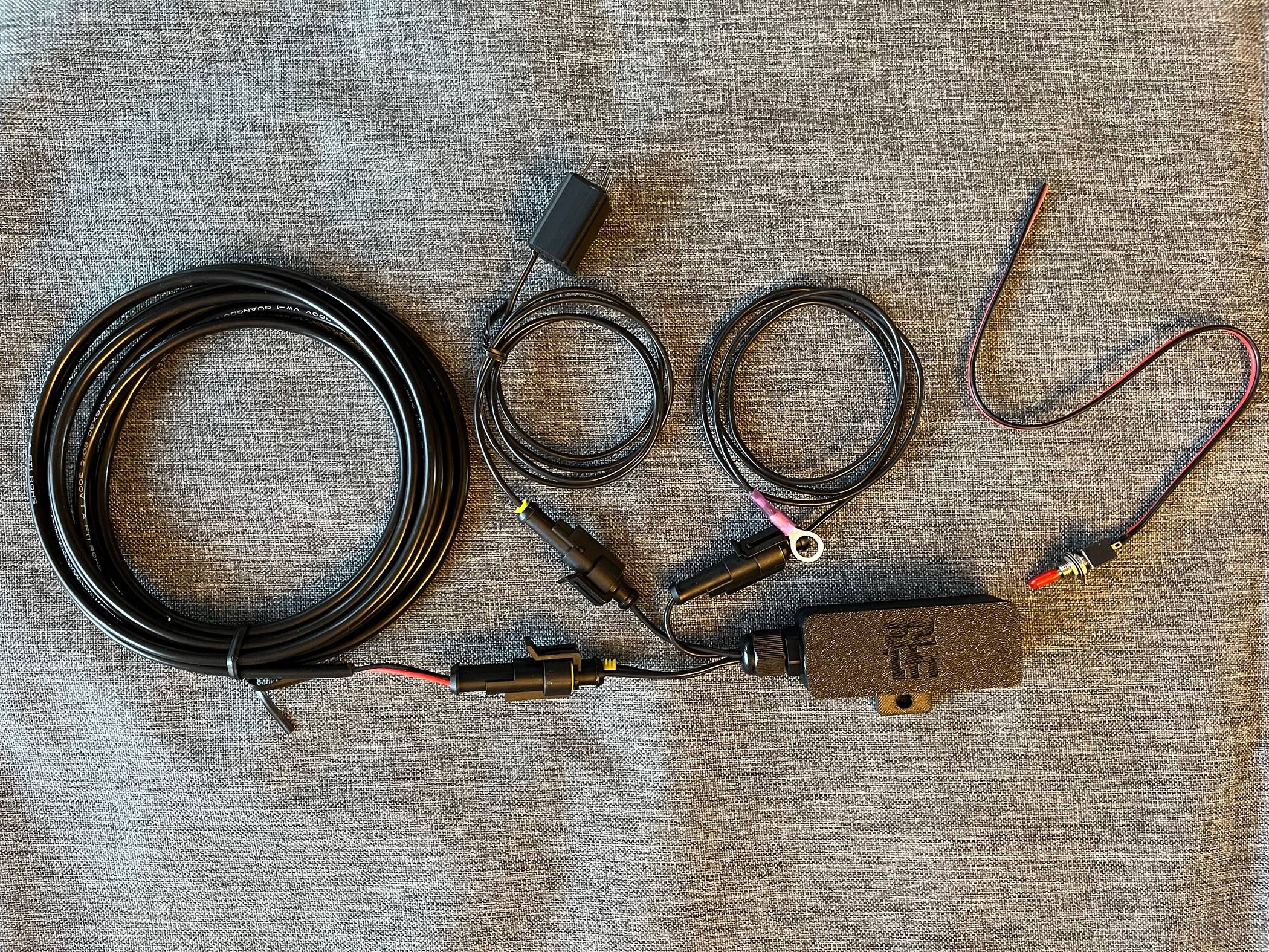

Mine is coming . Can someone tell me how long is the switch wiring and what gauge the wire is please .

The switch wiring is pretty long, but they don’t terminate it so you can lengthen. I’d say it’s 16-18awg and easily 10ft or more.

I stretched mine out and measured for you. The ground and module wire are both 3’ long and 14 gauge. The switch wire is 10’ and 20 gauge.
I would carefully look over all the water seal connections and even the silicone seal on the control box lid. I had to fix to of the connections and I’ll be redoing the control box silicone. As shipped to me, it’s not good enough and water would get in for sure.
