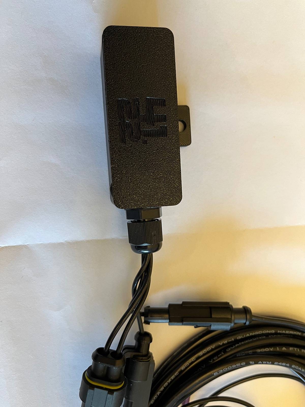

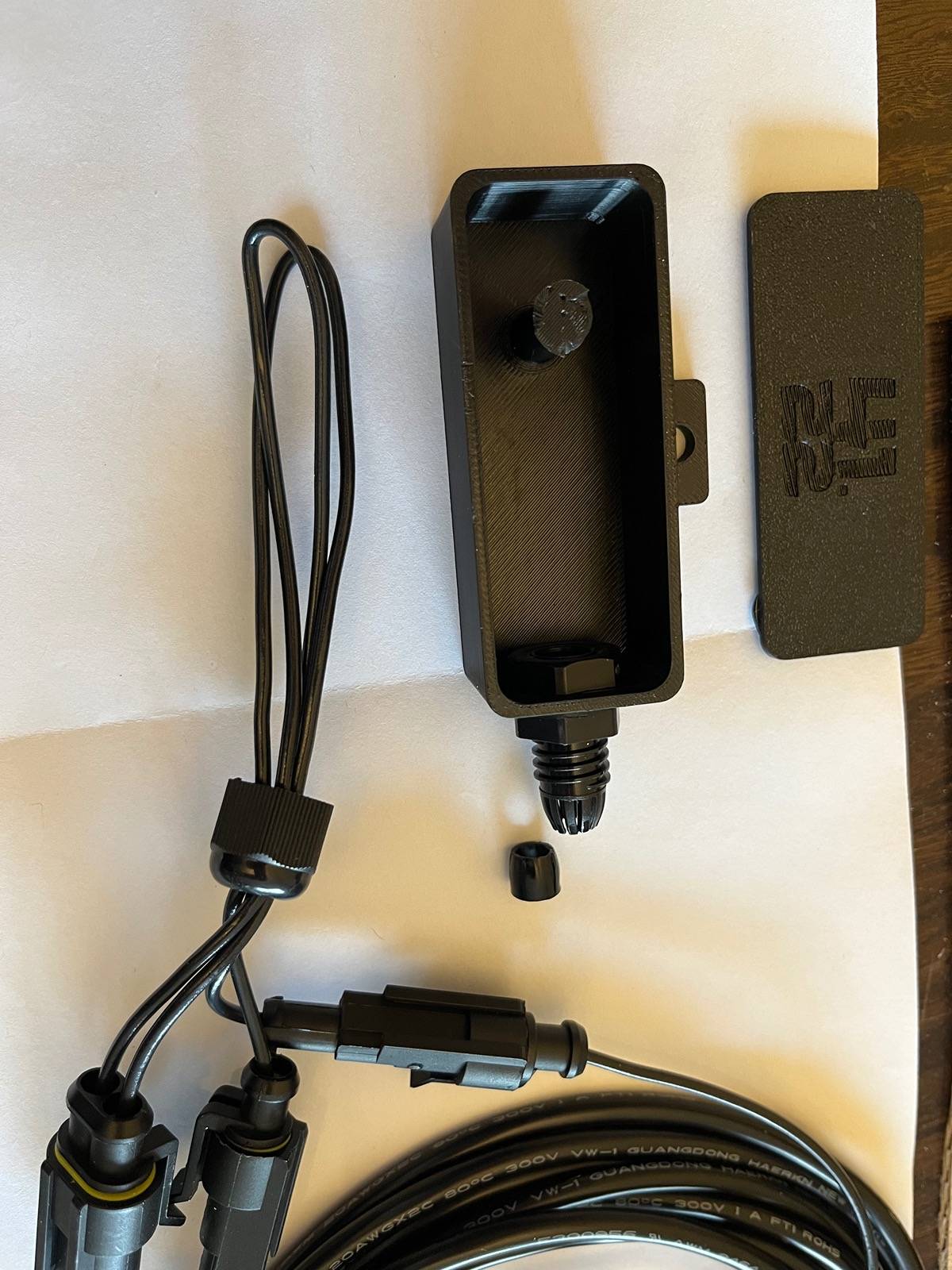

So you all know that neat little “control box” with this kit that’s screwed in somewhere under the hood and in my last post above I mentioned I didn’t like the silicone seal on it lid, well curious George reared its ugly head and just had to take the lid off to see whatever it is I would see and can someone tell me what is the point of this box from the photos?

That’s hilarious. I might just cut it out. I certainly wouldn’t be very worried about the lid seal. It’s just a service loop of wire. Funny stuff.

The relay is the whole thing. The box was 3d printed I think. When I have time the box is going away. And I agree. The connectors are getting replaced with heat shrink solder connectors.
