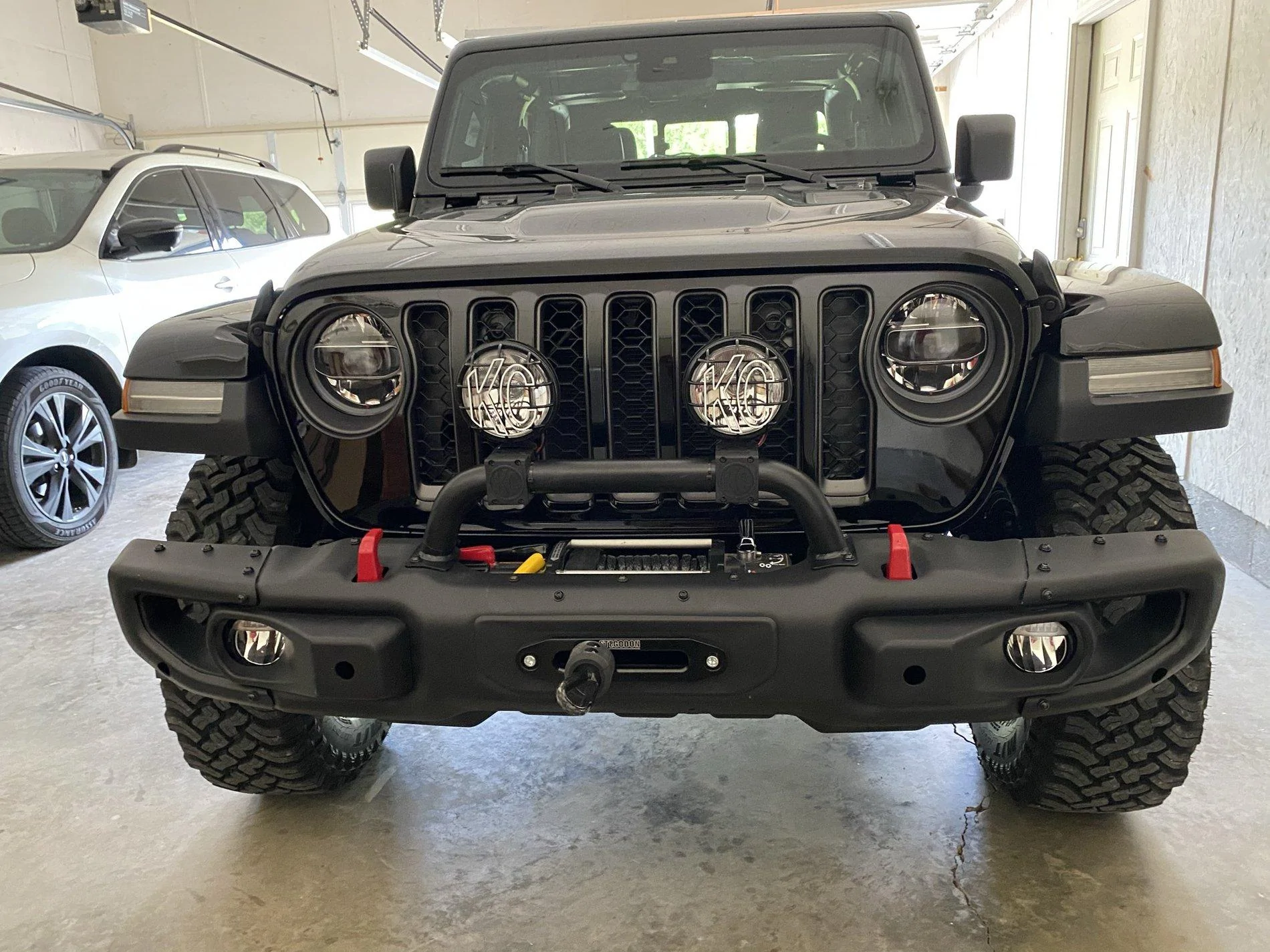

I just installed one of these bumpers last weekend. I swapped out the tow hooks because the ones included with the bumper would chip at the slightest thing and didn't look as finished as the originals. I also opted to use the included brackets to install my factory LED fog lights. The ones included with the bumper look nice though. The light mount also got repainted because I wasn't thrilled with how it looked. I used body shims between the back of the winch plate and the frame mount to push everything out as my winch was really tight to the grill (about 1/16th clearance). The Rubicon skid plate also benefited from the spacing. I did trim the bottom back edge of the bumper a tiny bit to get the skid plate to tuck a little better. I also drilled new holes for the top bolts in the skid plate rather than start butchering things with the wheel-o-death. I have factory fog light bezels on order if Quadratec will ever ship them.
Overall I'm pretty happy with how it turned out. It's a BIG improvement over the factory plastic bumper.

Looks great!

I really like how that looks on your friend there. NICE.
I have seen where several people used their original hooks because of the finish - why not?
Some have even said the LED fog lights that come with the bumper are decent - I'd use my own since they are LED and keep those as spares, perhaps, if I were to go this route. (and not being able to find a take-off, this may be my only option)
Nice - the bar, all of it, compliments that Jeep.
