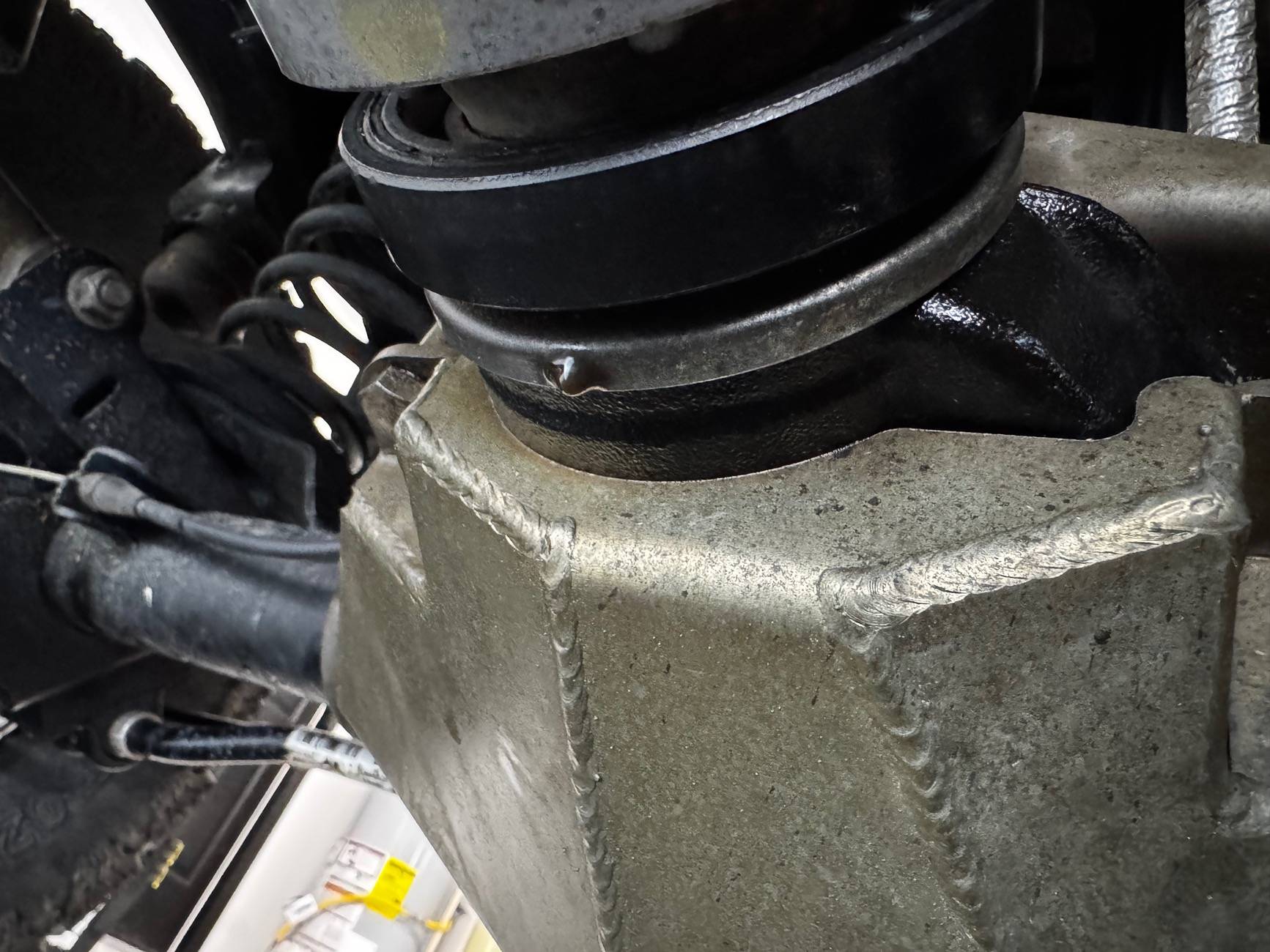

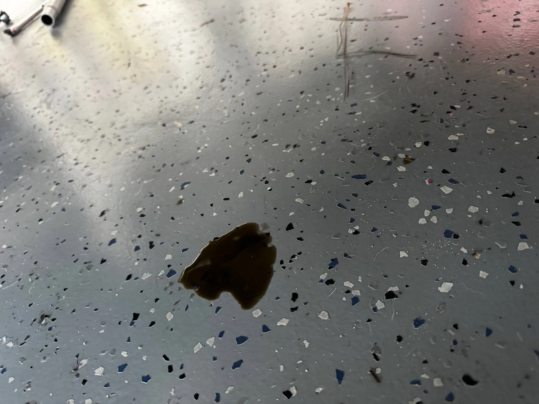

Cleaned everything up, added oil to the differential and almost immediately it started leaking out of the pinion seal without even moving the truck. So yeah it’s the seal.
That’s a hell of a leak. So glad you got gas at that time. You saved your diff.

That’s about 2 minutes after cleaning and letting it sit, cleaning it again, and letting it sit. About that much each time.
