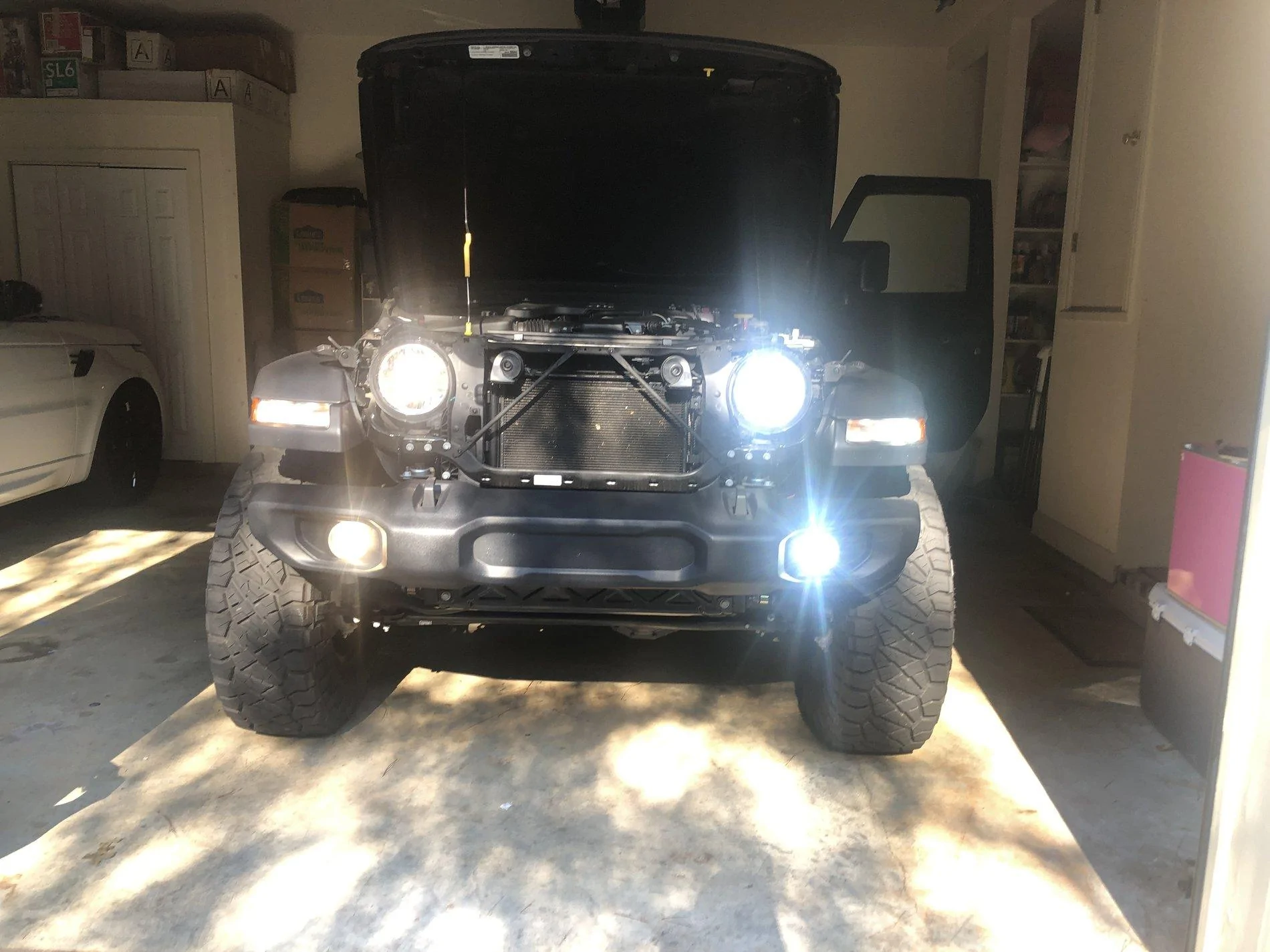

Replaced my bulbs using links from page 1 of this post...easy install and very big difference.
Thanks to the OP!

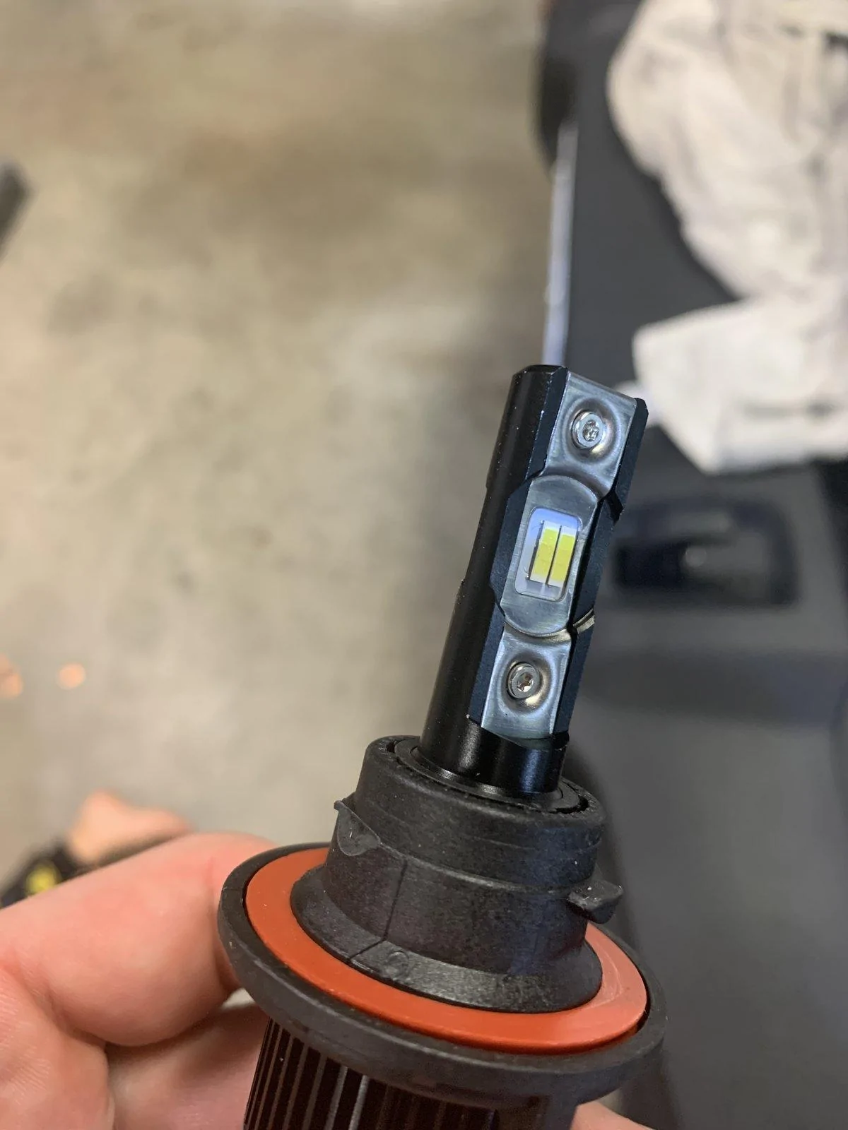

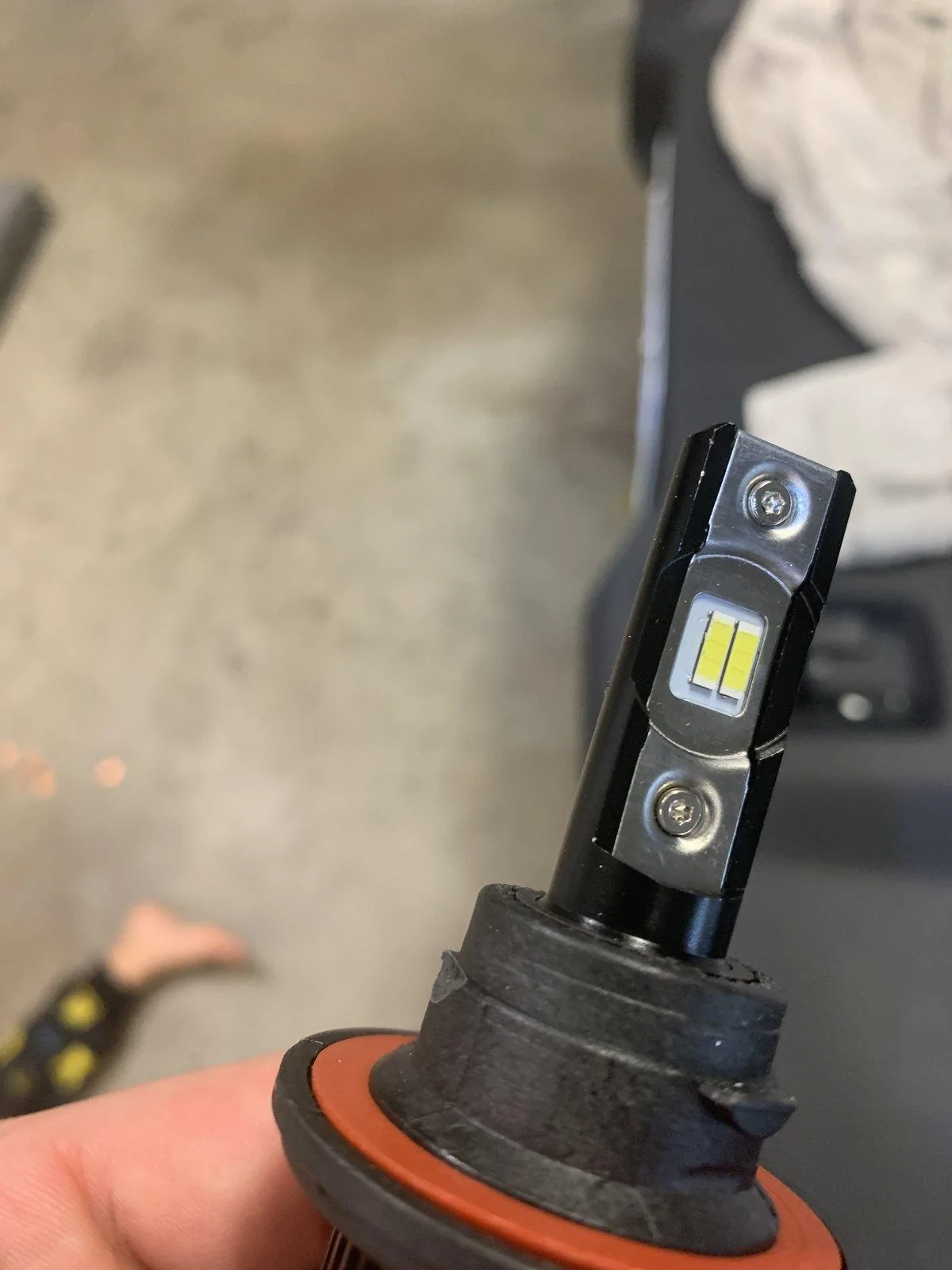

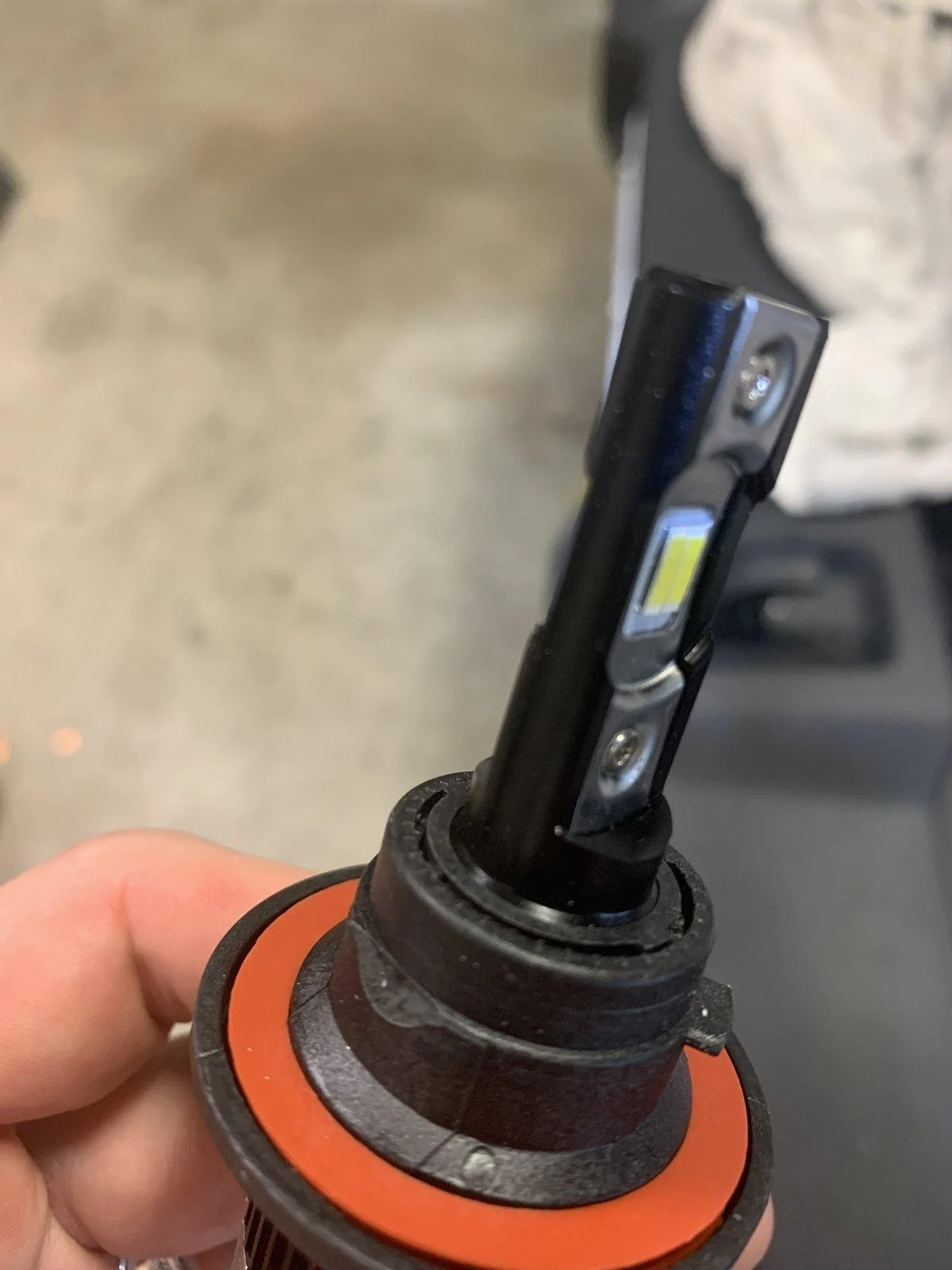

Just got these from amazon today. Popped in the first headlight... when tightening one of the three tabs broke.
won’t be ordering these again...

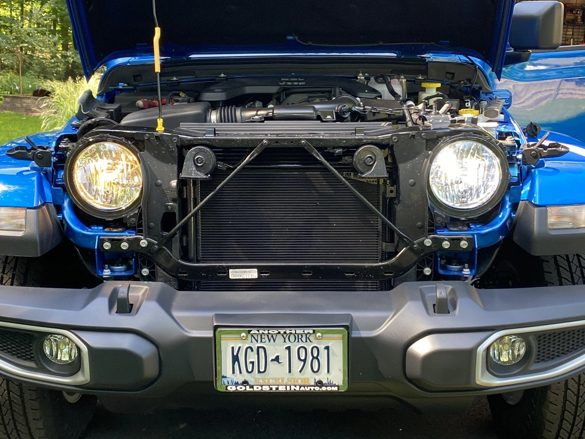

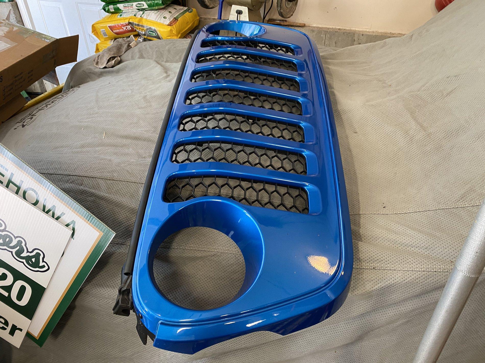

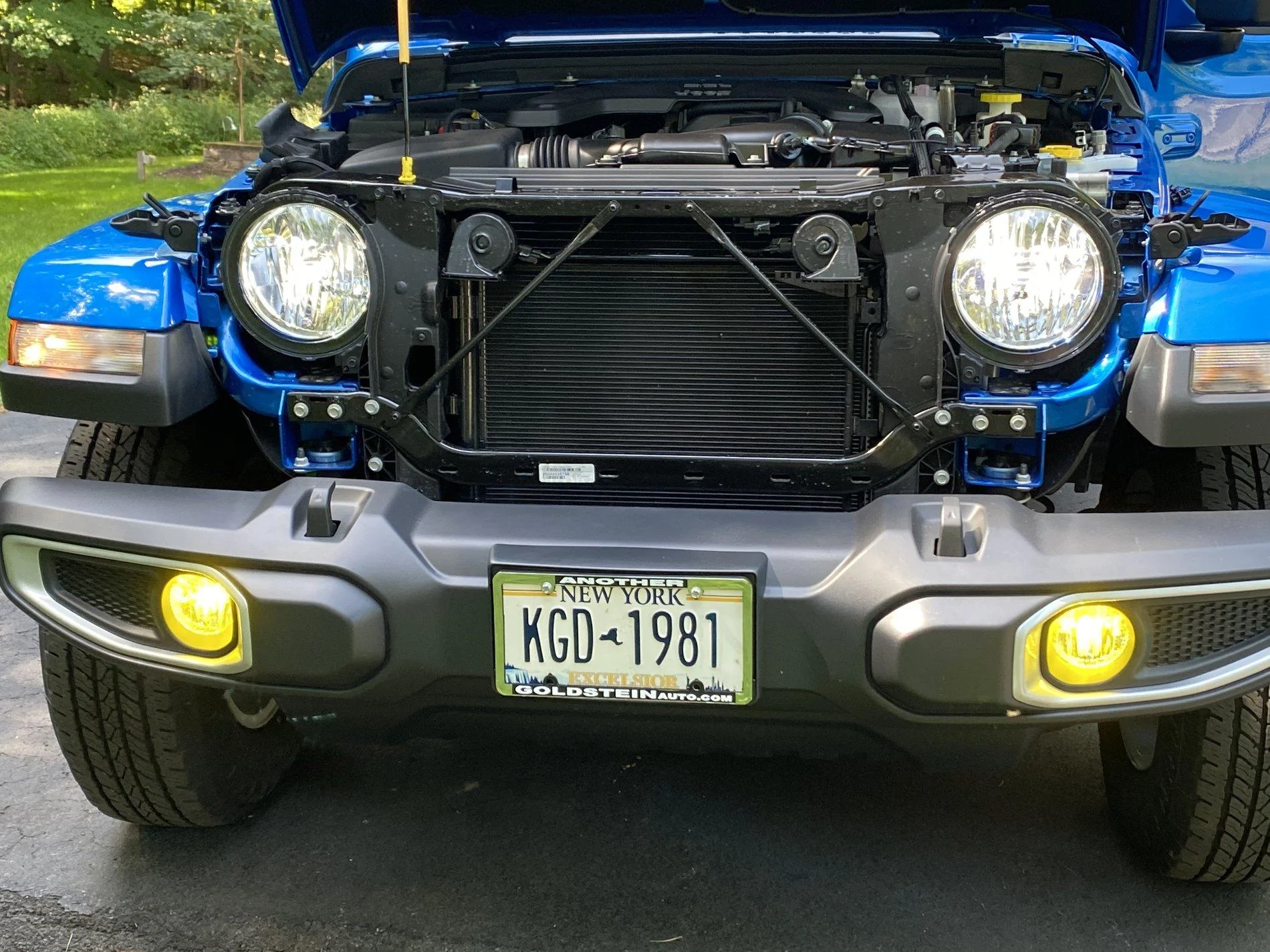

oDo you have to tear the grille an everything out to replace the bulbs on the headlamps etc? Sorry if its a redundant question. Waiting for my Gladiator to be delieverd but want all my parts at the house so I can start modiying right away
THanks
srmorse
Saul
Aug 6, 2020
Ballston Lake, NY
2021 Gladiator Sport S (on order)
THanks
you don’t have to pull the grille...but it is ridiculously easy to do and easier than pulling the intake. I just did this and it’s my first Jeep and I was skeptical...but a few plastic clips and grille pops right out. I did my headlights, fogs, drl and turn signals following this thread and total time was under 90 minutes. Next time around I suspect I could do all in 30-40 minutes.good luck on your delivery...waiting sucks but it is worth it!
THanks
Yes, but it’s very very easy! Basically there are around 6 plastic snaps to remove from across the top, and then you can slide your hand down the the back of the grill and use outward pressure to pop the bottom out. It’s only held on with clips. It’s literally a 5 minute job at most to remove the grill.

I didn't need to activate anything in mine for them to work. The headlights are H13 and I don't think the Hikari ones are available anymore. As far as DRL and turn signal go these are the ones for that
Turn Signals
https://shop.advanceautoparts.com/p...ed-mini-bulb-pack-of-2-7440aledbp2/11236880-P
DRL
https://shop.advanceautoparts.com/p...-led-mini-bulb-pack-of-2-7443slbp2/11349241-P
Foglights I used these
https://www.amazon.com/dp/B01H8CAC5K?ref=ppx_pop_mob_ap_share
I've been running those with zero issues. As far as my Jeep it's a Max Tow so it already had side LEDs in the rear and interior LEDs. That may be why I didn't have to flash mine for them.
I broke one of mine also. Ordered these from Amazon for $7.99 "HIKARI Replacement Bulb Holders - H13/9008"
