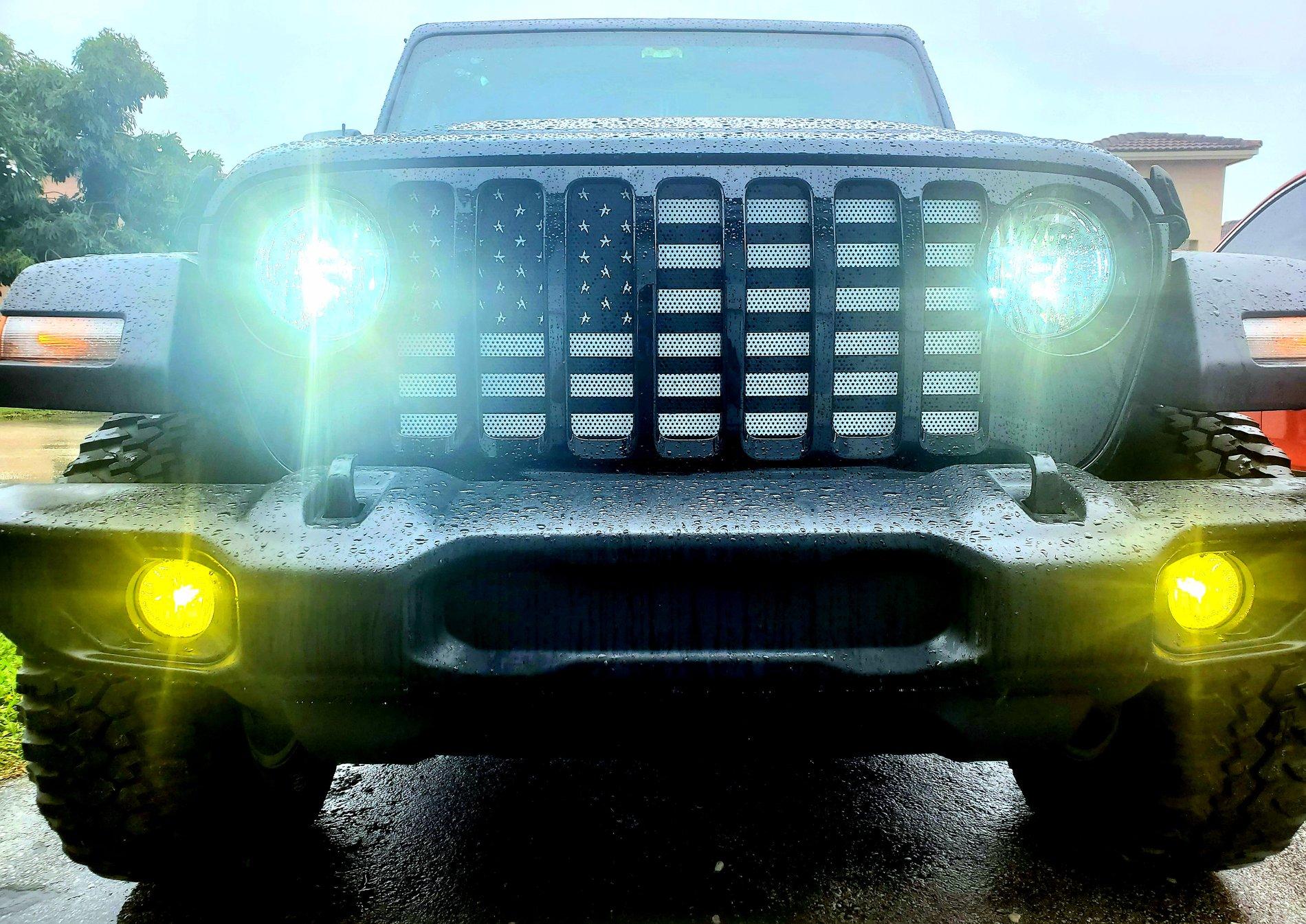

Fortes89
Jose
May 22, 2020
39
Miami
2020 Jeep Gladiator Sport S
Customer Service / Sales / Fire Protection
Used the links on this thread and installed today
Jeep Gladiator LED Bulb Replacement - IT WORKS! 20201003_141431
