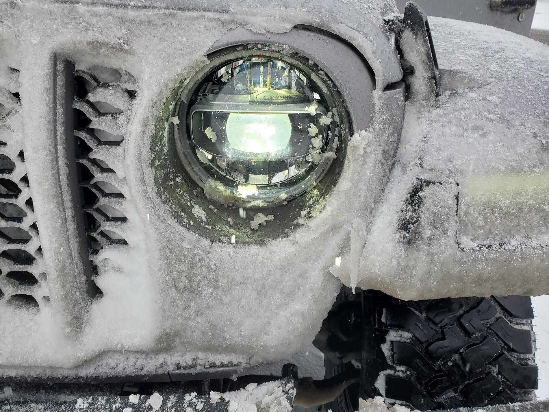

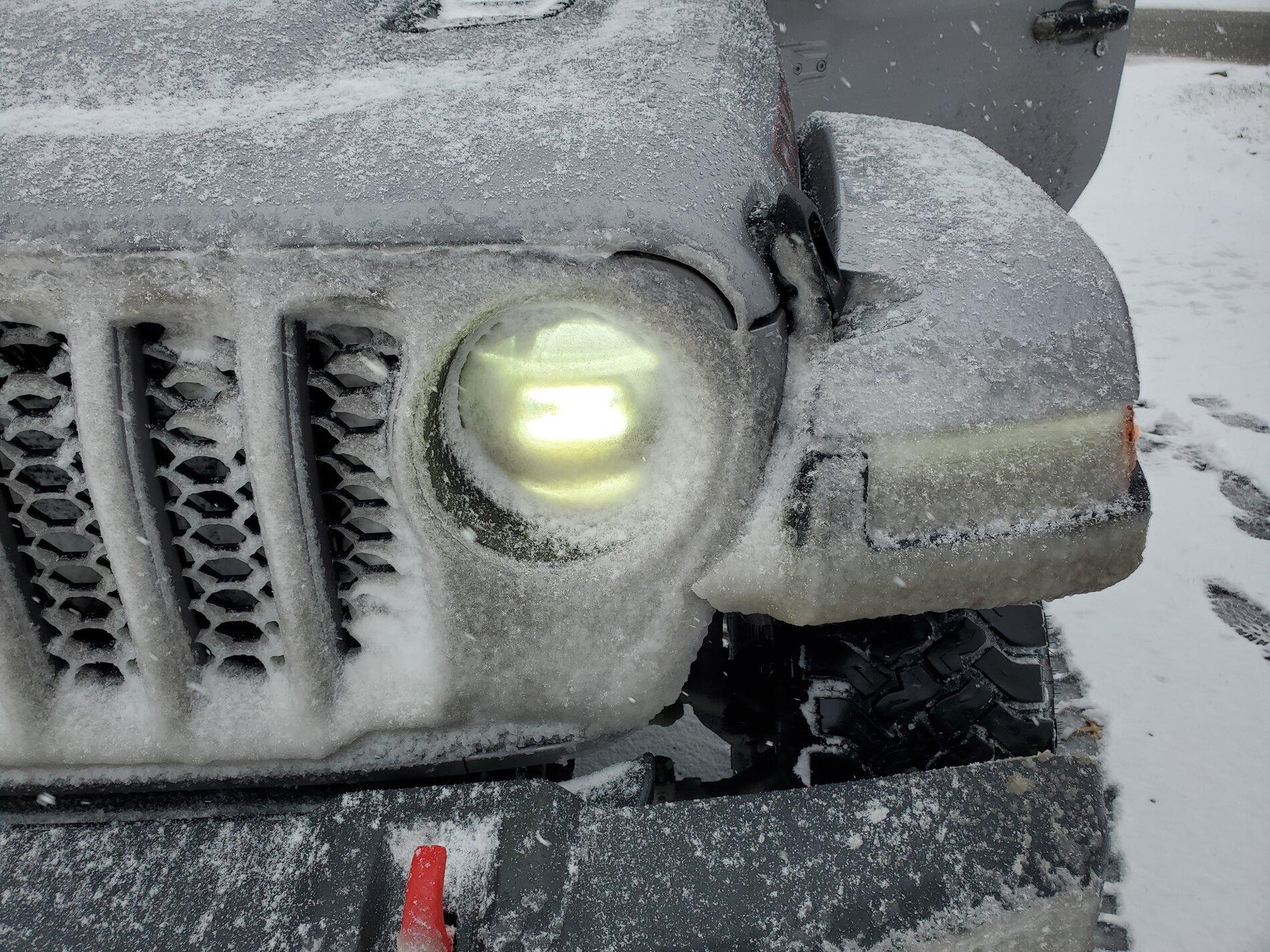

I got reminded again today how awesome the factory LED headlights are, I'm glad it wasn't night time.
Jeep Gladiator LED Headlights are dangerous in snow/ice storm 20201216_123202
After I cleaned thrm
Jeep Gladiator LED Headlights are dangerous in snow/ice storm 20201216_123212
Welcome to almost every stock LED light in the US (minus the recessed portion lol).
