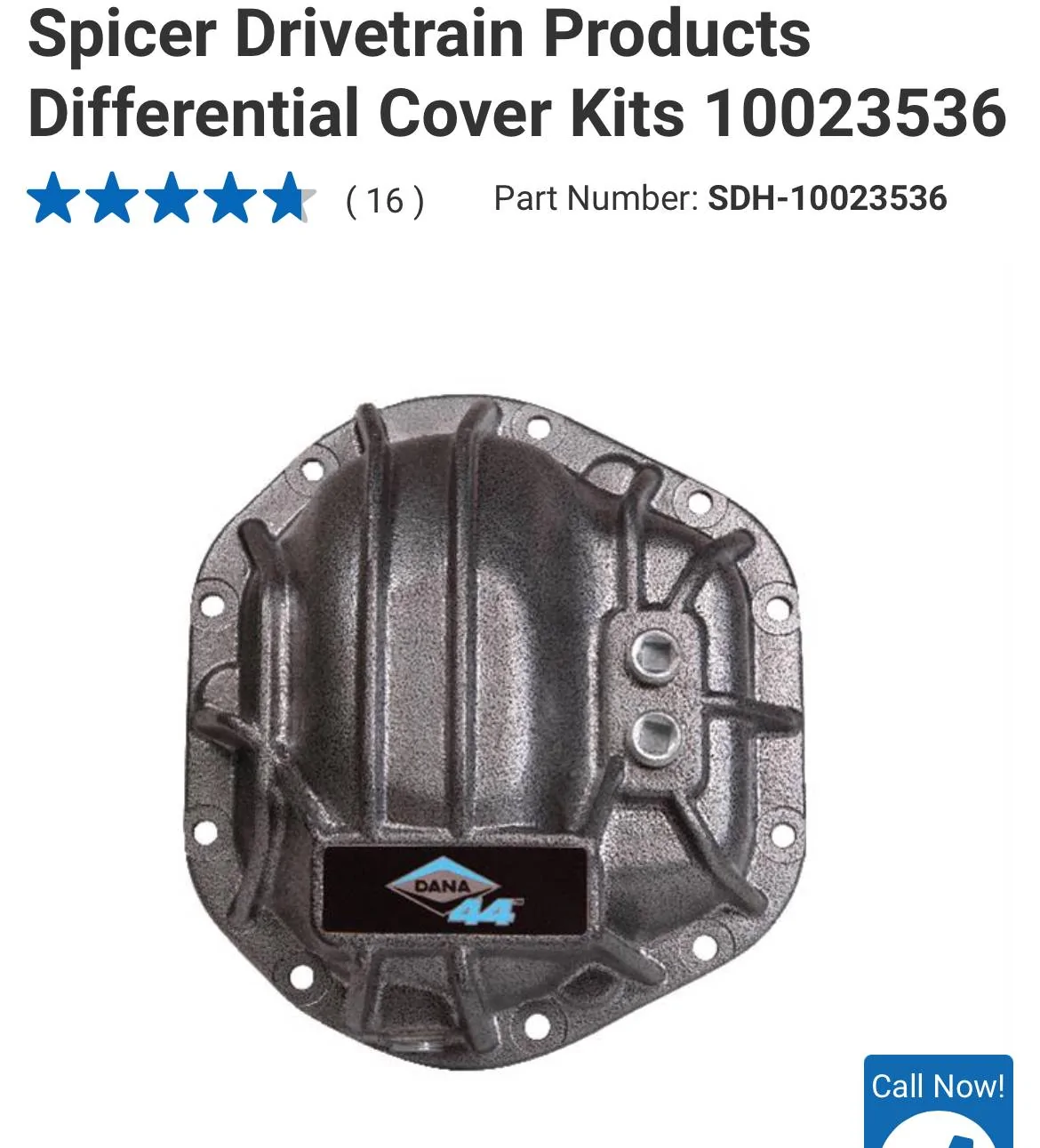

I went with Spicer (Dana) … they fit and look great! Very heavy duty !
If I replaced my cover, this is what I’d go with. Their differential, their cover. Just my preference.

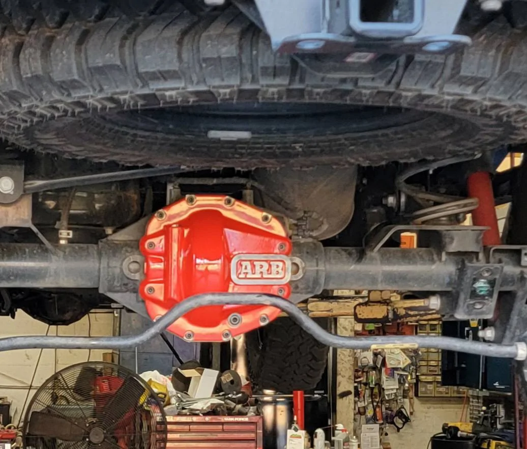

What I didn't like about the stock cover was that there was no drain plug, and no drain plug with a magnet! So I went with ARB for the rear diff at about 23000 miles.
Picture was taken during installation.
This has a bottom drain plug with a very powerful magnet. It has a dip stick with another powerful magnet on the bottom of it as well. The bolt holes are recessed to prevent damage to the bolts from being dragged over rocks. I think this cost about $230 or may have been a little lower.
I'll replace the front cover with the same type ARB cover around 40,000 miles or so when it's time to replace the fluid up front.
I agree that a drain plug would be quite nice. At least my housing still has one.
