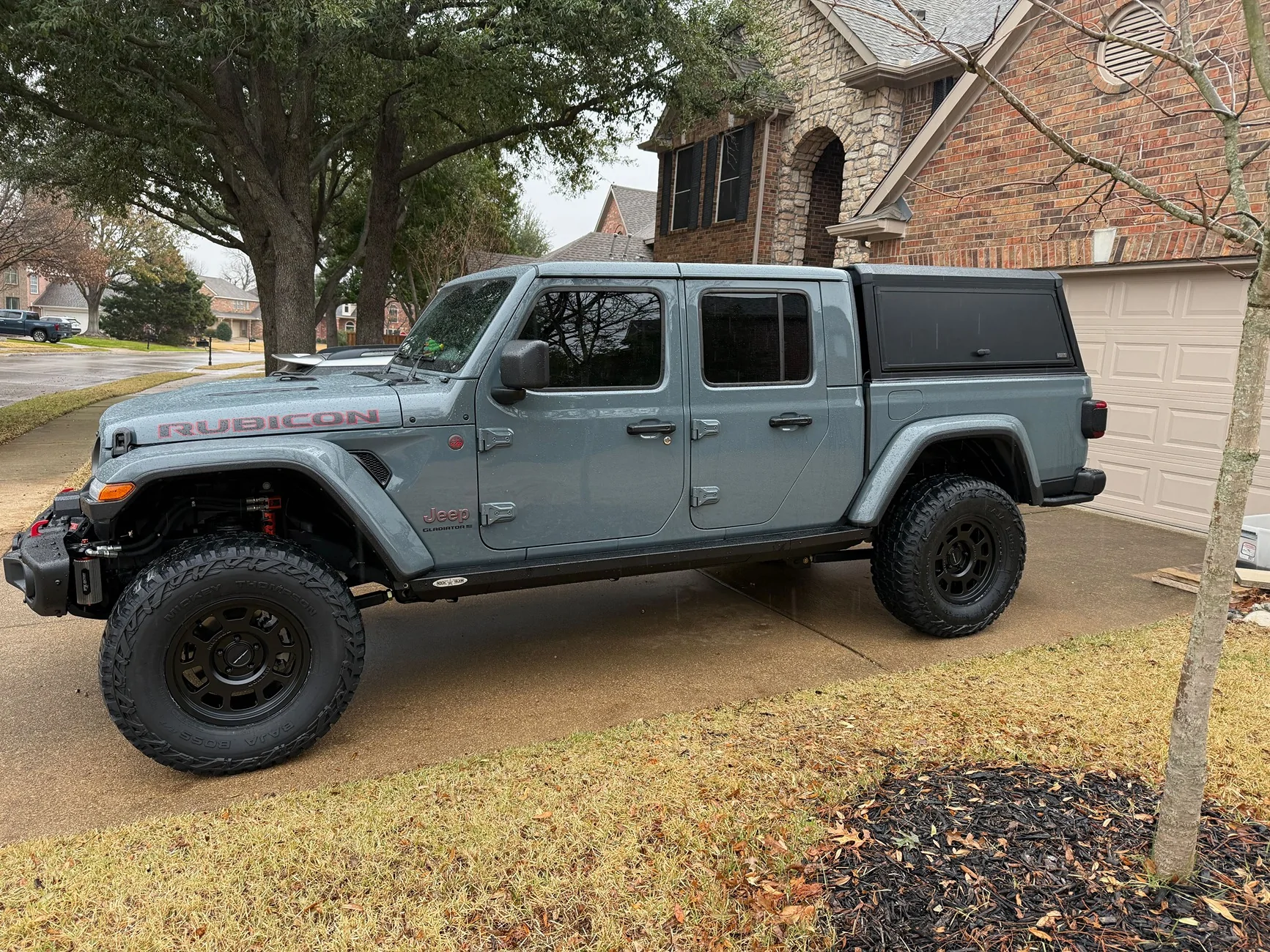

I have 35's under mine with the only lift being a leveling spacer up front to get rid of the rake. Be advised that I do have minor rubbing at full lock when hitting bumps.

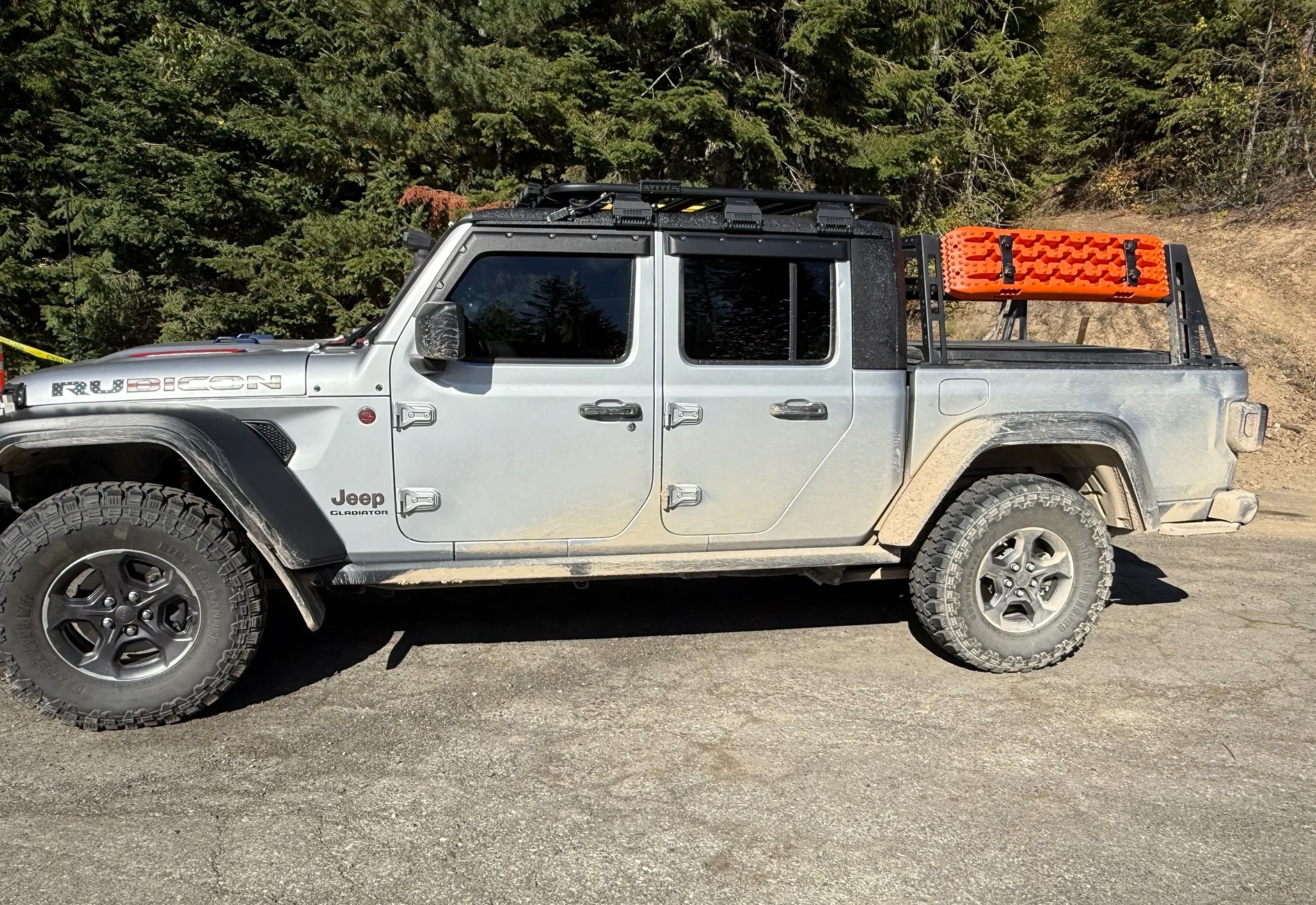

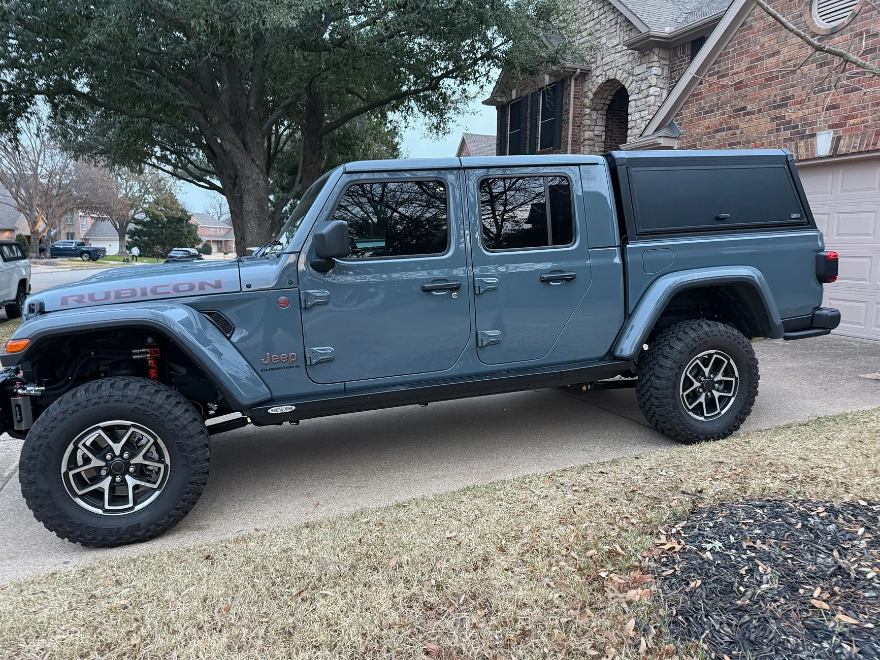

I agree with most of the advice given here. I recently did both 35's and a Clayton 2.5" Overland+ lift (which measures out to a bit over 3"). I did the lift first, then a few days later I had the wheels/tires done. What I can tell you is that the lift with stock tires looks a little silly. There was nothing functionally wrong with it other than clearance for the brake cable and speed sensor cable for the ABS and some very tight clearance with the remote reservoir on the shocks I chose, but it just looked a little silly with the 33s. Here are a couple of pics with lift and lift with 35s. The bed of the truck has a fair bit of weight in it in both picks so maybe a little sag in the back in both pics.
Lift with stock 33" MTs (all the old suspension parts in the bed of the truck)
Jeep Gladiator Lift or 35’s on Rubicon Lift-33s
Lift with Method 705s and 35" Baja Boss ATs (old wheels and tires in the bed of the truck)
Jeep Gladiator Lift or 35’s on Rubicon Lift-35s

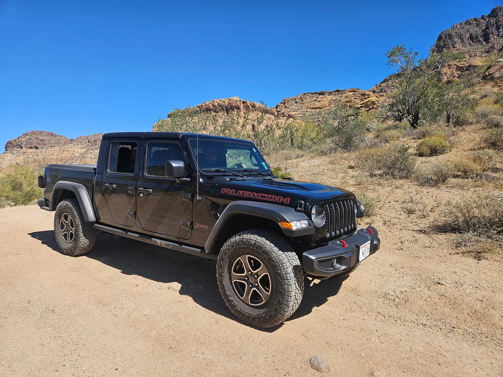

So I did go with wild peak A/T4W 35-11.5-17 on stock rims.
Out in Cave Creek AZ, first adventure was on four peaks trail that was nice and easy. Today was a lot more challenging on the Bulldog trail 10. After today’s outing liftkit in near future.
