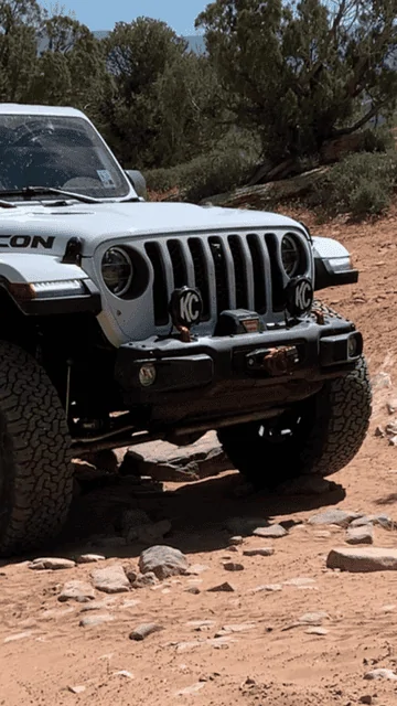

KC has amber and clear plastic covers to protect from road debris. They snap on just like the hard cover. I have to admit I don't use the lights nearly enough to justify their expense, the factory LED lights are legit.
Thanks for posting the picture, I was just starting to dig through your posts to look for one lol!
I imagine you just attached using bolts or holes in the modular steel bumper and not using any other sort of bracket?

I drilled factory bolt hole out a little bigger and they bolted right up
