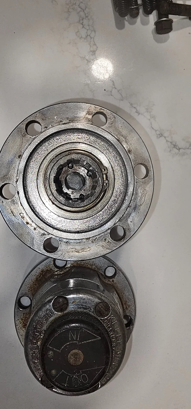

I pulled these from my C5. They are going on my Mahindra Roxor. Not really needed on the Roxor since it mostly hangs out on dirt and gravel.
