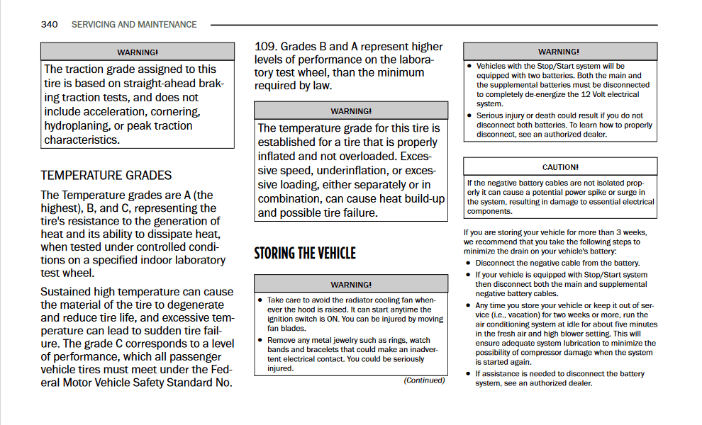

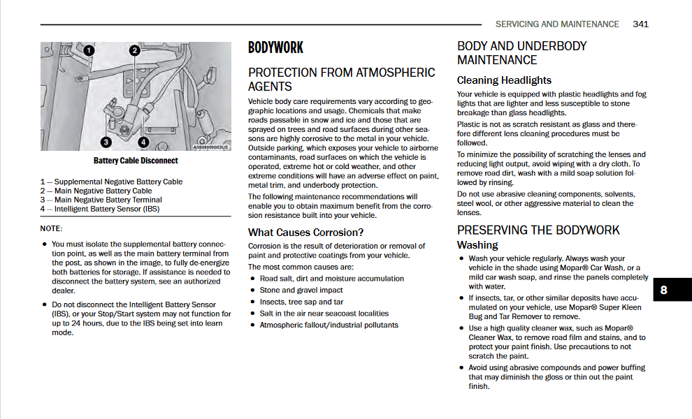

I will be out of town for about 3-4 months. What is the best way to put my JT to sleep without using a battery maintainer. The JT will be parked in my garage. What do I need to disconnect so the batteries won't run down?
thank in advance for everyone's help
It is interesting what can be found in your Owners Manual. For example, there is a section entitled "Storing the Vehicle":
Jeep Gladiator Long term storage 1699740004502
Jeep Gladiator Long term storage 1699740037175
I guess I should read every now and then! Thanks Jeff, I'll check it out.
