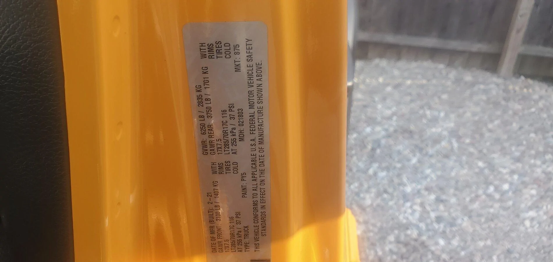

That there MAY be an issue, depending on where he is. Enforcement varies from state to state. They may look at the door label and the label on the trailer. They may put them on a scale at the port of entry. They may not even care.
The tow rating isn't on the door. Just the axle ratings and GVWR, and payload
