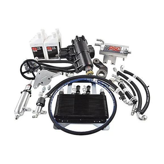

Is this the kit? PSC Motorsports Big Bore XD Overlander Steering Kit for 18-20 Jeep Wrangler JL with 3.6L Starting at $2,334.00
My Jeep likes my money
Jeep Gladiator Loose Steering? psc-motorsports-sk500-sk501-overlander-big-bore-xj-steering-box-pump-kit-jeep-wrangler-jl
psc-motorsports-sk500-sk501-overlander-big-bore-xj-steering-box-pump-kit-jeep-wrangler-jl.webp
Yes BUT the JT kit is not out yet. Apparently there are some differences in the motor mounting that makes the JL kit not fit the JT at this time. That's what I HEARD and not straight from PSC, just from my local Jeep shop. But yes that is the kit they put on the JL.
