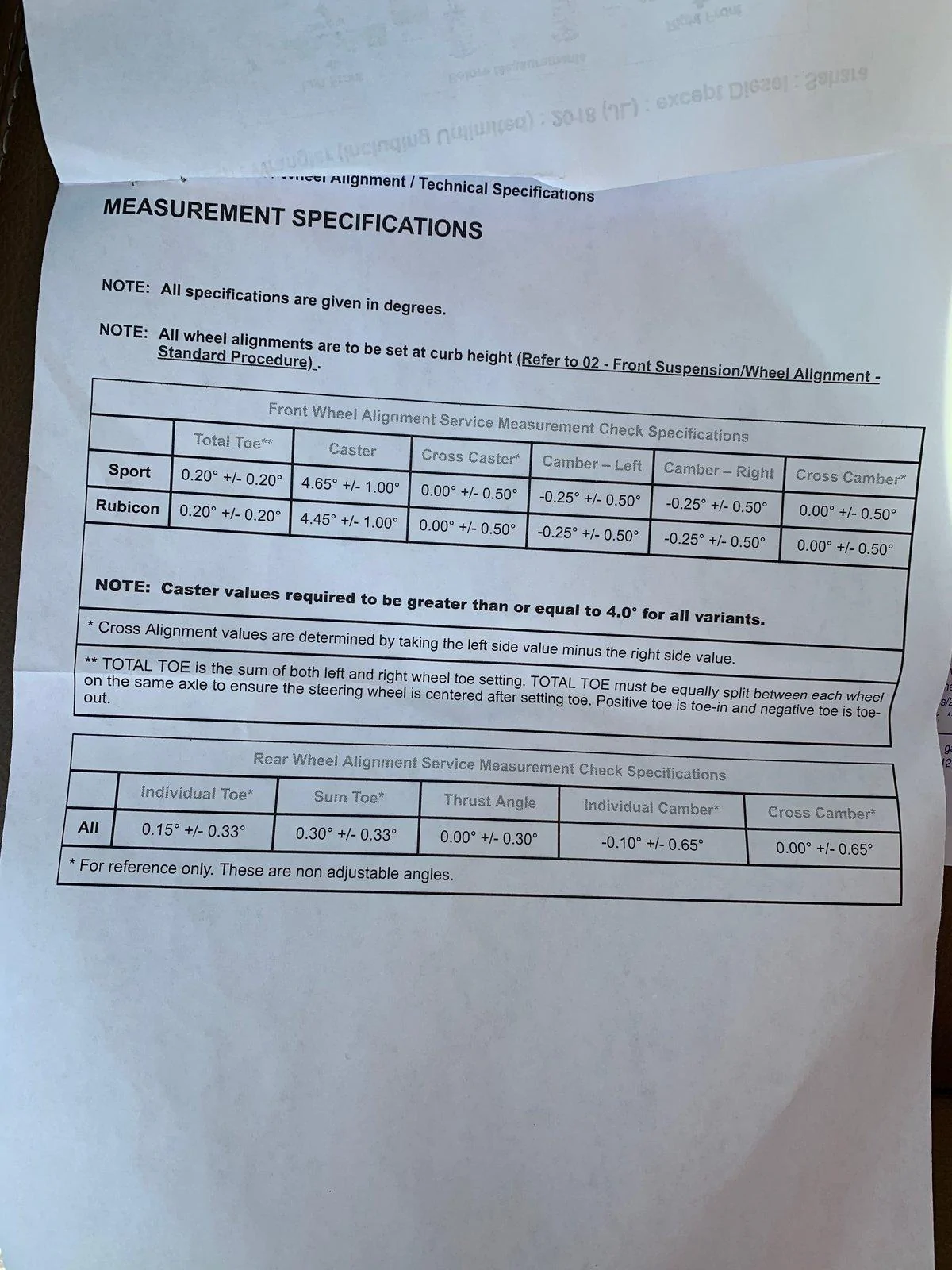

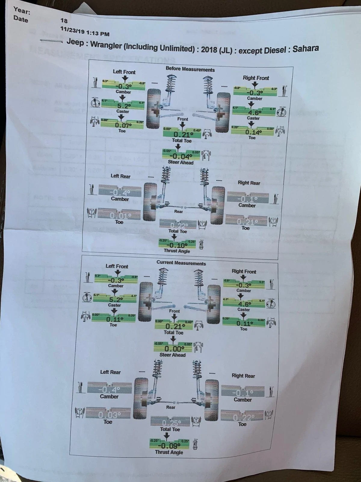

I actually heard about the "no official spec" thing from 2 separate dealers. Several 3rd party shops also would not check the alignment because they had no specs.
Sure looks to me like they are using 2018 Wrangler JL Sahara specs from the sheet I got. Also, doesn't the supplement indicate there should not be as large of a difference as there appears to be between front left and right camber? (5.2-4.6 = 0.6 and cross camber is 0 +/- 0.5). Can't believe I didn't catch that.

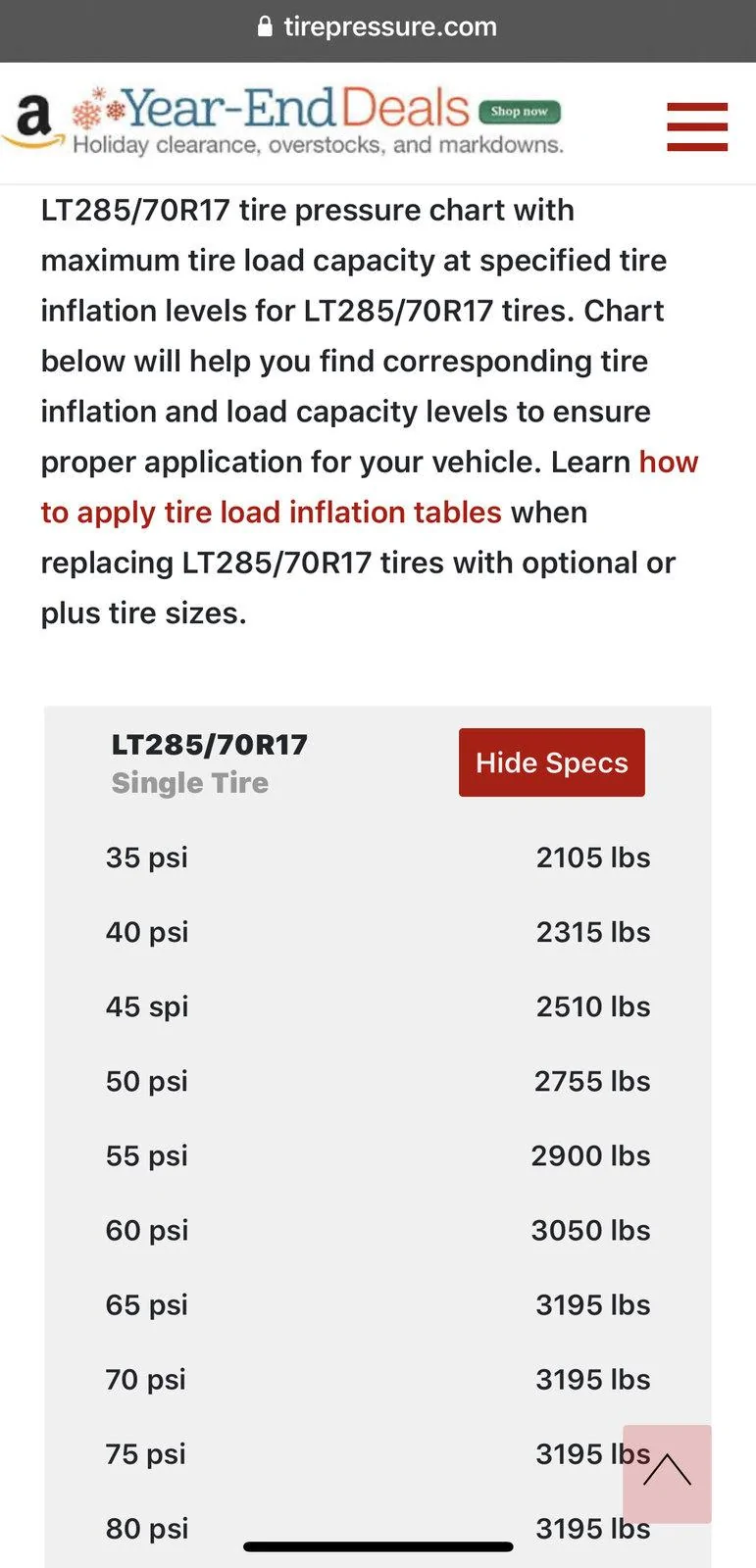

Personally I'm a fan of the chalk or other similar measurement test. Generally the best way to run a tire is with a full contact patch as it was designed. The site above actually has a good graphic https://tirepressure.com/causes-dangers-and-effects-of-underinflated-tires that is generally what I'm looking for with aftermarket tires especially of a size that isn't spec'd for the vehicle.
Tires and tire load ratings are meant to carry weight. Changing things on your rig changes weight. Generally the manufacturer is going to adjust things based on the highest payload possible....makes sense right? But how many of us drive with 1k lbs in the bed of our truck? But Jeep is going to give you tire pressures that are accurate at full load. Because the worst thing a tire 5lbs over inflated is going to do..is just wear down the center of your tire faster and ride like crap. On the contrary under-inflated tires carrying a full load as suggested above will heat up the tire more than intended, wear down the edges of the tire faster and attribute to poor handling characteristics as the sidewall flexes more under load.

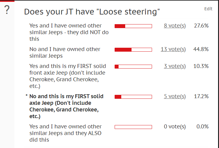

This of course is not scientific as it includes only forum members, and only a tiny portion of forum members have responded/voted, obviously by the numbers, but so far............ of those voting 8 said yes to loose steering but their OTHER similar Jeeps did not do this.
So it's plain that it's not newbies "whining" or "complaining".......... they have owned others to compare to.
A total of 18 said no problem, 8 have the problem but not with other Jeeps, 3 have the problem and this is their first solid axle Jeep.
Even at 27% those are not good percentages. I took mine to dealership and they flat out ignored everything I told them. Kept it overnight, told me they test drove it (which I think is a blatant lie), told me they could not flash the steering control module to amuse me with out fca permission, etc etc. Im not truly surprised as I live in Southern California and this place is truly a circus. But as Ive stated before I also have a jeep jk, and a Dodge eco diesel (which is under law suit), so in the last 5 years I have spent 150,000 with fca and they simply can't work with me, or attempt to find the problem, or at least act interested. My vehicle is bone stock. Im lifting it this week, and Im going to add the synergy stuff to it, but it really really annoys me that a $60,000 vehicle does not drive what I feel to be safe. And Im really tired of hearing the non sense of its a "jeep". Bullshit.
