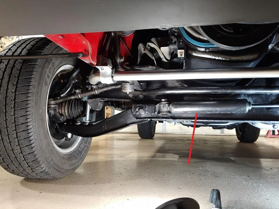

Anyway, we will get to the bottom of this situation. Do all JTs come stock with a steering stabilizer?
Yeah. That's been touched upon, too.........
Not sure but I believe Jeeps started getting them about the time AMC started putting them on the Eagle in the 80s.
Or maybe Jeep had them first and the Eagle got it as well......... every 4x4 I've had has had such a thing.
