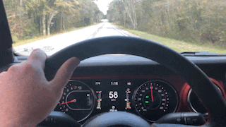

A video I made of my steering on a drive today. Looks like crappy quality converting it to a gif, but a decent amount of play I’d say
Jeep Gladiator Loose Steering? 910B4B64-6D88-48C6-B252-4E7CFC55B957
