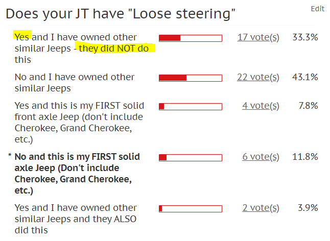

As I've said in other threads here for some time - if it was normal, then even people who have owned other similar Jeeps - Wrangler, for example, or all others who own JT would be talking about similar. Mine is true and straight and no need to move the steering wheel beyond a normal amount to keep it straight. Mine is very similar to steering my Chevy and it had SLA IFS (Short Long Arm Independent Front Suspension - like a car in other words)
If it was normal, then the numbers in this poll should surely be a lot different, is that not correct?
17 people say their JT has loose steering and yet those 17 say their other Jeeps did not.
Only 2 say their other Jeeps did as well - but for that small number, it's possible they don't "get" or understand what others are REALLY seeing and feeling.
Mine is so good I never once thought it had any steering issues at all - and yet people who have had other similar Jeep vehicles state theirs is a problem child.
Logic would say - there's a problem - MAYBE, just MAYBE, more than one. Perhaps simple changes or adjustments can resolve it. Do the dealers "think outside of the box" at all or are they lost after hitting the end of their laminated point card? (there is no box - so that saying is stupid - logical thinking, professional troubleshooting, that's what is needed but too many techs today don't say well if this is on the high side of spec and that's on the low side of spec, it can be a problem even if BOTH measurements are IN factory specs.)
Example - camber and caster, among other things, like tire pressure, can influence a pull to one side. Gee, camber is in specs, caster is in specs and the tires are in specs, no problem. What if both caster and camber are on the side of the spec that could cause a pull to the left and hey, that tire is 2 pounds lower in pressure - DUH. That thing will pull to the left - even though all is in specs. It's called a stack-up of tolerances. It can mean a new engine has the limit of clearance and won't last as long as the next one that has a crankshaft at the top of spec and a bearing at the small side, a tight engine compared to another.
There is no "box" to think outside of, it's a made up artificial thing used as an excuse to not think using experience, perceptually.
(yeah, I know you can't really change caster, etc. on these - but there's still a spec as there can be manufacturing differences or damage or wear - I was just making a generic point)
