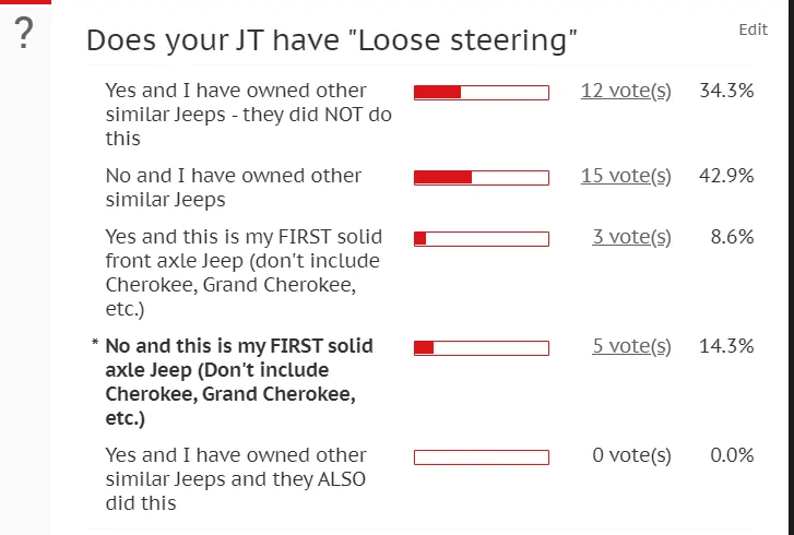

LOL - for navigating TIGHT spaces I want that steering to respond NOW, not 2 inches from now.
I've had to put vehicles and trailers into awfully tight places over my life and tight steering that responds but doesn't over-respond is necessary for navigating. If you are on rocky, uneven ground and the vehicle wants to charge to the left and is headed toward a ledge, how does having to take out 2" of play before it responds help you? Wow, sales people should have a mandatory class in off-roading before they can sell anything. If I'm on the edge of slipping or making it over a rock, I want instant response, I don't want IT to think about it before responding to my wheel movement.
Here's my poll as of today - should tell them something........
Jeep Gladiator Loose Steering? poll2

Polling is clear - there are too many ‘loose’ JTs and far too many stupid sales people!
