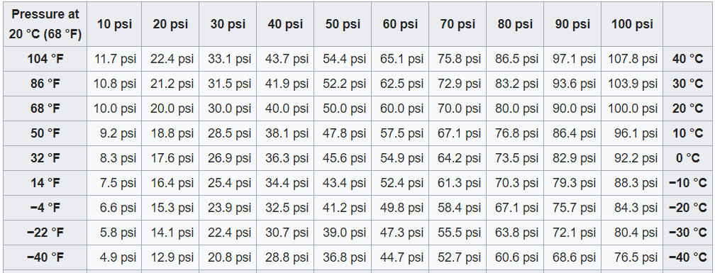

Quotes from tire manufacturers, TRA and other sources -
Quote -
Cold Inflation Pressure
According to an association of tire manufacturers, "the cold inflation pressure is “taken with the tires at the prevailing atmospheric
temperatures and do not include any inflation pressure build-up due to vehicle operation.”
In short, tires should be checked when they are cold; that is after the vehicle has been parked for at
least three hours or driven less than one mile. It is easiest to check your inflation pressure in the
morning, after the car has been parked overnight." (this is their agreed upon standard)
QUOTE -
Replacement Tire
4. Use the appropriate load inflation table for the replacement tire size(s).
5. Find the inflation pressure to which the corresponding load is equal to or greater than the
OE tire.
6. Inflate tires to the appropriate inflation pressure.
7. If the replacement tire requires a different inflation pressure than OE, the installer should
inform the owner of the new required inflation pressure and should also place a sticker or
decal over the vehicle tire placard showing the new tire size and recommended inflation
pressure for future reference.
Some vehicles are originally equipped with a staggered fitment in which the front and rear tire
sizes may vary and/or may have a different front and rear recommended inflation pressure.
Always maintain any differences in inflation pressures front to rear that are shown on the vehicle
placard.
Warning! Never use an inflation pressure lower than what is recommended by the vehicle
manufacturer.
Quote -
For every 10 degrees of temperature drop, tires will drop 1-2 pounds of pressure. It is important to keep your tires within the recommended PSI to maintain traction, handling and durability.
Just as colder weather can cause PSI to drop, excessive heat can cause your tire pressure to temporarily increase. For every 10 degrees of increased temperature, your tires can be expected to increase by 1-2 pounds of pressure.
From Bridgestone -
If it is necessary to adjust inflation pressure when tires are “hot”, set their pressure to 4 psi (14 kPa) above the recommended cold inflation pressure. Recheck the inflation pressure when the tires are cold.
My comment - The below is approximations only because there may be a large difference in the VOLUME of air in a given tire compared to another. For example, the Bridgestone Dueller H/T 255/70R18 tires on the stock Overland compared to the Toyo LT305/70R17, the latter being a larger tire in width and height as well as the rim being smaller meaning taller sidewalls.
Jeep Gladiator Loose Steering? tire-pressure-tem-chart
